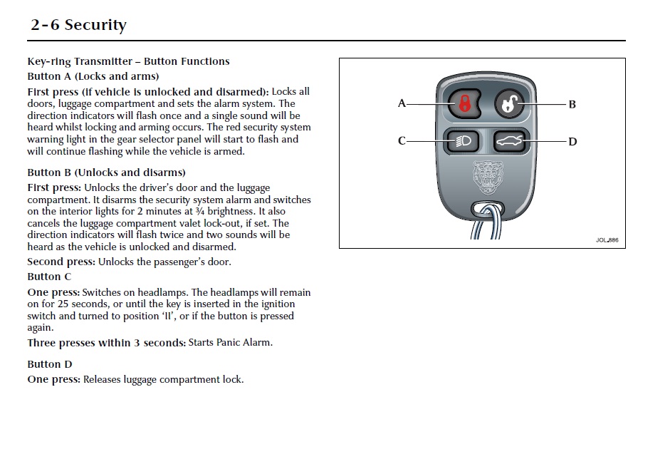

Miguel, here are two pages from the owners manual... More accurate than I have described.
Attached Thumbnails XK8 Key Fob question-keyfob.jpg   XK8 Key Fob question-keyfob2.jpg
