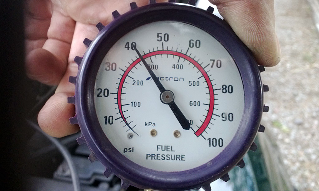

I have finally received the Innova 3100 scanner earlier today (est. on Fri, delivered on Mon =D). Please, take a look at the screenshot with codes below (P0335 - Crankshaft Position Sensor A Circuit). I am also attaching my fuel pressure reading and sparkplug condition pics. Considering the code id being crankshaft sensor, my state of "worried" is currently on code red. .

All that being said, is it possible for a crankshaft sensor to go bad? I should probably mention that my dash shows restricted performance warning and I get no cranking at all when attempting to start. This condition arose during my weekend check up on fuses/wires/connectors...
