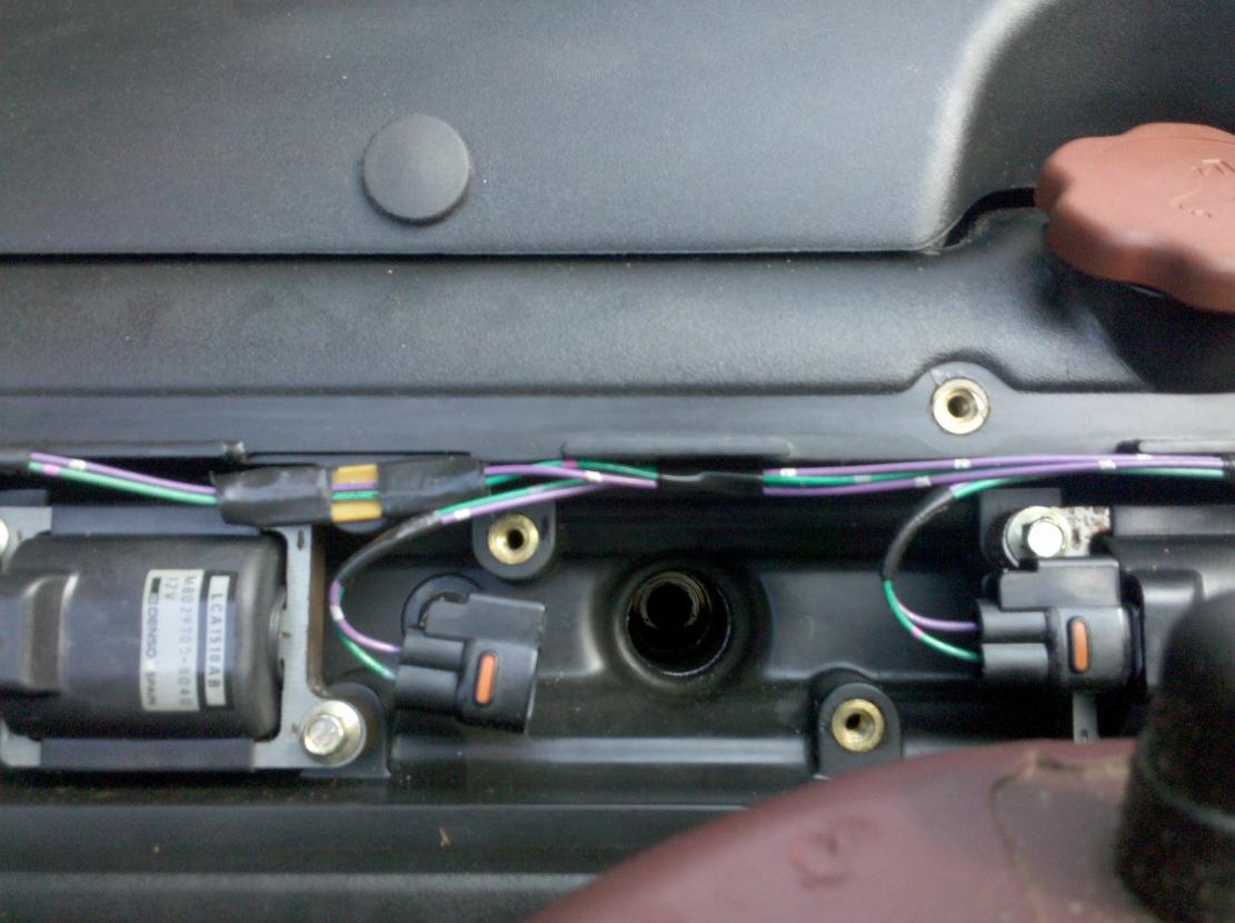

Just put a new set of Bosch Platinum +4 plugs into my XK8. The dealer wanted $350 to change the plugs (installing NGKs) but for $51 bucks this got me a longer lasting plug and saved me money on labor. This was not a difficult job, for anyone wondering about removing the coil packs, etc.
The only slightly difficult part is removing the rearward screws on the driver side coil pack cover. The lower rear screw is hard to get at and if you are not careful you can break the fragile (plastic? fiberglass?) coil pack cover, as I did without much effort. The good part is that it is easily fixed with some epoxy.
One thing is the oil in the plug well. This I suspect was leakage over time from the valve cover gasket. There was not much oil in each plug well as you can see from the photo. I think the only way to fix this is to swap out the valve cover gasket, which I did not think was necessary given the absence of other leaks or obvious signs of trouble (no oil consumption, etc.)
Any thoughts on this? Thanks.

I dunno Burg, that plug looks nasty fouled, and extremely eaten up (look at that gap!). I'd change the valve cover gasket on that side, last thing you need is a future misfire, a coil going bad, then forced to do the gasket later. Leaks don't get better over time unfortunately.

I agree. The XK8 I just got was leaking oil bad enough that the plugs on that side of the engine were submerged in oil, and I think that was the root cause of the engine not starting.

I think you're both right, the gaskets should be swapped. I'm beginning to wonder what the material looks like around each plug well - must be pretty thin even when new.
The plug didn't look crazy worn out to me, at least not compared to others I've pulled out in years past. I did not have a new NGK to compare it to, though. Hopefully the Bosh Platinums will outlast the last ones. No idea why the ******* thinks the NGKs are better but to each his own.
