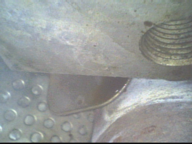

Its defo leaking from the cam cover but i dont know how. When i remove it AGAIN can i use sealant or not? The first picture shows the drip from under the cover and the second shows the heat sheild and white exhaust where its dripping onto

A hairline crack in the cam cover moulding is more likely than a crack in the head casting joint face.
The problem with hairline cracks resulting from uneven or over tightening plastic cam covers is they are almost impossible to see with the cover removed.

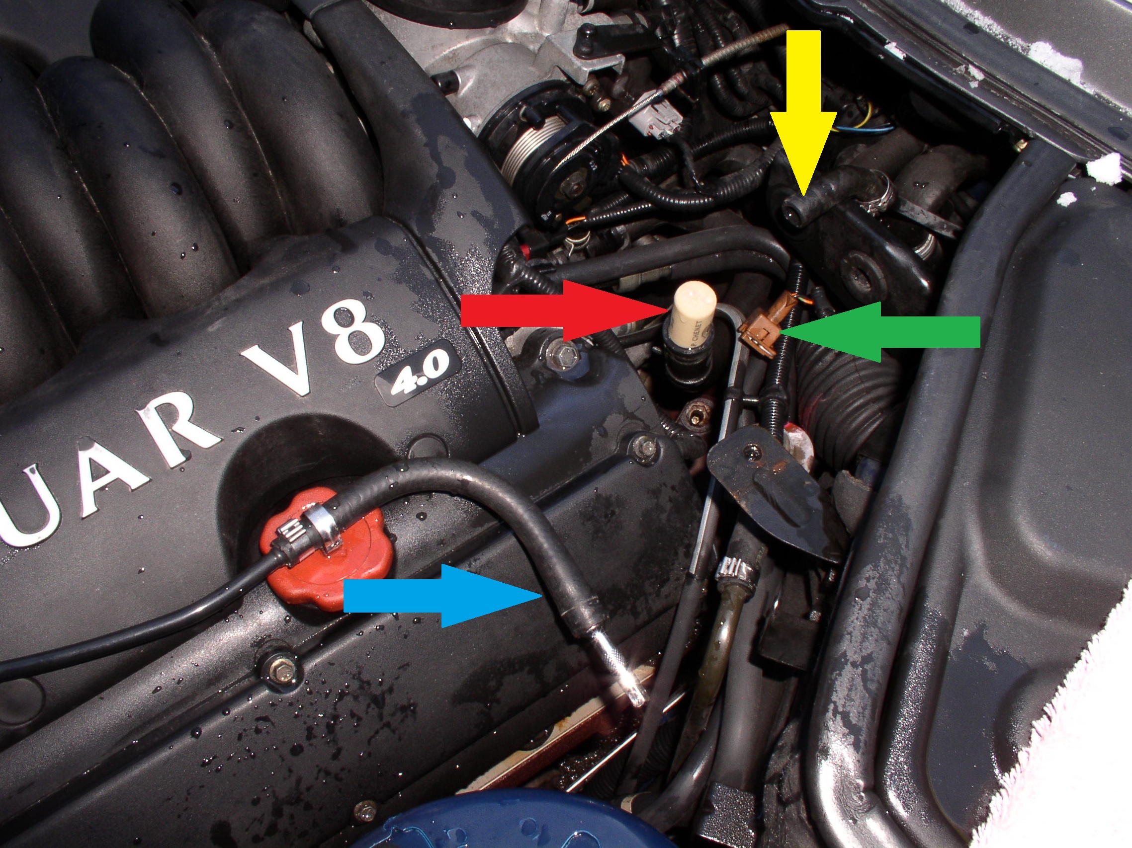

Attachment 94211
The pipe to the Atmospheric Recovery Bottle (arrowed in yellow) doesn't need plugging.
The harness lead to the Low Coolant Sensor (arrowed in green) is the only other item to be disconnected.
Dear Graham. Your photo with the green arrow is wonderful. I have a 2001 XKR. My connector (your green arrow) is floating, not attached to anything.
A new Expansion Tank comes complete with a Low Coolant Sensor and a Pressure Cap.
Dear Graham. Referencing your photo and the green arrow. My 2001 XKR has the same connector (brown) with the same wires (OG and N/S)? My connector is not attached to anything. I assume is needs to attach to the Coolant sensor, but I have not been able to find the sensor or where it screws in. Can you help?
