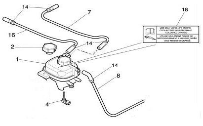

The sensor is a simple reed switch (I think) which is operated by a sort-of floating magnet inside the expansion tank - in other words - the sensor is a separate part and just pushes up into a moulded tube in the base of the expansion tank. If you buy a new tank, it comes with a sensor, but the sensor is available separately.
https://www.jaguarforums.com/forum/a...or-coolant.jpg
Item 4 in the diagram.
