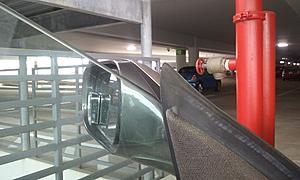

How do I convince my XK8 to automatically roll up the windows after closing the doors? It did it once, so I know it can do it.
Every time I pull the door handle, the window goes down a bit (by design). If I pull it once, the door still seals. If I accidentally pull it twice, the window stays open an bit, I have to put the key in the ignition, roll up the window and start over.
I am sure there must be a way to reset this smart window logic (like a sunroof that doesn't close).
