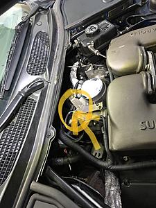

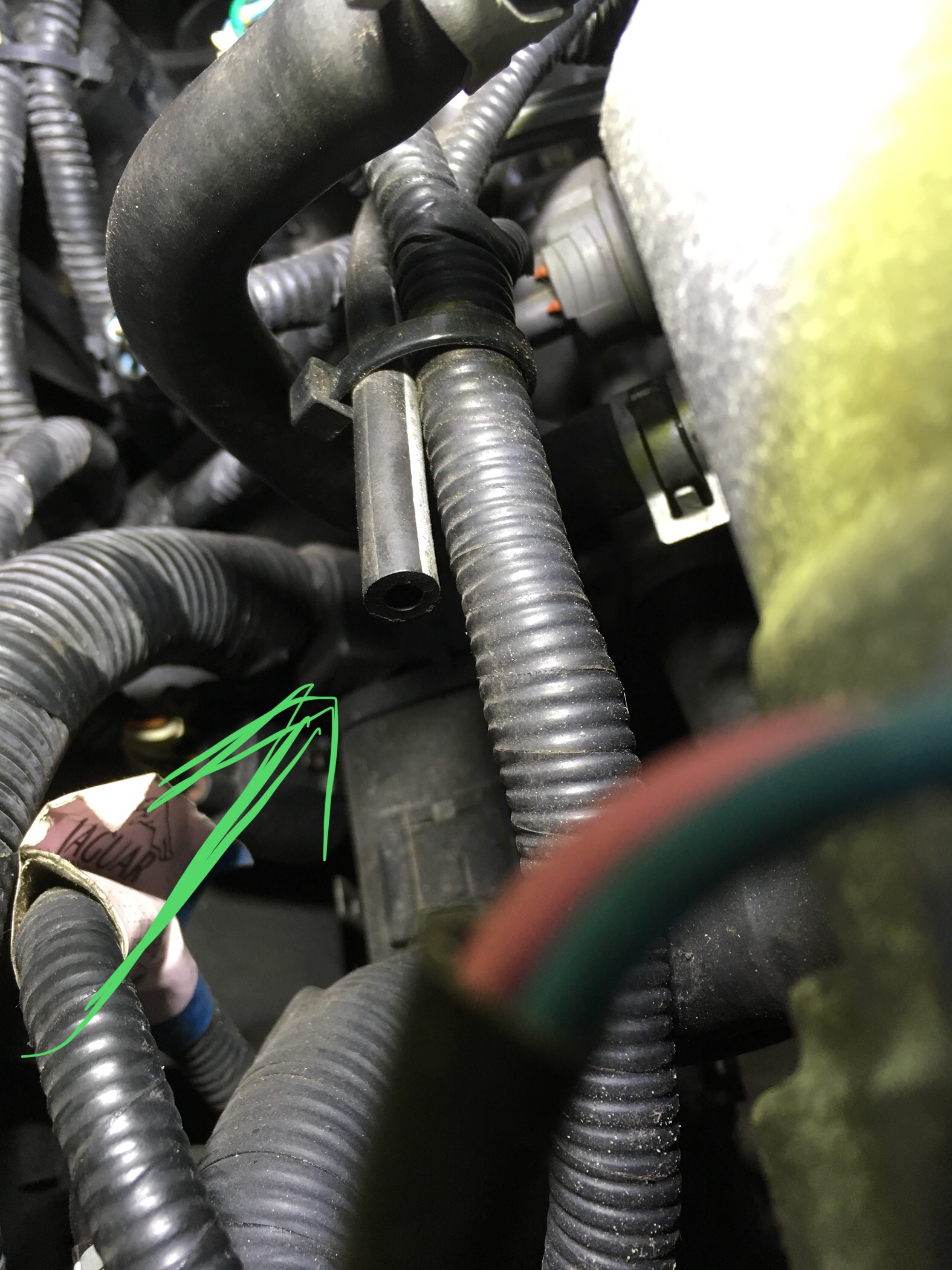

i checked under the bonnet again only to find a small hose sucking air. it comes out of the supercharger and doesn’t connect to anything! I took a few photos of it just in case.
I tried to find where it should go with no luck. I noticed that it is one of two bifuricating from a Hose coming out from the back of the supercharger and right in front of the throttle body.
I let the car cool down and stuffed the hose with a screw (following the advice of the car mechanic).
It drove normally at first, then when it warmed up it started with the rough idle, stalling and the RP message came up again. I couldn’t read the codes as the message disappeared after a few minutes.
im planing on changing the fuel filter in the upcoming days, as I noticed that it hasn’t been changed in a long time, but i don’t believe it could trigger all these problem.
i’d very much appreciate your help for options for why it’s acting like this and for the hose that doesn’t go anywhere!

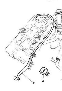

P0300 random misfire and P1316 are related. I've attached some snips from the DTC guide, courtesy of Gus' brilliant reference website:
http://www.jagrepair.com/DTCforms/aj2799.pdf. (3)
and from JEPC which should help you trace the hoses - 1 is air assist, 2 is the part-load breather.
Beware that the P1316 flags excess emissions, and possibly cat damage, so don't drive the car more than you have to until you get this sorted.
Deal with the air leak first, and you may find the other codes go away. Possibly someone has attempted to replace the part-load breather with fuel line? I doubt that the dealer would do so as he would much much prefer you to buy an OEM replacement
I cant give you proper guidance on this as my car is older and non-supercharged. The plumbing isn't identical, although I'm sure someone with better knowledge will chime in to steer you in the right direction.

do you happen to have the JEPC, as the links I found on the website seem to have been expired.
The diagrams where helpful but I don’t believe that the hose is on there.

The open hose is probably not related to the breather system. To me this looks like the connection to the superchargers bypass valve

i checked again for the other end of the hose with no luck. I couldn’t seem to find it in the workshop manual either! I did notice though, that the throttle body is the new one with the electric sensor on the side, which I find to be a bit strange for a99 model!
i do think that the hose should connect to the throttle body some how. Would that be logical?
