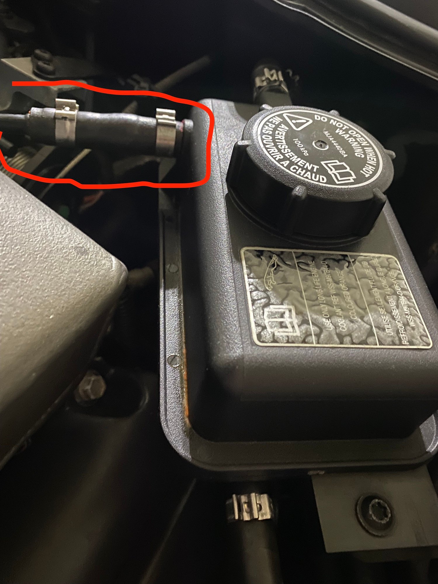

Hi all,
I am struggling to find the correct part number for this line (circled in red). Any help would be appreciated. Thanks!

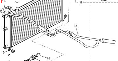

Here you go. From JEPC:

Thanks! How are you sure this is the correct one? Isn't there 3 bleed hoses on the reservoir?
mjb4582bb is one pictured, goes to front of motor. Mja4560db runs to spigot on LH side of radiator and another runs to the catchment tank down behind front RH wheel.

It's somewhat confusing as the R tank isn't actually pictured in JEPC. Also, the 3rd bleed hose at the front is in the 'radiator and pipes pump' section (18):

One follow up question that I am still not clear of. This hose looks to be snaked from the expansion tank through the supercharger area to the front of the motor/radiator? Where does it actually connect too?
Is this impossible to replace?
goes to intercooler radiator
