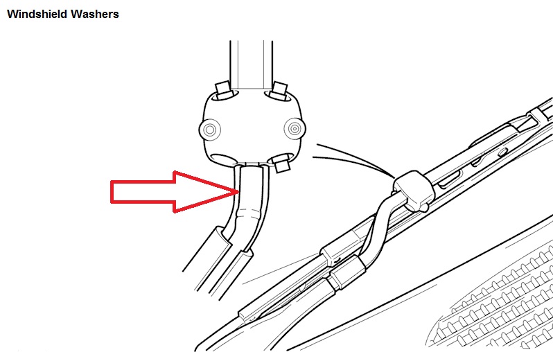

Also to check for blocked 'duck bill' washer jets, disconnect the feed pipe from the black plastic jet assembly (arrowed in red).
If the washer fluid flow is good from the end of the disconnected feed pipe, the jet assembly block or three silicone rubber 'duck bills' will be blocked. An aerosol of compressed air sold for computer cleaning is a useful aid to blowing these clear.
