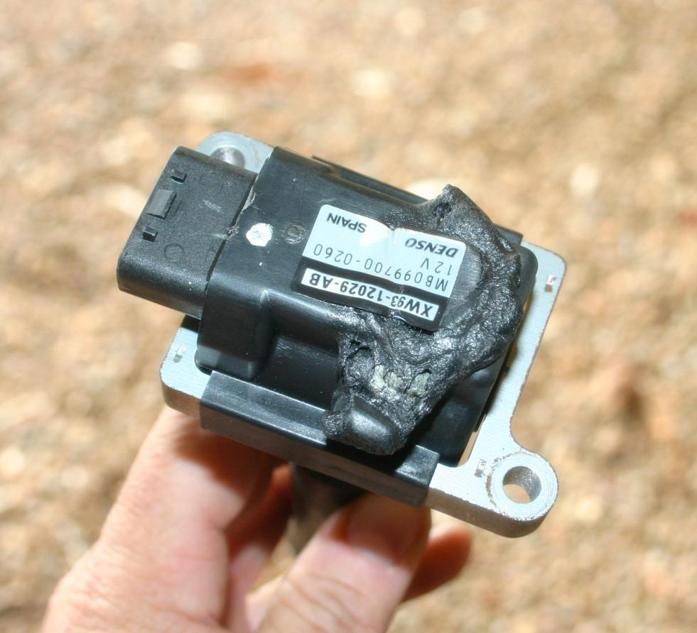

Hi, not sure if this info will be useful but I have an 02 XK8 which had the burning smell every time I gave it a decent blast. This is what I found to be the cause when I decided to change the spark plugs. XKR smell-m1.jpg
Old Aug 5, 2009 | 10:36 PM
JagtechOhio's Avatar
Posts: 2,521
Likes: 71
From: Powell, Ohio U.S.A. 43065
First one of those I have seen, thanks for sharing the photo.
