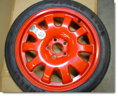

I just found this one on eBay. Spare Tire Wheel for 2001 - 2006 Jaguar XK #MXD6109AC | eBay
With shipping however, it's more than the one you found locally. It's a "best offer" , however, and it's been up on eBay since March 30th, possibly earlier. Perhaps you can make a lowball offer and get it cheap. The $97 shipping price seems really steep. I know it's heavy and bulky, but places like tirerack.com ship full size tires all the time and the shipping cost is nowhere near $100. I think it's closer to $25 per tire. The thing doesn't even have to be boxed up. You just slap a shipping label on it and it ships just like that.
That looks like the spare in my 2002 XKR.
Just be careful about getting a spare from a non XKR, make sure it will be big enough to clear the brakes!
Hmmm....well, slight monkey wrench...I don't know the size of this particular spare in the photo, but I believe it's the standard 18" XK/XKR rim. That's a bummer because I have 20" wheels...so I'm guessing that I need a different part, but I can't find the part number for the life of me.

And just to add to what Sam said earlier, the early cars with donut spares got a two level floor as well. I keep mine in the top spot so the floor is level all the way across.
Oh, and just because you have 20" wheels, doesn't mean you need a 20" donut. It just needs to be able to clear the brakes, which I'm guessing the 18" standard donut does just fine. You wont want to go to fast on a donut anyway (most say to stay under 55 mph)

I went and looked at my spare,it is an 18" and the original spare that came with my Silverstone and your 100. I've the twenty inch Detroits which came with the car. I would imagine that $350.00 probably isn't too high considering the prices of Jaguar parts, although it seems high to me, but it does have the Perelli on it and they do have ridiculous prices. also the tool kit including your jack ,wheel chock, towing eyelet is also missing I have seen these on E-Bay for $50.00 to $100.00 without the tow hook.
Dr No & Doug -
Thank you for checking your spares! Sounds like the 18" one would work for me. Dr No - it looks like you've got the BBS Montreals on your XKR, like mine. That's some GREAT info - thank you both!
