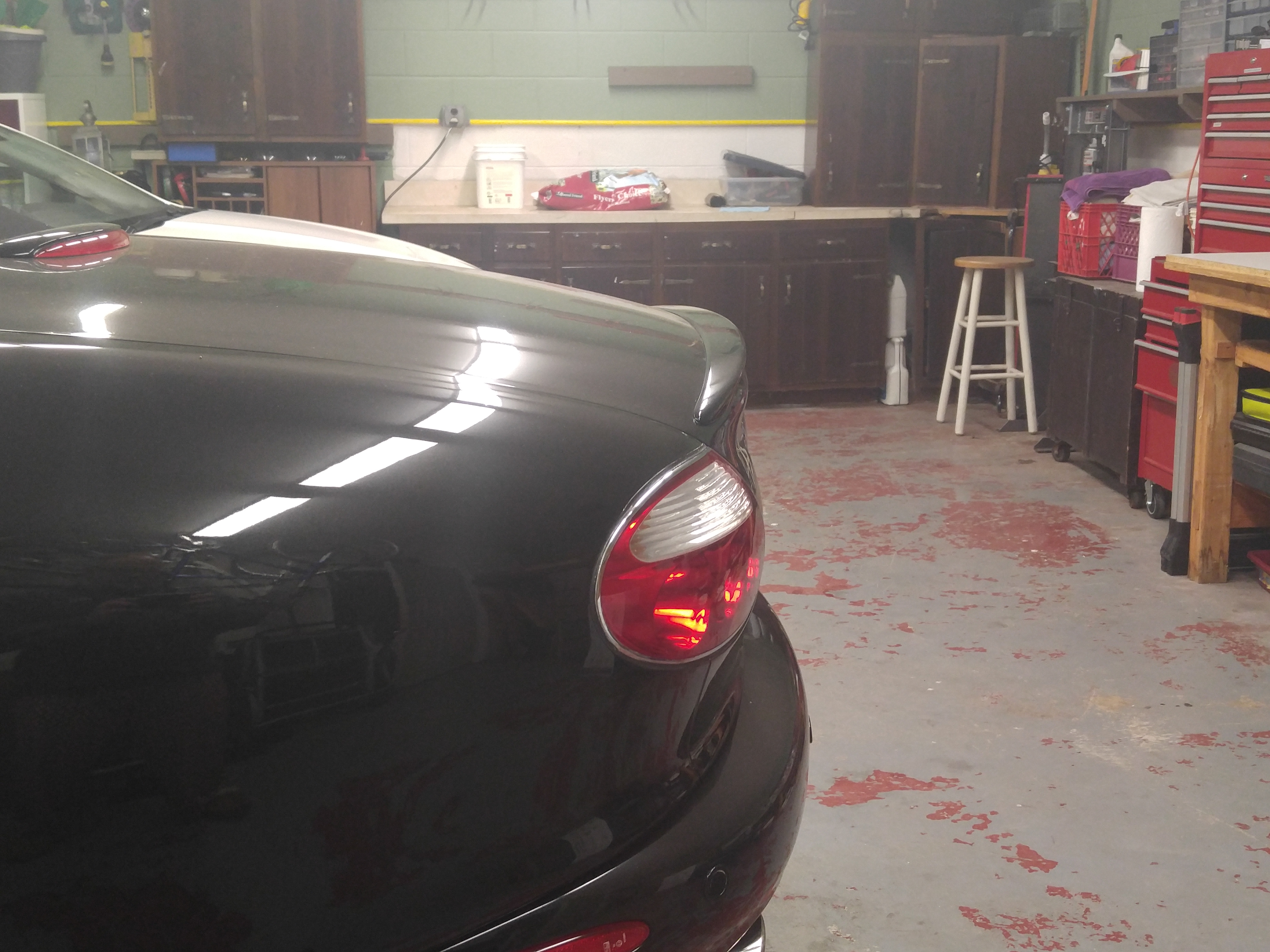

Excellent! Thanks! Can I bug you for one more thing? When looking at the side profile of the rear of the car, is the spoiler even with the back edge of the trunk - if you had a level vertically on the trunk would it touch the spoiler? Or is the spoiler up the trunk a little or does it hang over some?
A PICTURE of the side profile would be awesome

Here Ya Go (don't mind dust on car, it's up on Stands for winter maint :-)
Attached Thumbnails XKR spoiler measurement for a Convertible...-2015-12-12-05.44.16.jpg   XKR spoiler measurement for a Convertible...-2015-12-12-05.43.53.jpg
