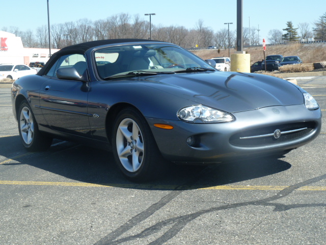

I removed the bumperettes, and installed a mesh grille and a strake from Mina Gallery. I also ran into the same issue with a badge on the bumper cover and one on the strake. I removed the one on the bumper cover, filled the holes with expoxy, bought some spray cans from Automotive Touch Up, and attempted to refinish the bumper cover myself. Ended up not looking so great, so I'm having it done professionally over the winter.
