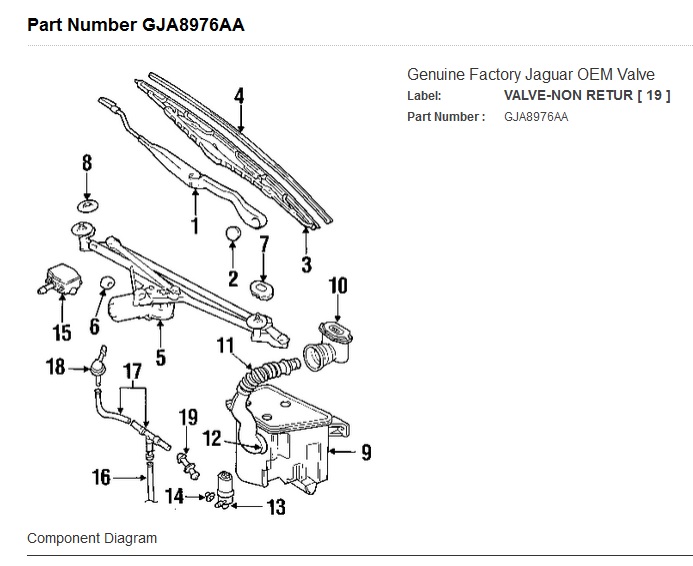

trying to locate exact location of gja8976aa non return valve on my 2002 car

Old Feb 21, 2015 | 07:02 PM
Likes: 17,006
Item 19 in the diagram:
