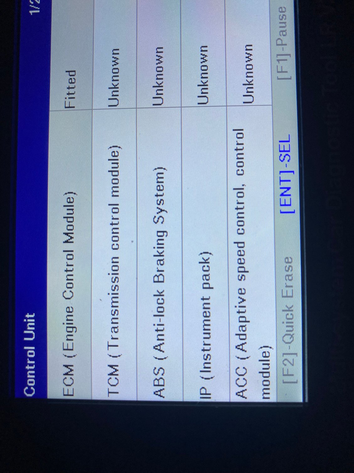

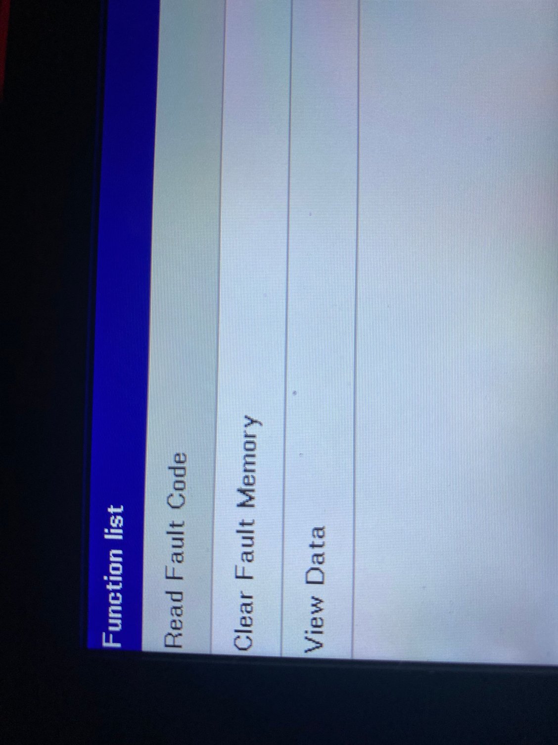

Bought the Icarsoft v2 and set up to read engine fault code - you may recall, my engine warning light came on after replacing rear subframe + front wishbones. Checked everything and nothing is obvious.
It reads other fault codes at the same time, so, reader is installed ok.

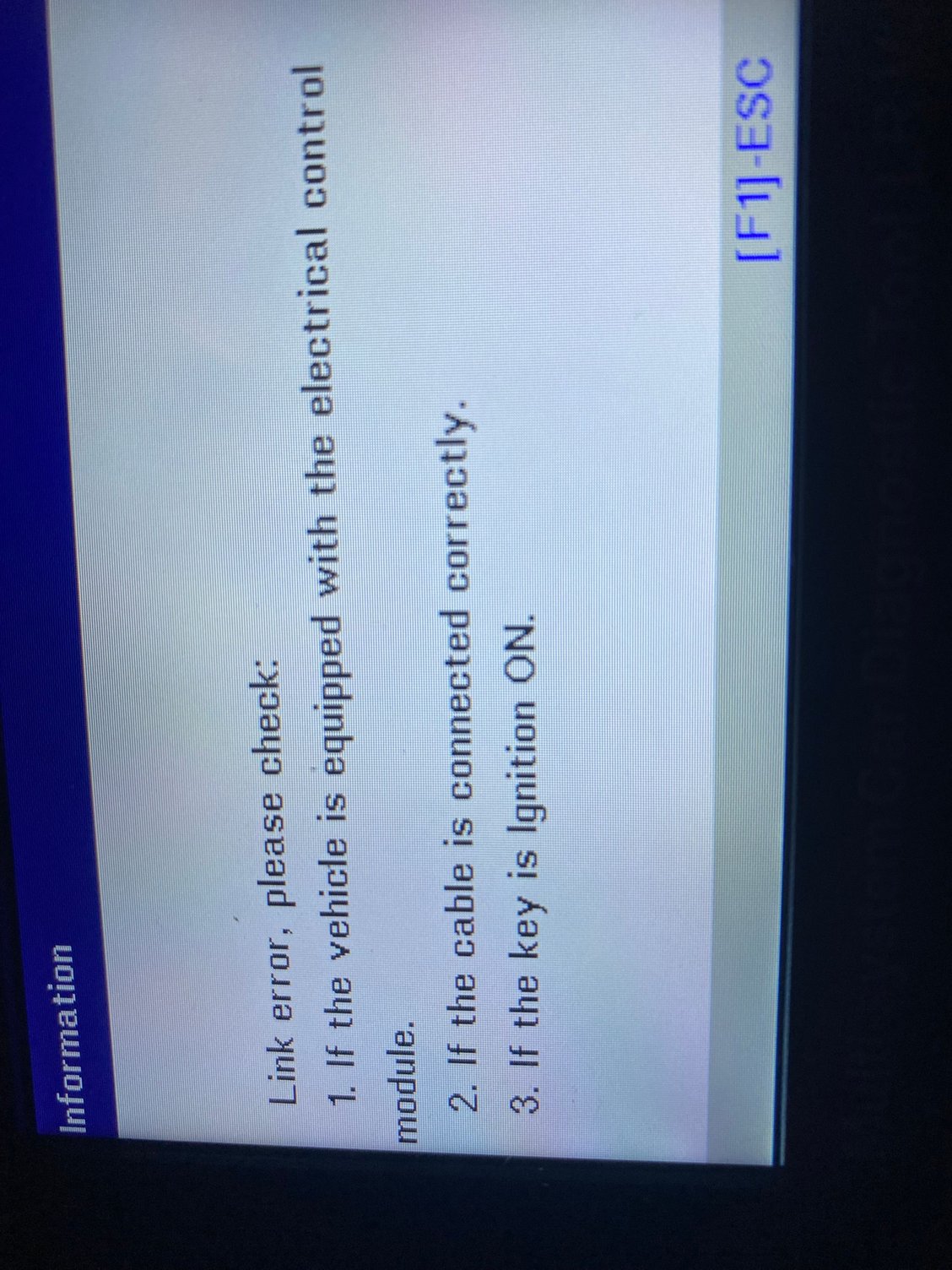

Any thoughts on why it says ‘fitted’ but isn’t communicating with ECM for diagnostic purposes? Thanks.
ECM won’t register with ignition on?
