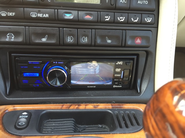

Had the OEM Premium Alpine with NAV in my 2003 XKR replaced.
I went with the JVC AV41-BT. I also replaced the retracting ariel with a hidden one in the trunk.
The head unit allowed for integration with TPMS and a Backup Camera. I think I need to drop my pressures a bit.

I retained steering wheel control. I'm not an audiophile by any stretch-- the install bypassed the oem amp and goes direct. It sounds fine to me. Or as my installer said-- "it sounds as expected" which I take as an overall "meh". However, BT streamed audio sounds way better than via the cassette adapter :-)
Sound wise, I'm happy. It's not the greatest head unit but was the only major brand that had the screen in 1 DIN. .
The dash kit is the 1997 1DIN xk8 surround with the Nexxis bezel. TPMS is Steelmate tp-05. Backup camera is a Boyo. Steering wheel controls are PAC. Antenna is Metra.

Quick update, radio reception was pretty bad. The powered antenna was actually behind the head unit, not trunk. We relocated it to the Right A-Pilar (hidden under the panel) and I'm all good. Just an FYI, if someone is looking for antenna location.
