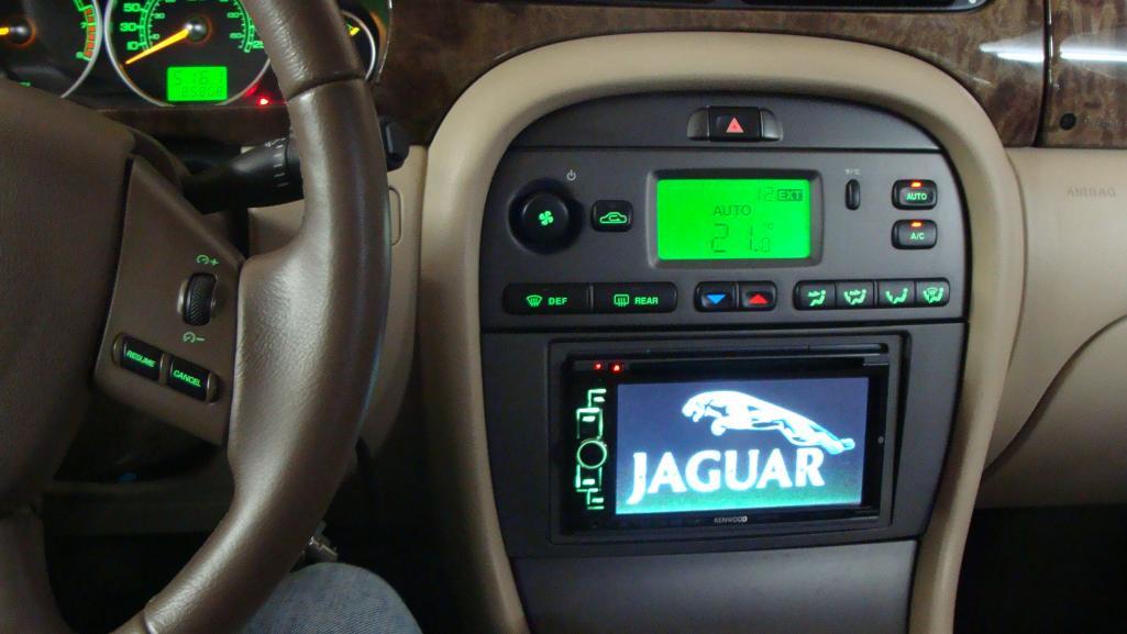

Here is a pic of the deck installed. Sorry the pic is on a bit of an angle...but you get the idea. And for some reason the deck image has a blue tinge to it...but in the car the green matches the green dash illumination colour. Works and looks great in my opinion...but now I have to upgrade my speakers - it's a vicious cycle. lol...

Nice, I guess the deck is level up and down and the dash isn't, it looks like you had to recess the top of the deck back 1/8 inch, looks nice though. I've got the premium so I have to do more checking on how it's going to hook up. I hear it's a bit of a nightmare. Nice car though.

The metra unit slopes back so that the unit is angled upwards a bit. I was really impressed with how well the Metra unit matched and fit.
I am also very happy that I decided not to undertake the installation myself as the wiring was quite complex.
