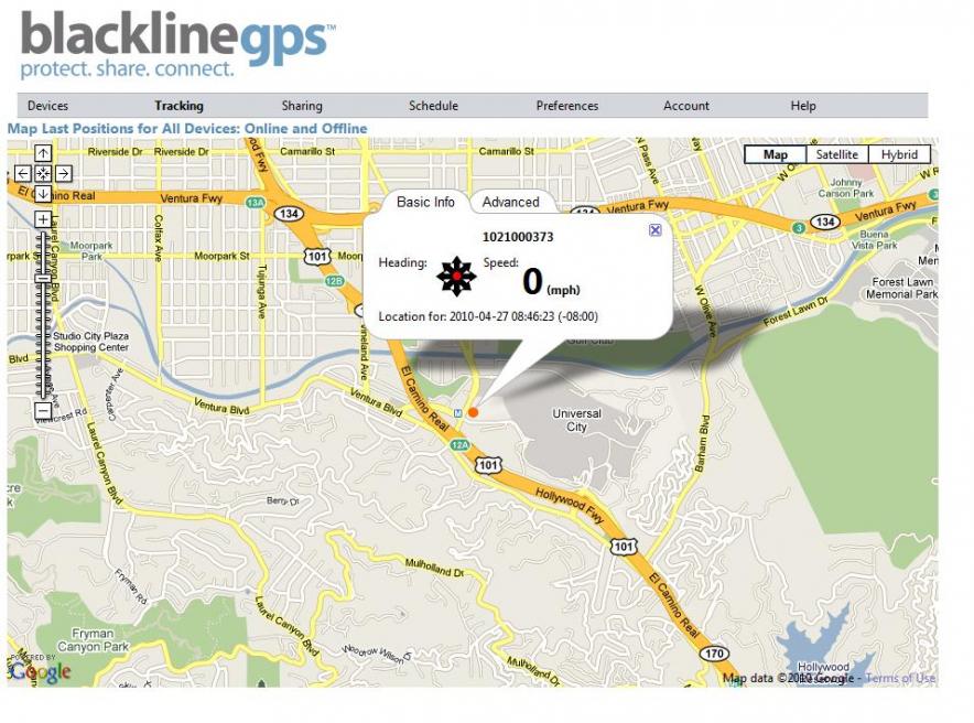

Answering a few PMs, this is what the web interface looks like.

does the advanced tab give you lat/lon by chance?

Yes, lat/long and altitude as well.
