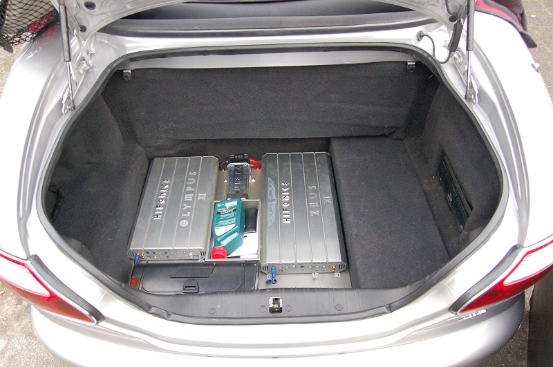

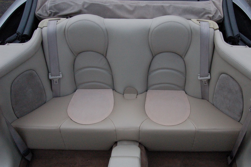

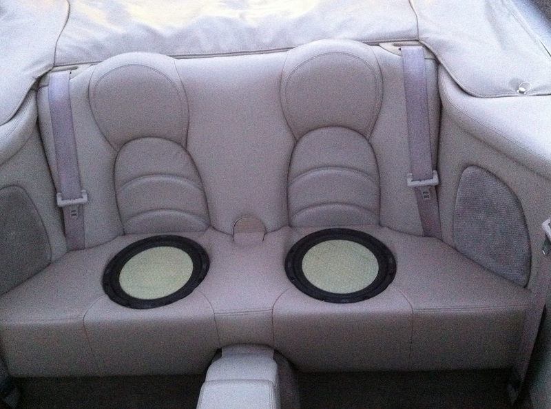

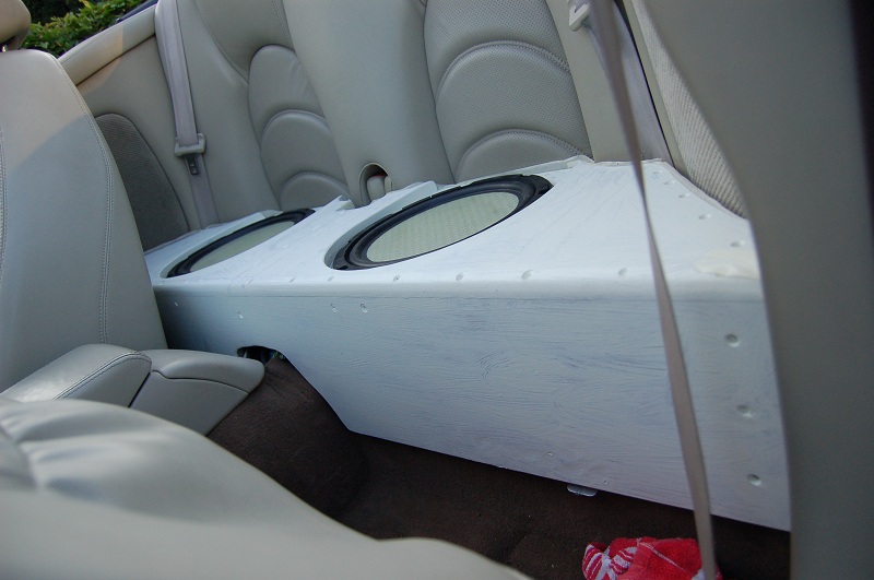

Default Mac Audio (ex. phase lineair) backseat
Well the sub in the trunk was replaced with this sweet setup.
Attached Thumbnails  Project Complete (pics) - XK8vert Rear Speakers n Sub-dsc_0433.jpg    Project Complete (pics) - XK8vert Rear Speakers n Sub-dsc_9130.jpg    Project Complete (pics) - XK8vert Rear Speakers n Sub-img_1132c.jpg    Project Complete (pics) - XK8vert Rear Speakers n Sub-zdsc_0439.jpg

Wow, I'd like to hear that system you've built, I really would! Nice job!
