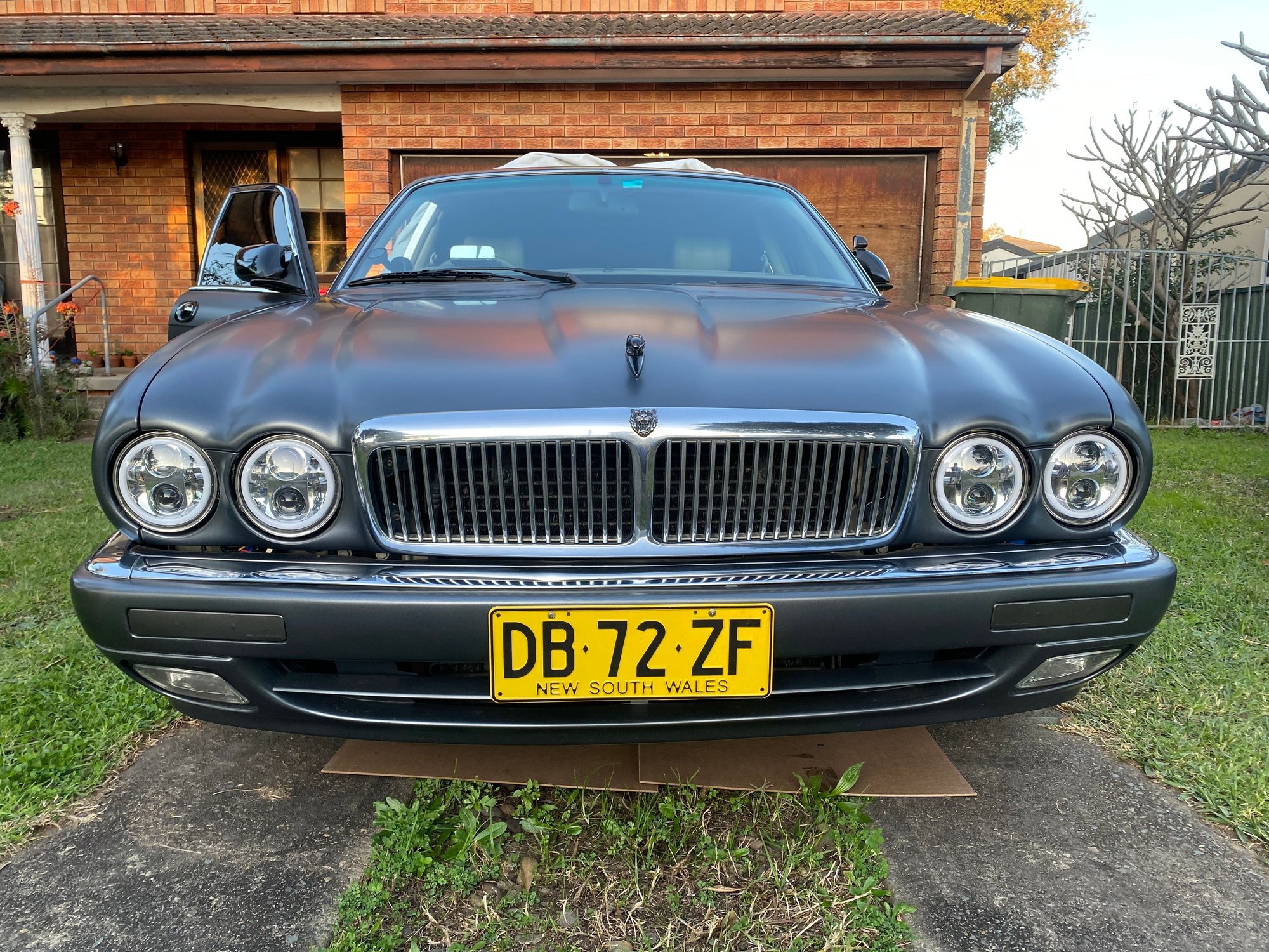

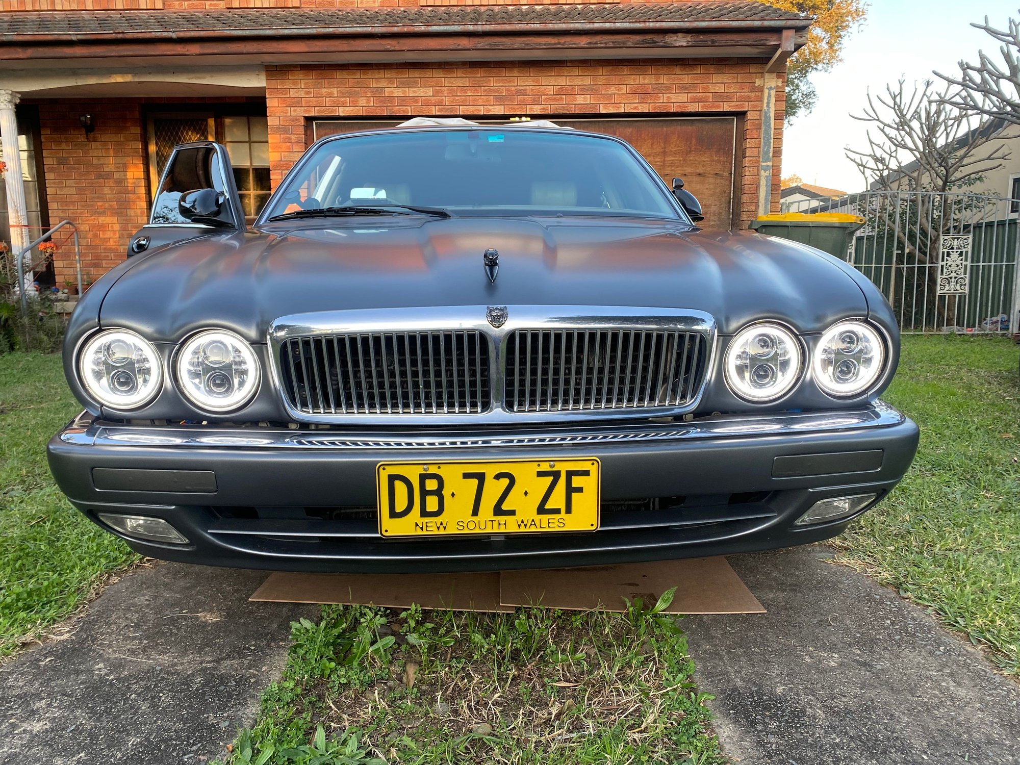

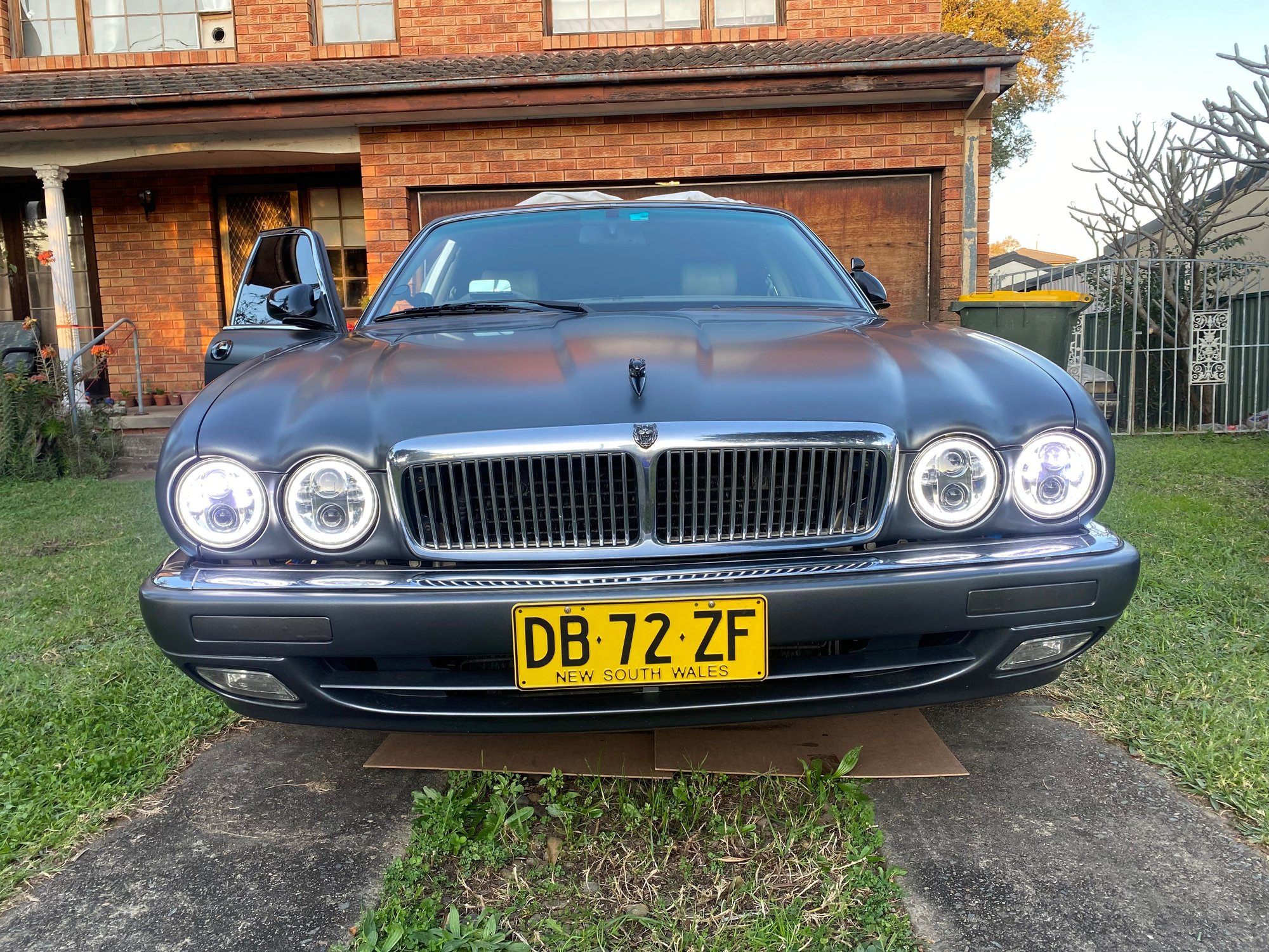

Took on a nice project of upgrading the long outdated x300 headlights to new LED units
used 2x 5 3/4” round LED units on each side.

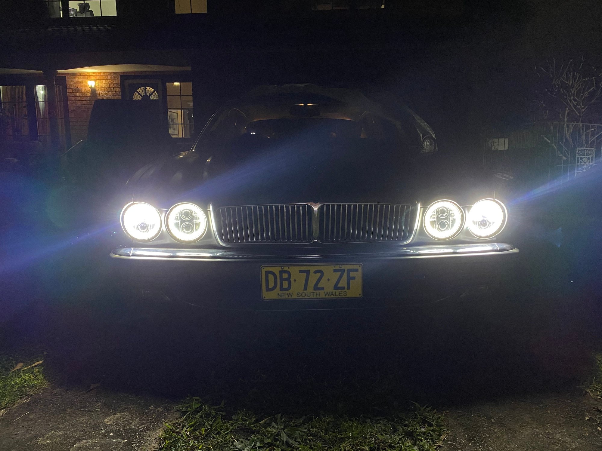

all have white led rings connected as park lights.

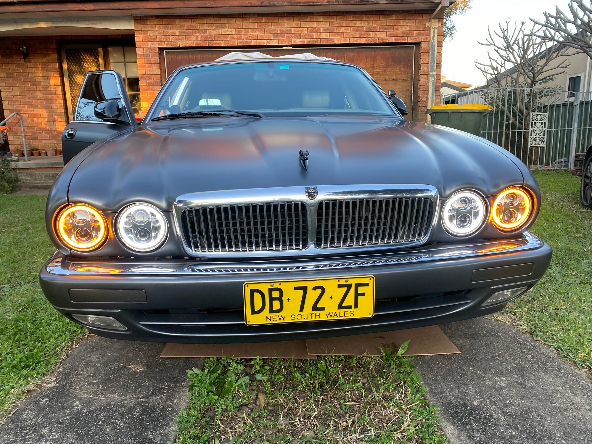

the outers also have the halo rings connected as switchback oranges for indicators.

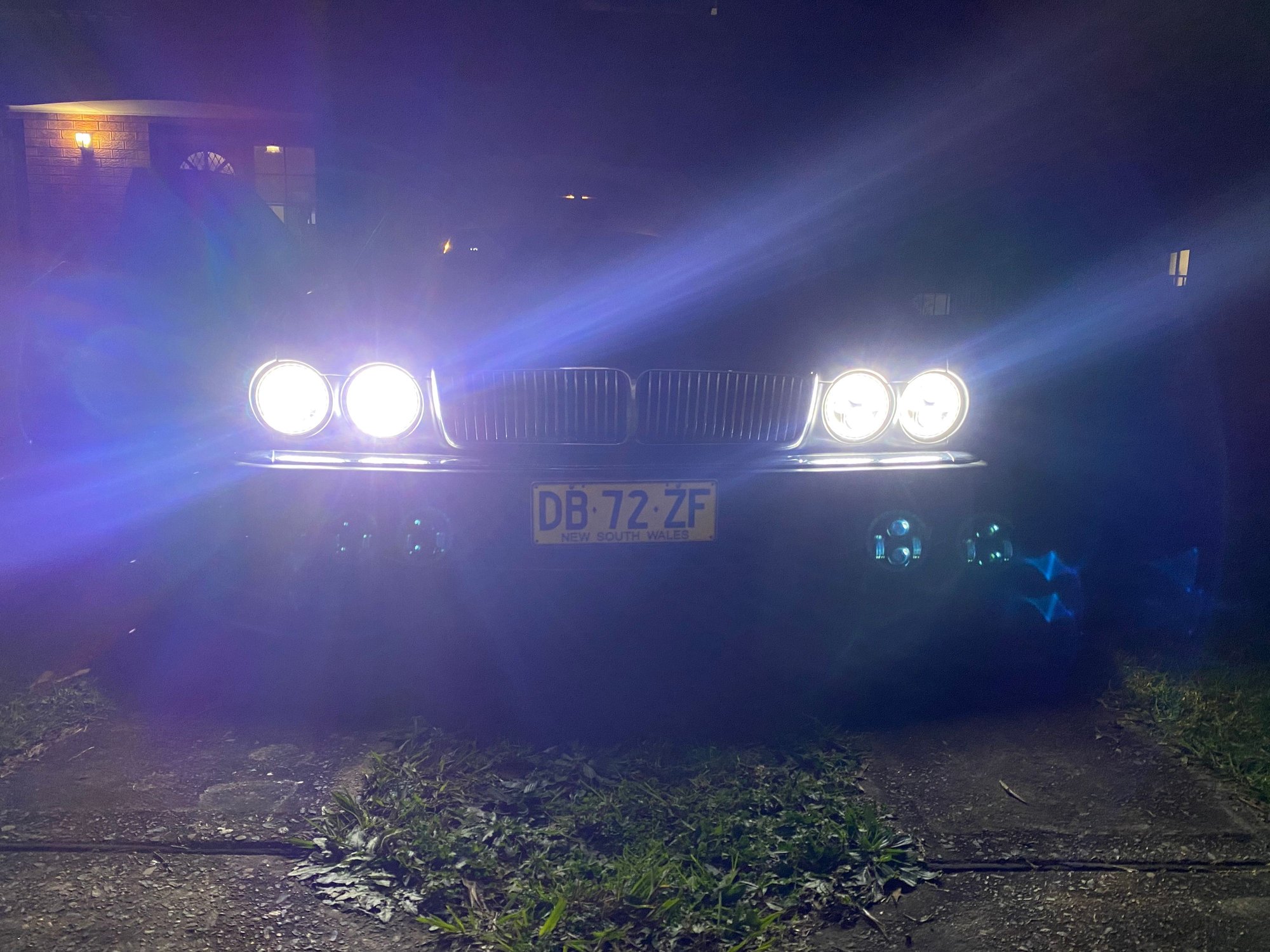

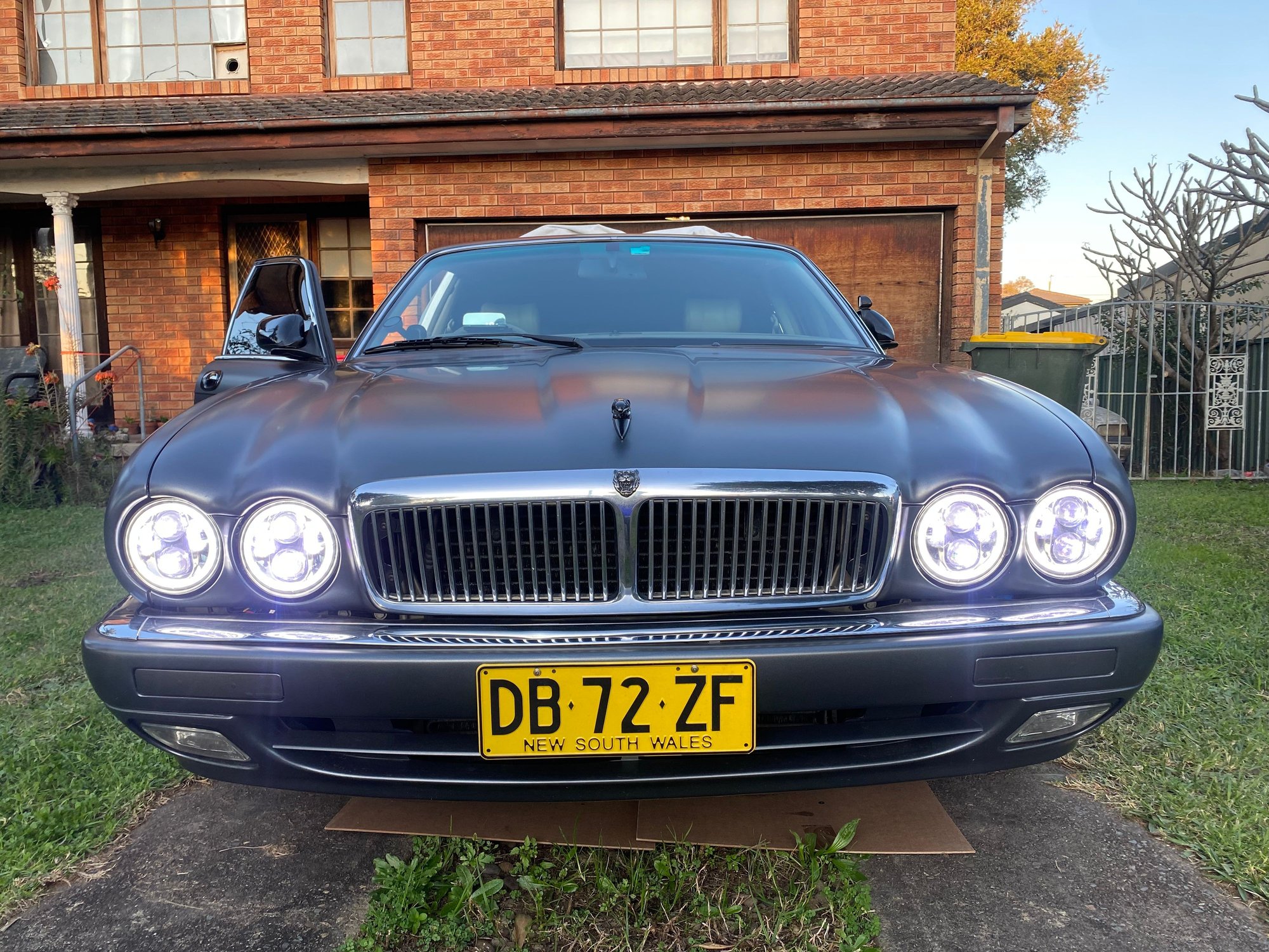

Each light has a low beam and a high beam projector.
the outers are connected to low and high and the inners only come on with high.
i disconnected the indicators in the bar and connected load resistors to get correct flash rate and made the old indicator units car colour.
full thread can be seen here for anyone interested
https://www.jaguarforums.com/forum/x...-units-255475/
