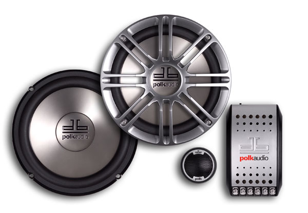

1-set of the Polk DB6501 for the doors and tweeter in the dash $200.

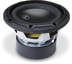

2-6W3V3-4 JL subwoofer for rear speakers $280.
Others went with the MM6501 Polks which are 2.7 ohm and the DB's are 4 ohm I went with 4 ohm which is the spec for the Alpine amp.

Before I the put in the new speakers I put Dynamat on the doors which made a big improvement.I was able to mount the 6.5" speaker with all 4 screws into the original mounting plate.

The factory tweeter in the dash were removed and I took out the screw that was there and used it to mount the new tweeter base.I had to modify the grill with the dremel on one of its feet that was hitting the tweeter.I left the original tweeters in the doors.
I put in the crossover but it didn't add any improvement so I took it back out and spliced the wires back together.Matt (h2o boy) mentioned in one of his thread that his stereo installers never found one,well my guy told me the reason way,the cross over funtions are in the amp,so when I went to the head unit I could set the bass or treble from there,who would have guessed.
I have had the new speakers in for a week and they sound great even before they are completely broken in.I didn't know that the system could sound this good.I think I will hold off on a new amp and head unit.
The rear sub woofers were easy I got the removal info from JTIS,the speakers were a direct fit,I also covered the enclosure with Dynamat.

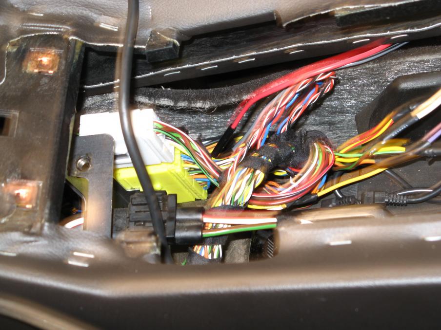

If you need to get at the speaker wires,they are located in the yellow connector in the console.

Nice job eagle, I do recommend those new JL Audio 6.5inch subs as direct replacements. Did you reinforce the enclosure at all?
I am really glad you like the DB series by Polk Audio, and I did try those at first too. In my Jeep I had the MMC (MOMO then) series in it, but paid a small premium for it. I thought, hey..give the DB series a try, and after the MMCs, this was disappointing, so I sprung for what I thought was much better, in all frequencies. I picked up the MMCs from Ebay, new from a seller for around $175. Just in case you feel something lacking...give em a shot.
And, you left the little supertweet in the door? Hmmm, I suppose some of the highs then are directed away from the Polk Audio tweeter you just installed and goes to the Alpine. I would be curious to hear how that sounds.
Now, let the 'tweaking' begin! Old favorite tunes never sounded so good.

I did reinforce the rear speaker enclosure based on what you had done,I used MDF board and mounted it to the front of the factory enclosure and painted it black.
The door tweeter does not overpower the dash unit they seem to work well together,so far so good.I was thinking of moving the old tweeters to the back rear speakers in the space above the subwoofer and used the crossover units I didn.t use for the door speaker and dash tweeter,any thoughts?
