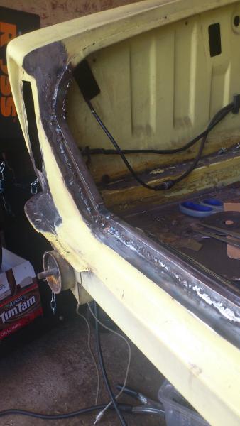

For now I've conceded defeat - the other problem is that when I've tried to get other paint cans posted to me they are supposedly 'dangerous goods' and the price just gets amusing. Recently I wanted custom mixed "Pale Primrose" spray cans and the postage from Sydney to Canberra was going to be $A25 - per can!!
Most of the welding I'm doing is in and around the boot area.(See below)
This lip around the boot is double skinned. For now I'm just using Cold-Gal Zinc primer on the reverse sides which, though not ideal, is better than nothing.
(Don't be harsh on my welding - I'm still teaching myself!
