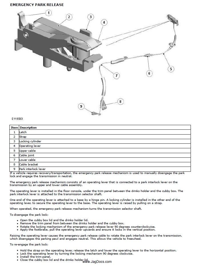

T1 Terry,
If you are lucky the EPB (Electronic Parking Brake) is not engaged and the only thing stopping the rear wheels from turning is that the gearbox is in P (Park).
There is as fairly easy way to get it out of P and into N (Neutral) by releasing the Park pawl, see attachment:

Thanks, I did try that, but it still wouldn't move, so the Electronic Park Brake must also be engaged .... now to find out how that is released
