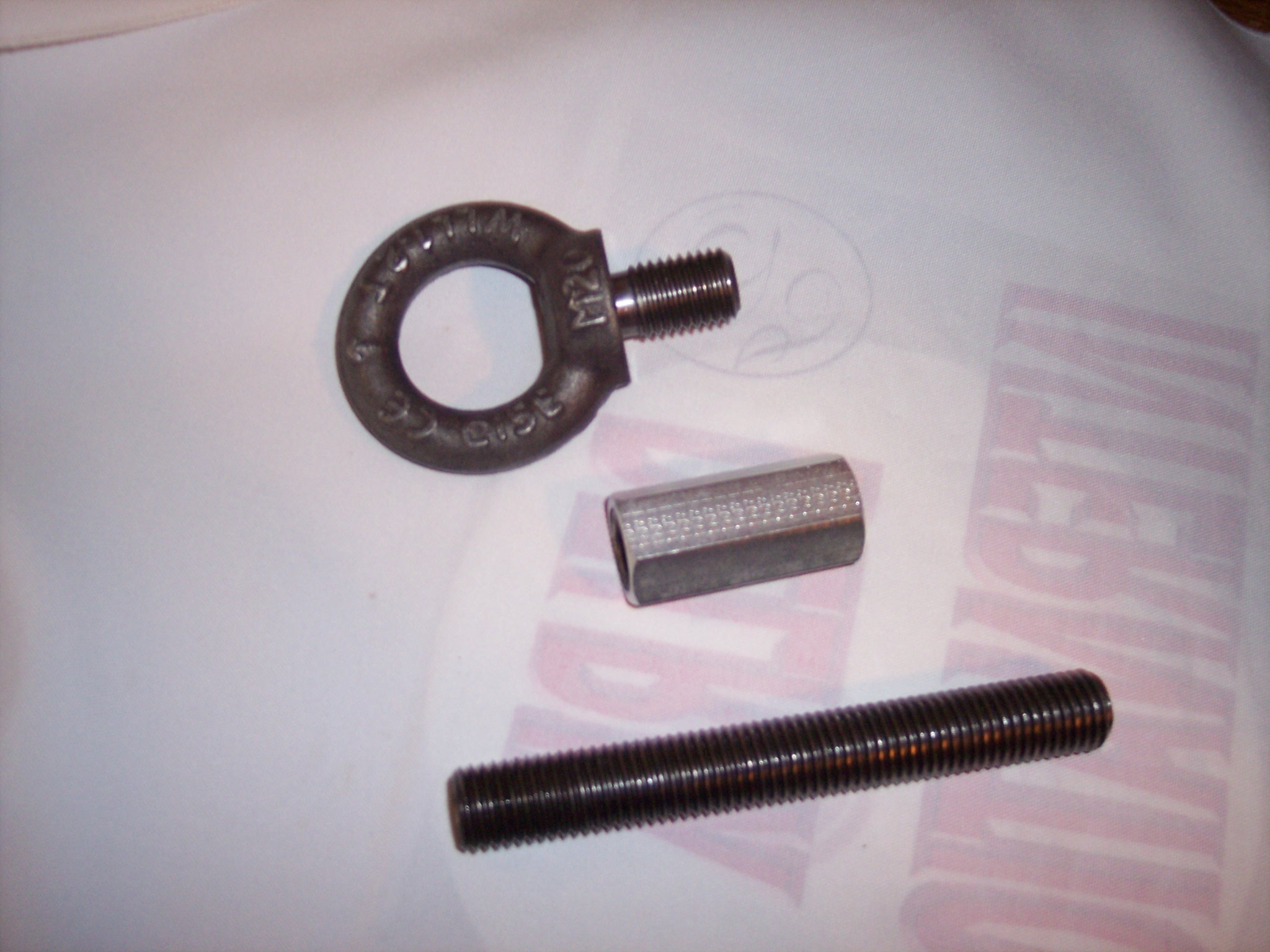

Old Feb 28, 2014 | 05:38 PM
hnh375's Avatar
Joined: Nov 2009
Posts: 57
Likes: 15
From: Niagara Falls. Canada
Red face
A few days ago Stevenx605 brought to my attention that the M20 Din 580 Lifting/towing Eye fit our 2004 xkr jags on the rear ...no problem. On the front tow hole, however, there is a problem... the eye shoulders are too wide for the tunnel-like molding around the bolt hole. I therefore went to a machine shop and had them make an extension using a rod coupler nut and piece of m20 coarse threaded rod. The coupling nut is hex m20 coarse thread about 5.5cm long and the rod is about 15cm. long. This solves that for an extra 40 bucks. Also a tip: It may be that the rod and coupler should be welded together or a locking nut added in order to extract the bolt from the hole in the car more easily. My extension rod stuck in the hole and was hard to get a grip on it ...might mess up the threads using grips to release it. On the rear of the car the extension is not required.
