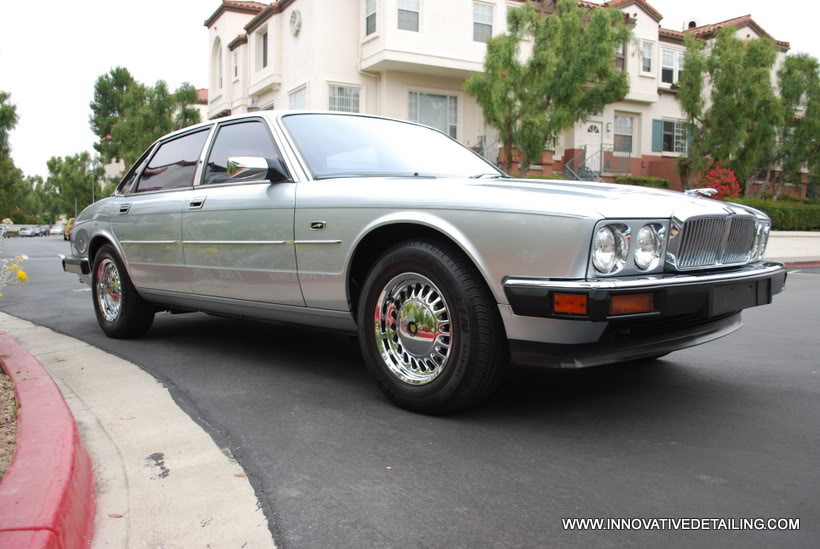

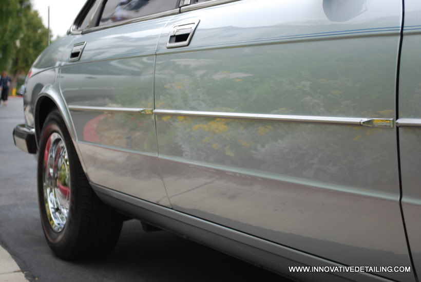

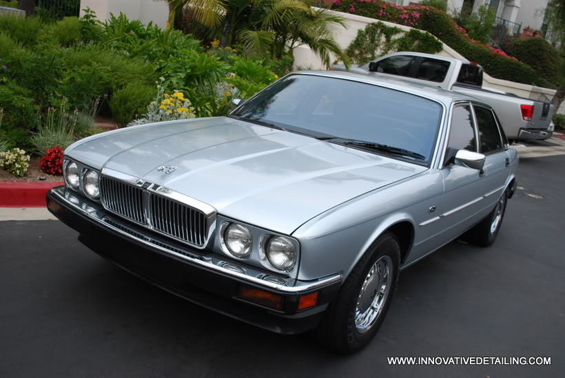

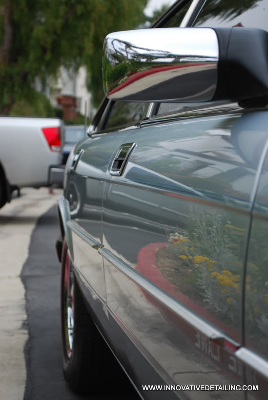

Midlife,
Here is one that I corrected yesterday for Mr Christian Beyer (Drove the RR Ghost for our Coffee & Cars event) the head salesman @ Rolls Royce of Orange County. It was a 1999 XJ6 w/ 40,000 original miles that had pretty much the same conditions that you are describing. Its upper surfaces, especially the roof were showing moderate signs of paint failure due to a cloudy oxidation film on the tops. I picked it up yesterday at the dealership and gave her my "Magic"
Sorry for not providing before shots, but yesterday was an ugly overcast day, lighting was terrible and I had no time......aaarrggg!

If you have the proper products and tools and you can get past the learning curve, this can be accomplished. Otherwise your local (PRO) detailer should be able to do this for you without a doubt. Some areas had to be lightly color sanded followed by a thorough pass with my rotary polisher, one polish pass with the D/A, then my LSP with the D/A.
If you have any other questions, please let me know....
