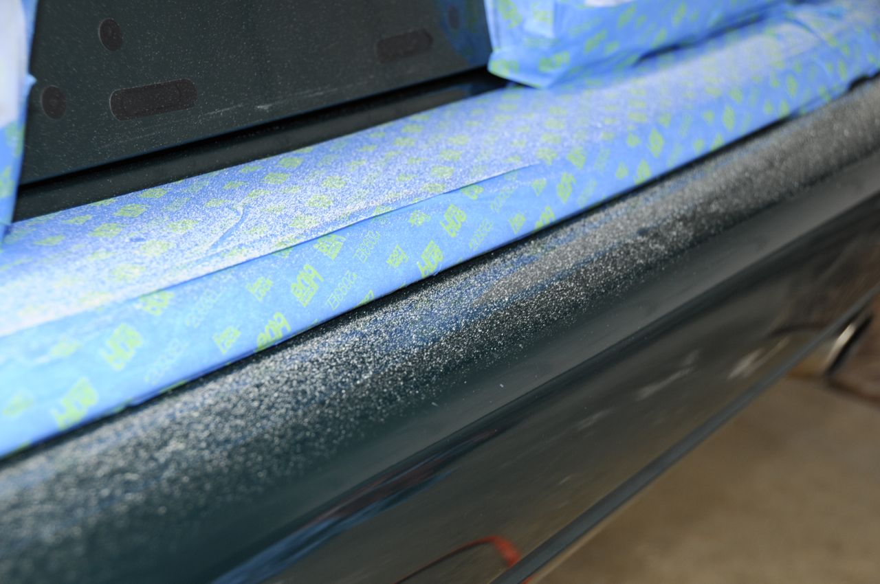

This is what happens when you use too much speed and pressure
A lot of dust created by the Swirl Remover

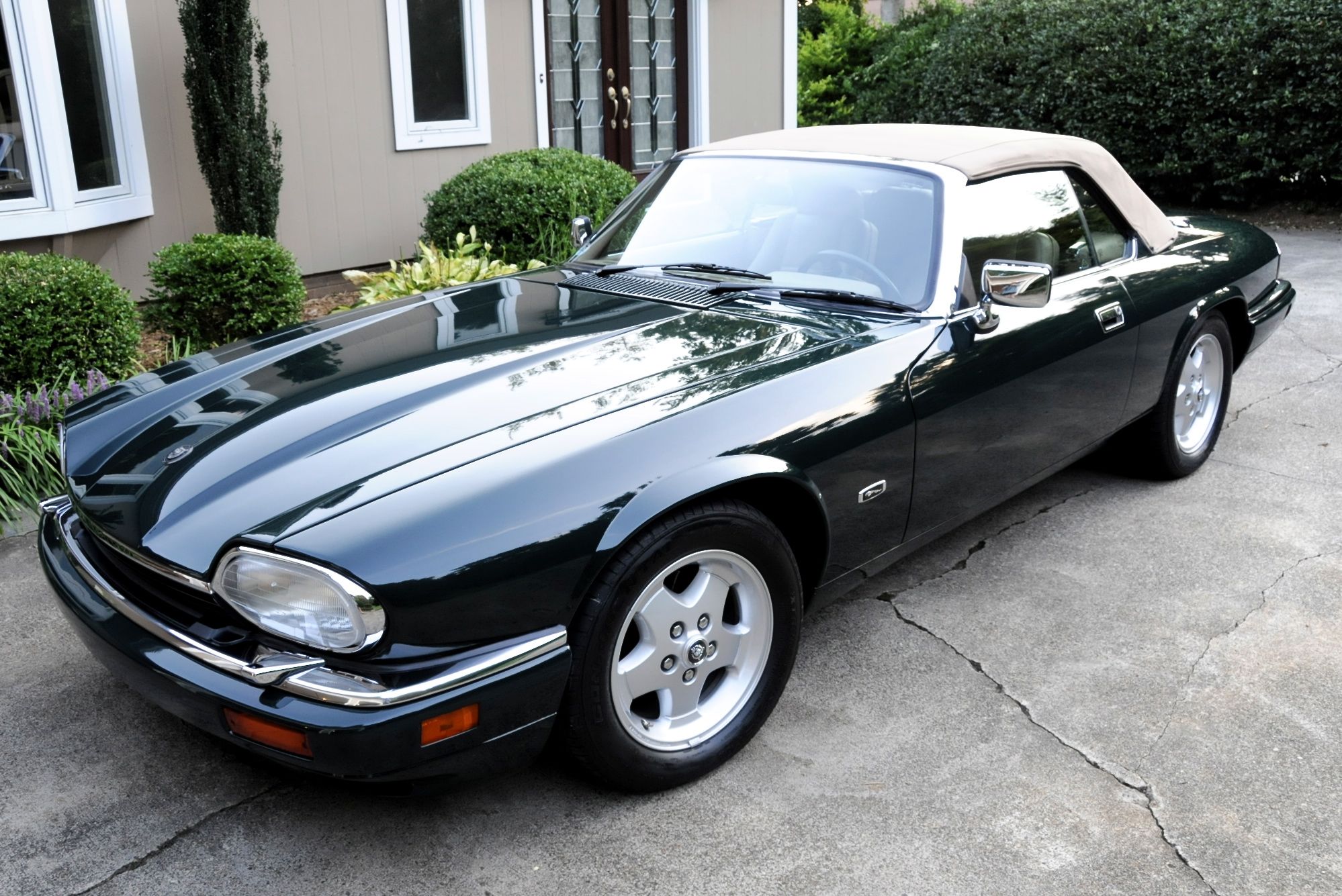

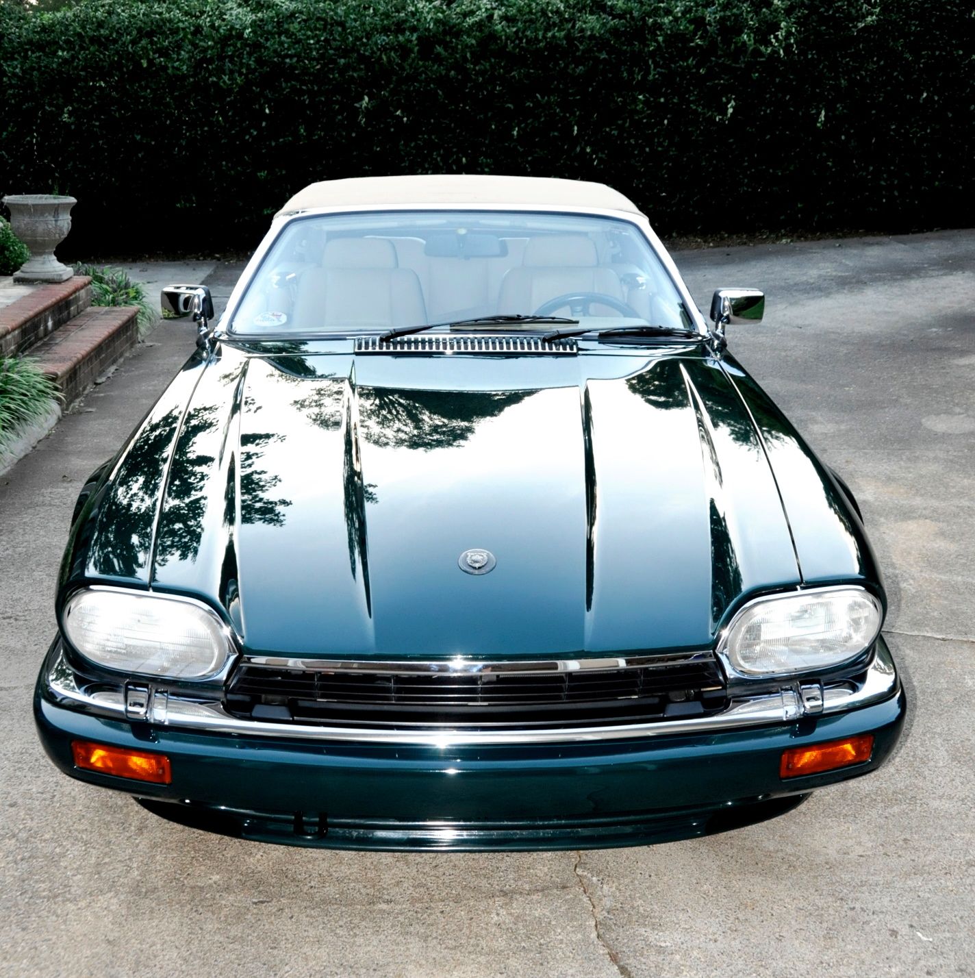

Well I managed to get her outside for a few pics but the light was failing so they may not be that good. Still have a couple things left to do, clean the glass, polish the front and rear lights and add a coat of wax but she is basically done!! (on the outside at least )
Here are a few pics, I think she's looking rather spiffy for 19 years old and I'm quite pleased at my first attempt at colour correction.
I'll post a full report this weekend. It's certainly been an interesting ride
