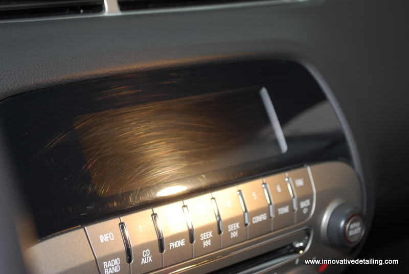

One of my newest customers had recently "Fired" his detailer for ruining and scratching his vehicle, from the paint work all the way to the radio display cover on his 2010 Camaro SS
As you can see from the before pics, this plastic on the radio was full of "TODS".....The Other Detailers Scratches. So it was my goal to correct it for my cusotmer since his only option was to replace it.
So much for the other detailer, Innovative Detailing gained another customer for life!
Here is a small video slide show on how I corrected the polycarbonate radio cover on this Camaro SS
I chose to use my detailing arsenal from my Meguiar's Professional Headlight Restoral Kit, this is what was used....
Dewalt Rotary Polisher
3" Backing Plate
W7204
W8204
M105
M205
Hand pad
W9204
M21
Blue tape
Masking paper roll
MF towels
http://www.youtube.com/watch?v=CpgvN0V0saY
Here is a still shot before the correction
Here is a still shot after the correction
