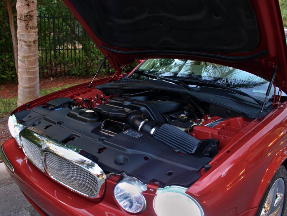

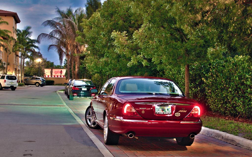

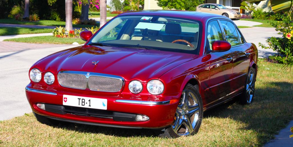

ZYMOL is the best WAX ever! Today I took time and used my HANDS not a buffer to wax my car with Zymol Z503 Cleaner Wax, and I must say I'm super happy with the results, I have used meguiars, sonax, and other leading brands before but nothing performed like Zymol, just wanted to share with you guys, the wax is all natural and priced very fair, I got it for 12 bucks, here are some photos I took, I also cleaned the engine bay, even though it wasn't dirty at all.
Attached Thumbnails Tried everything but....-jagmasterhdr1920.jpg   Tried everything but....-jagmaster1.jpg   Tried everything but....-screen-shot-2011-02-25-10.12.53-pm.jpg   Tried everything but....-screen-shot-2011-02-25-10.13.45-pm.jpg

Great pics, great colour, same as mine, I will have to try the zymol ,

Man, red really pops on that car, at least in that setting in South Florida!

You can really see the radiance red exterior when the paint is properly waxed...love it! When you're ready to sell her, let me know. I'm shopping

JagMaster, she looks gorgeous.....wet and shiny like a candy apple, this color when dialed up right is one of my favorites. I have used Zymol in the past, only their polish though....all that matters is if it works for you and you acheive the results you wanted. Great job!
