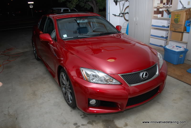

Prep for paint correction begins on this 09 Lexus IS-F

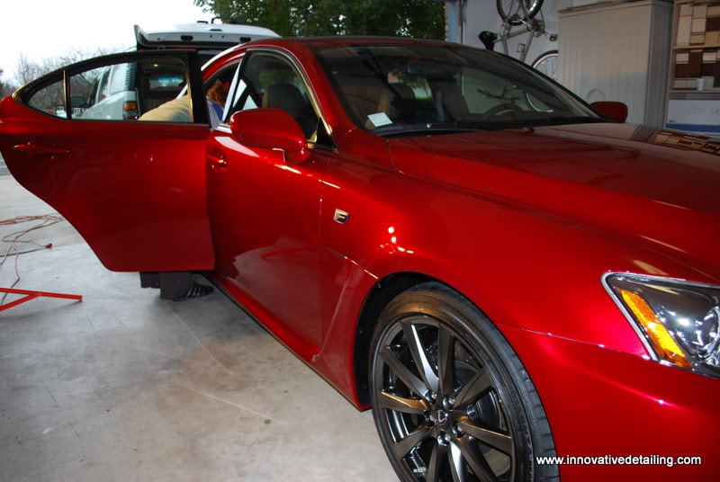

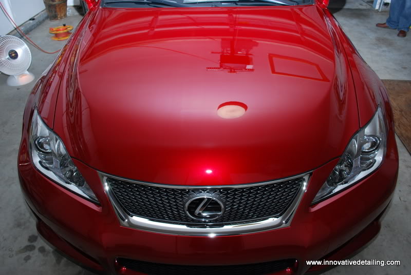

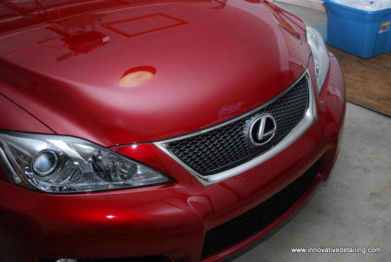

Paint inspection begins
Taped and ready

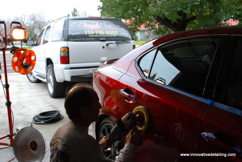

First pass with rotary with a M8006 pad and M205

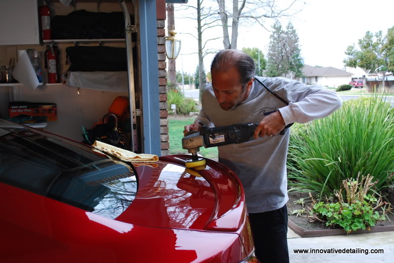

Extensive scratches being jeweled/polished out the rear spoiler with a LC 4" yellow pad and M105, these were deep

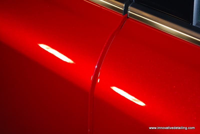

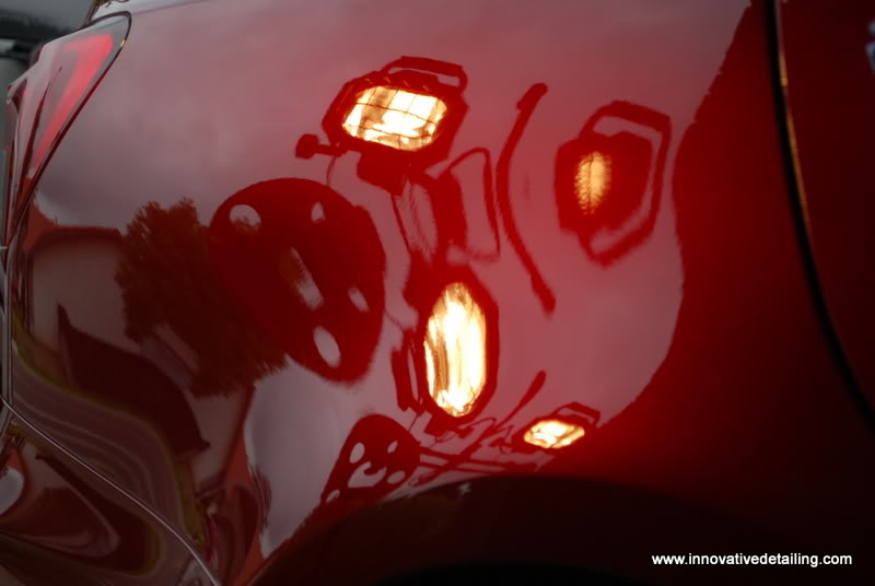

Light up and corrected

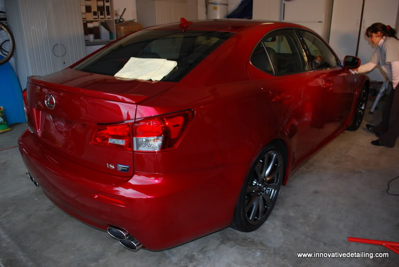

My wife removing the LSP

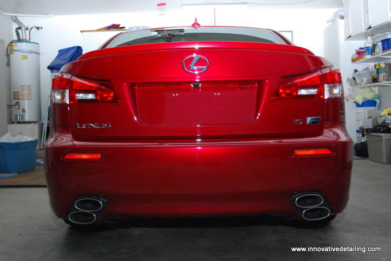

The after shots, wet and shiny "Candy Apple" style
