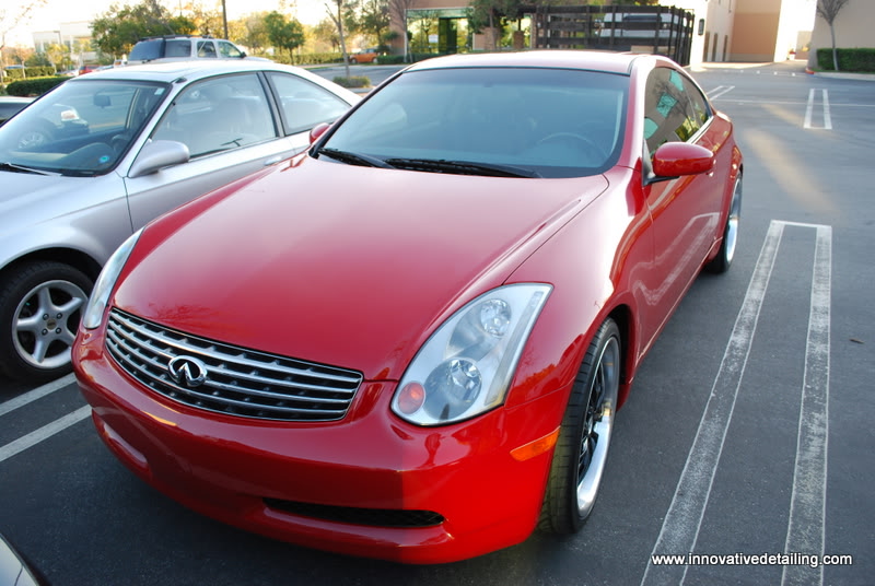

Today's job was one of the most horrendous that I have seen in a while. You all know how for the most part we get the "Creme de la creme" when it comes to detailing. But if I have an enthusiast, regardless of vehicle type...there is no prejudice for that........I am here to take care of their vehicle needs just like any exotic.
So upon my arrival, the first thing I observed was my friends the "Kokopelli's dancing off the suns reflection on this hacked up 03 Infinity G35 that had been repainted 3 months ago and left for "SWIRL"
So lets compare the two and the similarities.........

Now for his cousins.....tattooed all over this G35

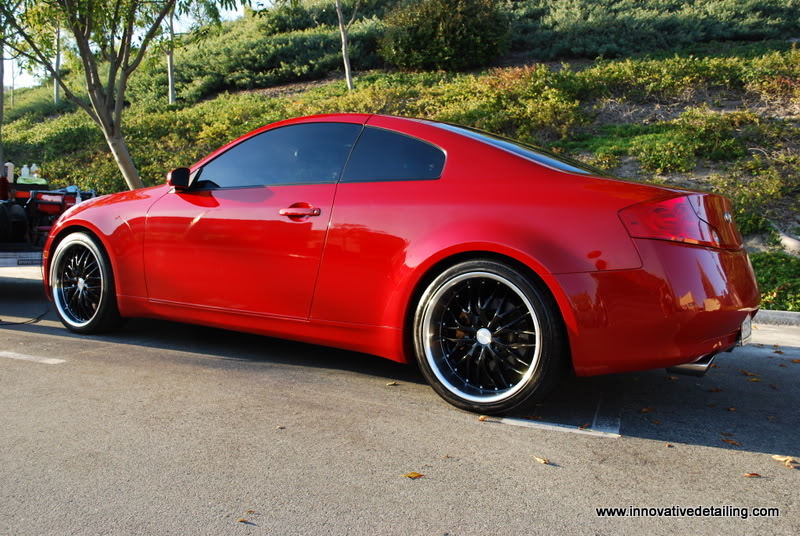

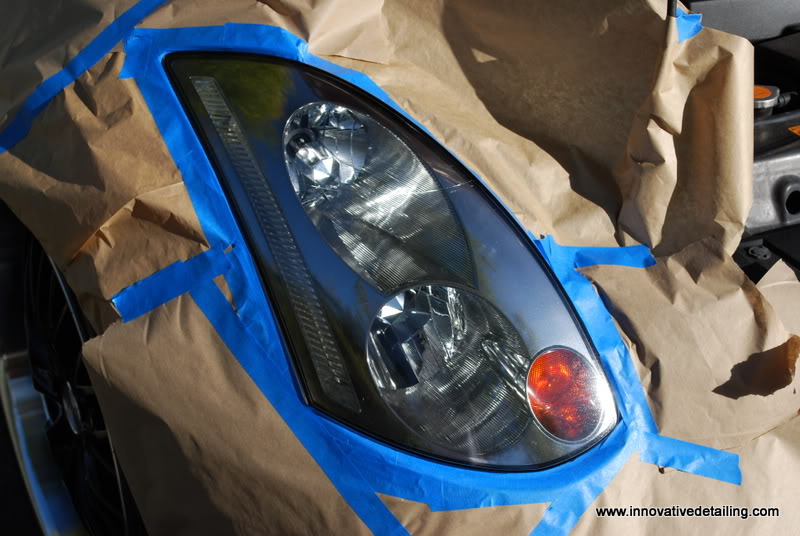

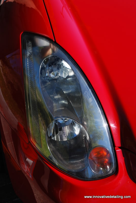

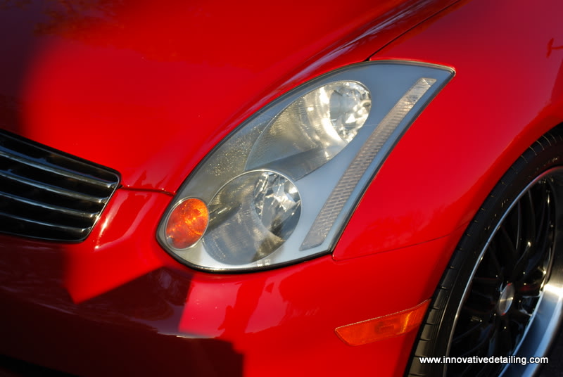

Some headlight lens restoral that was also provided on both lenses
Size:  53.5 KBName:  DSC_0597.jpg
After headlight lens restoral

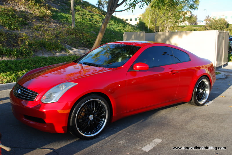

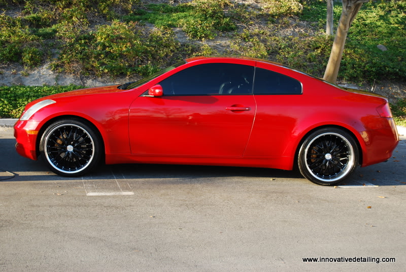

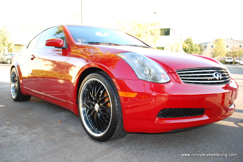

Some finished shots of this G35 after almost 10hrs of correction...
You can only imagine how happy my customer was after seeing this transformation....
