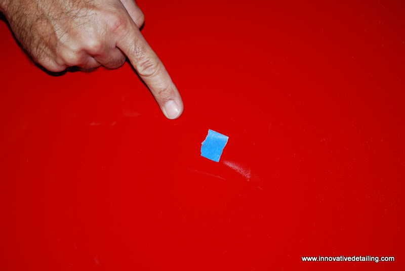

Visible clear coat paint defect which I covered with tape to avoid

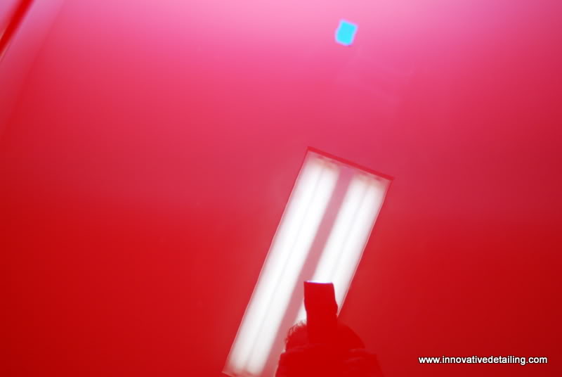

Step 2 complete pass with rotary and M205

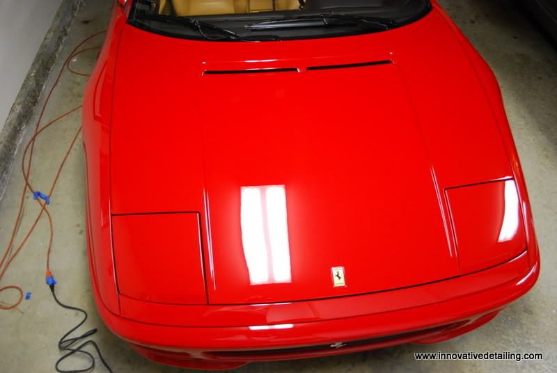

Finished and parked in her stable glowing..

that was scary good how the clear coat blemish disappeared.
