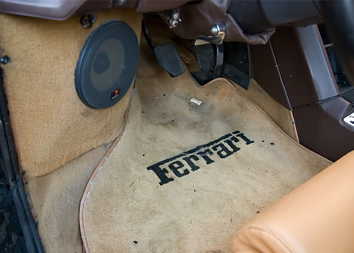

First off a walk around of the bella macchina.
lol yes that is a dog biscuit
In defense of the owner he said it was I while since it was detailed and the last time it was just a quick job
So starting with the interior I dusted the car down to get in the tight areas. At the time I was using a Meguiars Slide Lock Brush but it gave out on me and I had to take what was left and wrap it in a rubber band, but it still did the job

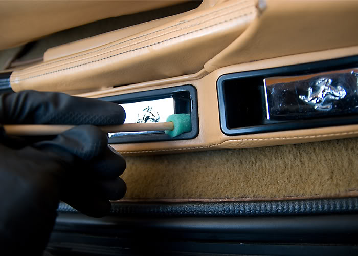

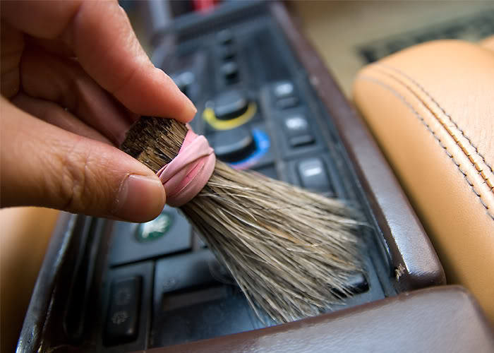

At the same time I used my foam stick to get in the tight areas that my fingers couldn't reach
Got in the tight areas of the prancing horse on the hood and trunk latch and here are some before and afters

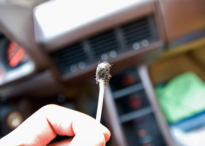

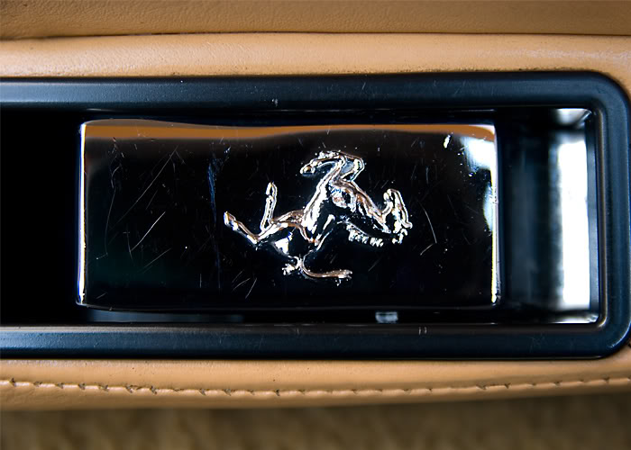

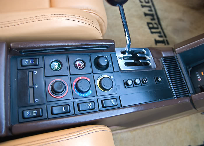

Got in the even tighter areas with a q-tip
Had to scrub a few areas with the fine side of my Meguiars Triple Duty Brush like...
The cassette tape holder buttons
And the "PRESS" on the seat belt

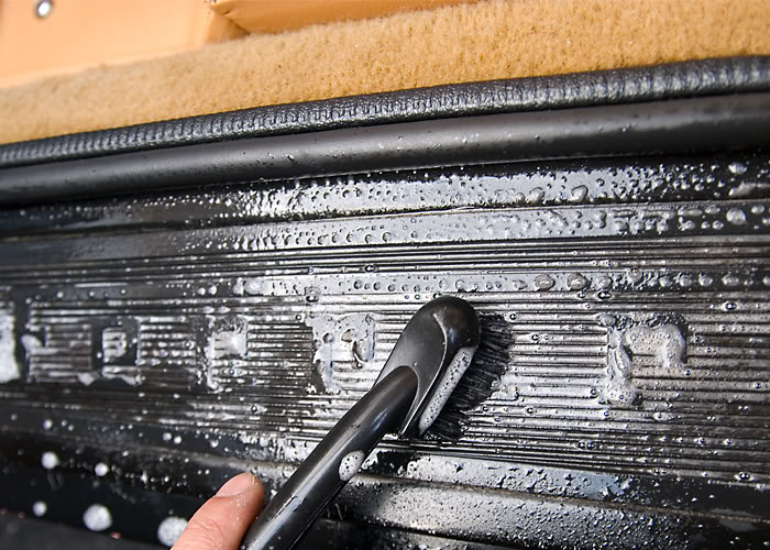

Scrubbed the door sill
And the pedals, no dressing was applied after the clean up as common sense is I don't want the pedals slippery
Before
After

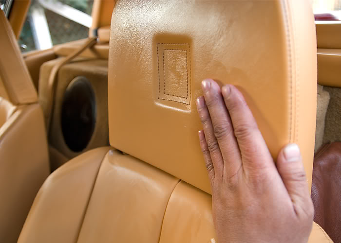

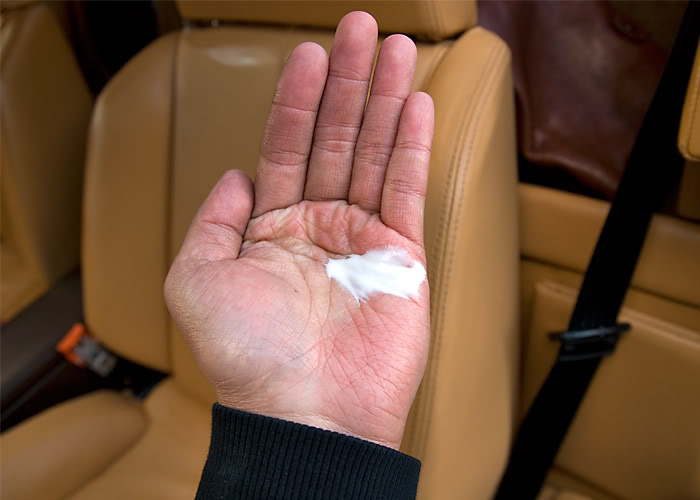

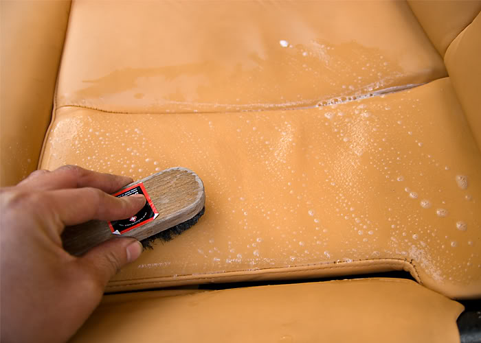

Pretty much everything in the interior is leather. So I leather cleaned and conditioned everything... the seats, dash, doors, and roof
Gliptone Leather Cleaner & Conditioner was what I used
Scrubbing away with my leather brush
Leather conditioned by hand and massaged it in to the leather
Doors
Seats
Roof
I let it soak in for a bit then wiped off the remainder for a nice natural finish.

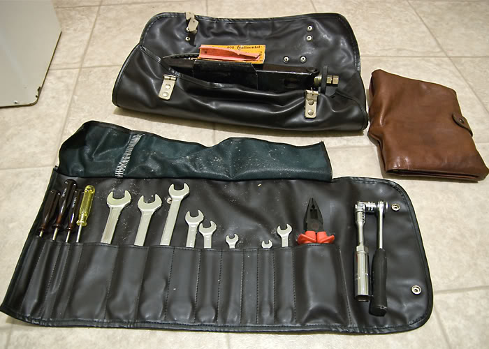

Brought the tool bag, owners manual, and jack inside for a cleaning.
Tool bag was dirty and disorganized
Cleaned up the bag with some APC and the tools as well
Clean and organized
Leather cleaned and conditioned the owners manual bag
Cleaned the bag that held that jack etc and wiped down the jack and tools
And here they are ready to go back in the car

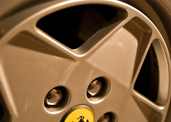

P21s Wheel Gel was used to clean the rims which is non acidic. I could leave this cleaner on the rims all night and no damage to the rim. Acid based wheel cleaners you can't say the same for and even a light application of them to ceramic brakes, anodized rims, etc and a beautiful rim or brake system is ruined. So no acid based wheel cleaners....ever!
Let the rims soak while I attended to the engine bay
I didn't get to aggressive on the engine bay but still did the best I could. I wiped down with Meguiars All Purpose Cleaner and then dressed it with Meguiars Hyper Dressing cut 20/80 with water for a nice natural finish.
Here is a before and after pic
Before
After (still a little wet from the dressing)
Artsy Fartsy
Moving on to the rims
Getting in the inner barrel with my handleless EZ brush
Behind the rim
Cleaned the rim face with a micro fibre mitt
And used a foam stick to get in the lug nut area

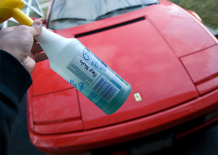

And sprayed on Prep Wash to strip off any silicones which will if left on hinder the paint correction process because the silicones fill scratches and if not removed the polish will not cut out the swirl but just glide over them

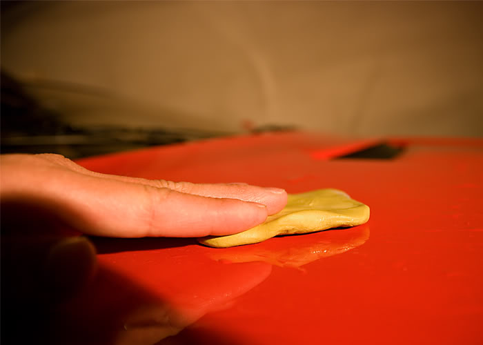

Riccardo Clay was used. The reason for clay barring your paint is it basically sheers out contaminants embedded in the paint. This can be raildust, fallout, or even just tiny dirt debris. If you wash your car and run your hands along the paint you will probably find that it is still pretty rough. What you are feeling is the surface contaminants.
Pretty contaminated

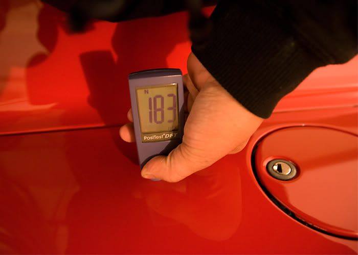

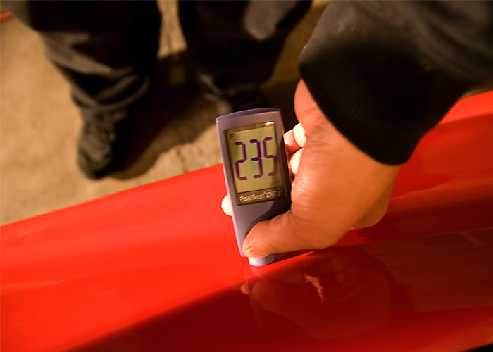

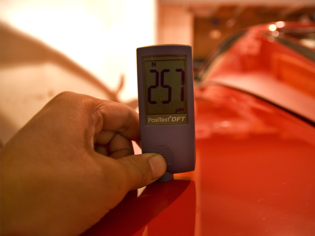

Measured the paint to see what I was dealing with and look out for any low spots. The owner had told me that the whole car had been repainted so I was dealing with fairly thick paint. Measurements were taken in microns which are a thousanth of millimeter.

I have a few question:
1. When using the paint thickness meter, you are obviously measuing the thickness of the clearcoat correct?
2. What is the minimum measurement you would feel comfortable working with a rotary? Would it be the same if you were using a DA?

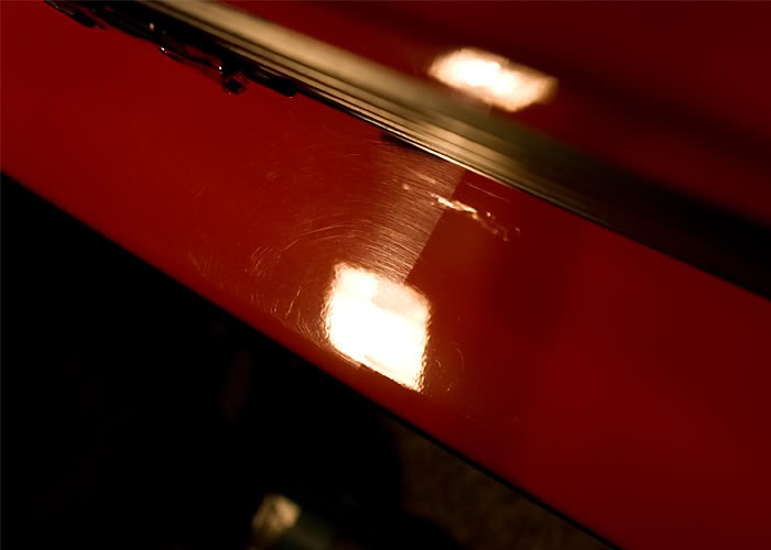

Masked off the rubber trimmings
And here is what I was up against under 500w halogen lighting
Did a quick test spot to find a combination that worked and here are the results of a wool pad and Menzerna Super Intensive Polish which is a medium cutting polish.

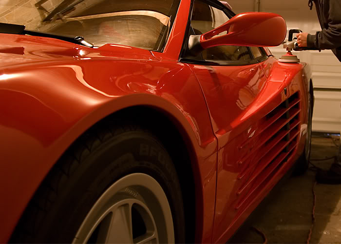

Single stage paint really clogs my pads up so I had to change them frequently
All the tight areas my rotary couldn't reach I did by hand with on orange lake country pad and Meguiars M105 then a white pad with Meguiars M205. They did not end up perfect but still a huge improvement to how they were before
This was a full paint correction so the few deeper scratched I wetsanded with Micro Mesh sand paper 2400 grit and then 4000 grit to refine and then finally polish out the sanding marks. Results were either to round off the edges of the scratch to make it less apparent or to completely remove the scratch.
After all the compounding and wetsanding I finally jeweled the paint with a white Lake Country pad and Menzerna P085rd. Here is a shot of me jeweling the paint.
And finally the results of my work

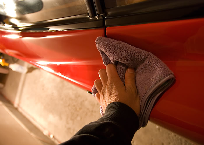

Dusted it down and got in the tight crevices.
Gave it an alcohol wipe down to clean off the polishing oils

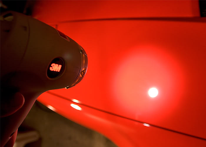

Then double checked my work with my 3M Sun Gun which omits the same color spectrum light as the sun. So basically what I see with this light is how it will look in natural daylight.
Perfect

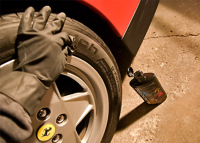

Sealed the rim with Poorboys Wheel Sealant to protect against brake dust
Dressed the tires with Blackfire Long Lasting Tyre Gel which after being left on for awhile then wiped off leaves a beautiful finish
Here is an after pic of the tires and rim

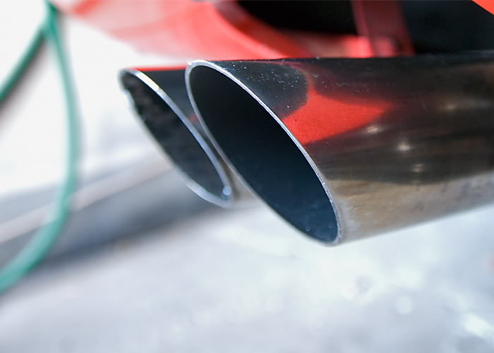

I couldn't get the exhaust perfect but still made an improvement.
Before
After

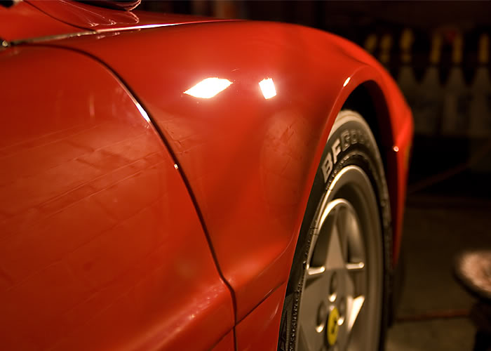

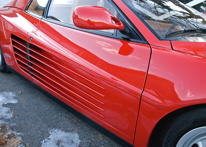

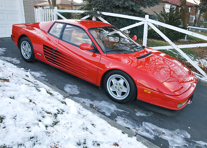

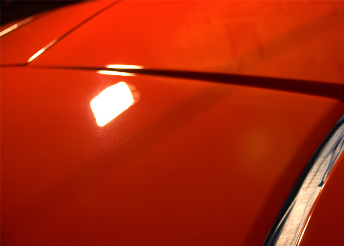

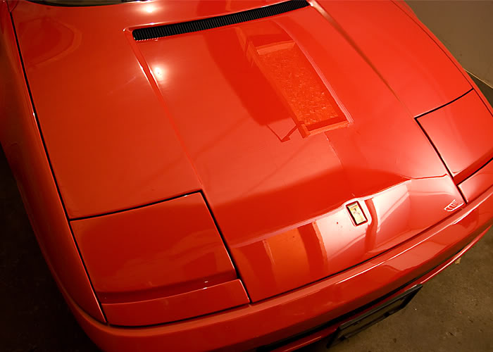

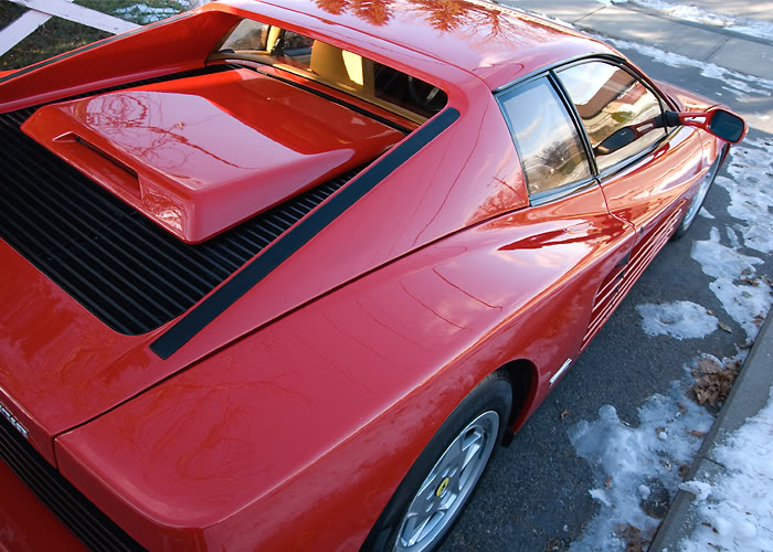

Now finally after 50+ hrs of work, -10 weather, and the first snowfall of winter here are the finished pictures.
First up some shots of the sun on the paint
And my last 3 favorite pics.

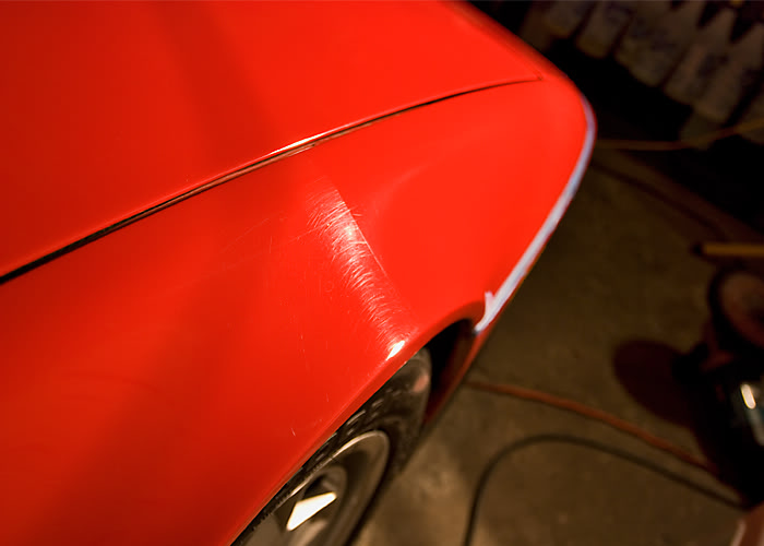

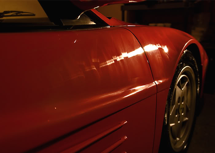

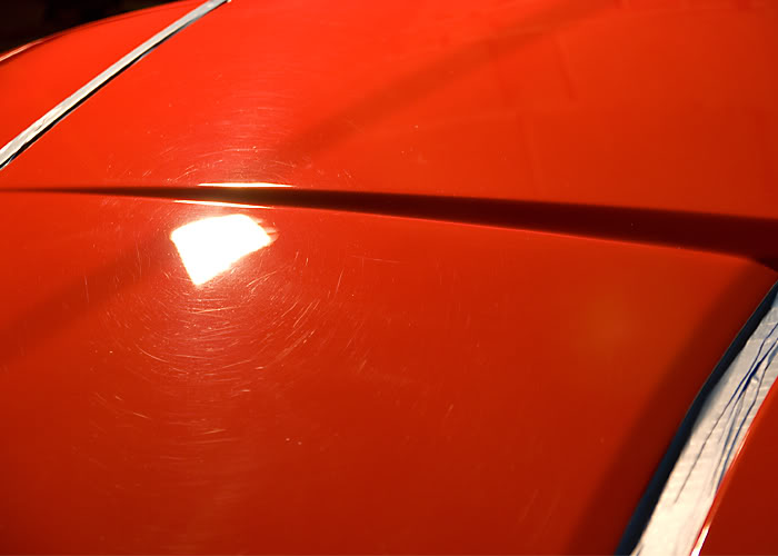

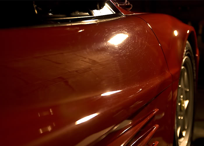

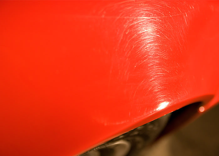

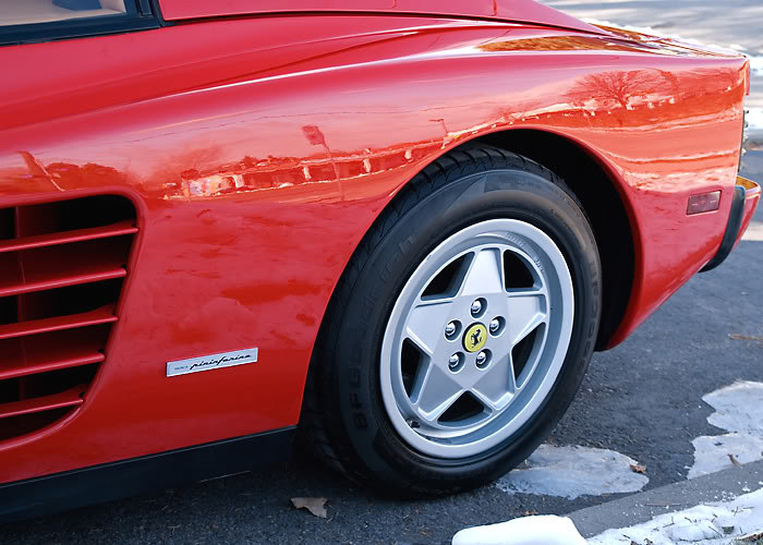

Now for a few before and afters of the body panels
Before
After
Before
After
Before
After
Before
After
Before
After
And a 50/50 shot

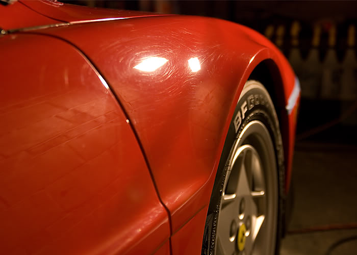

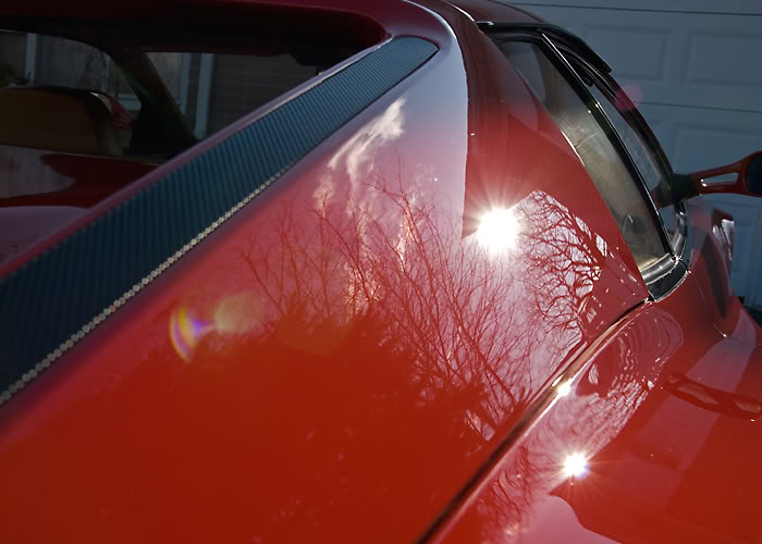

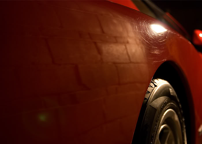

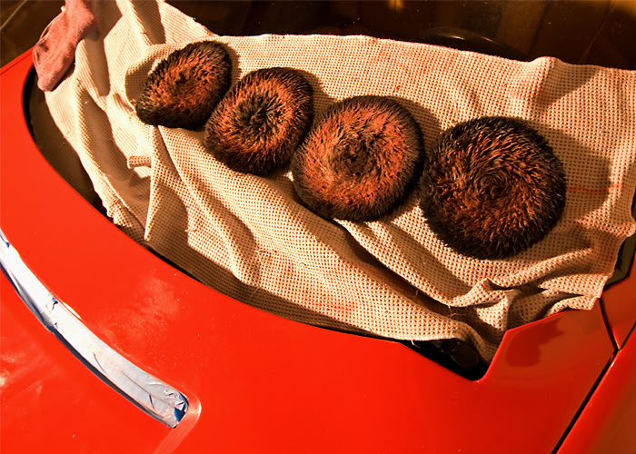

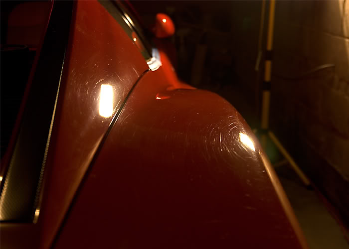

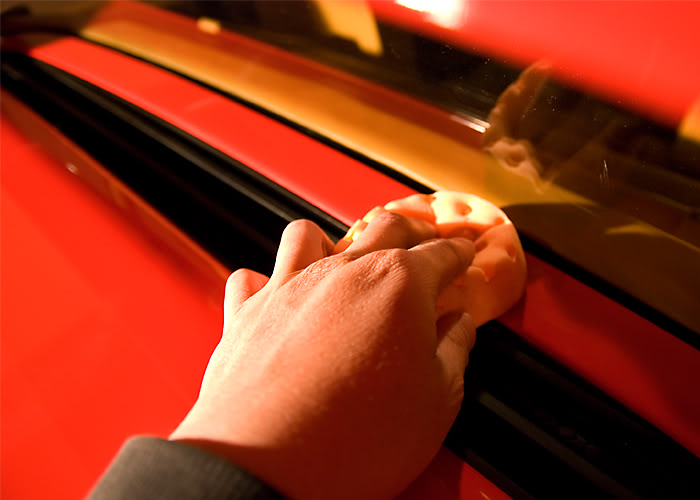

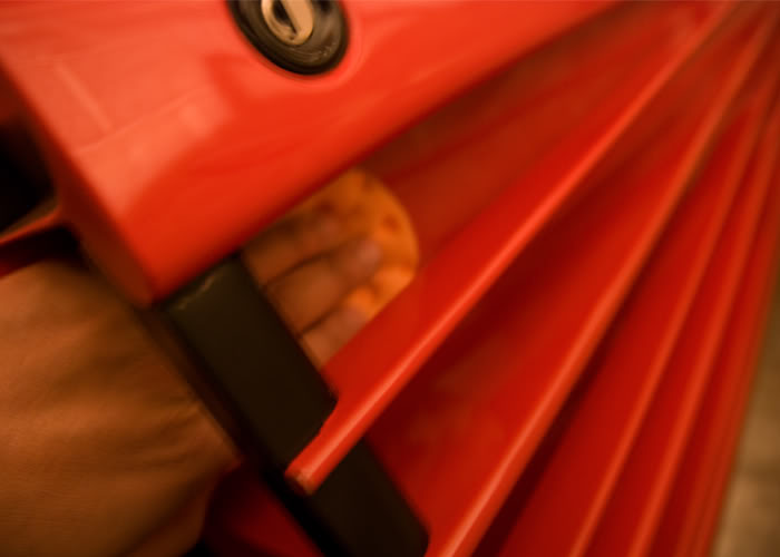

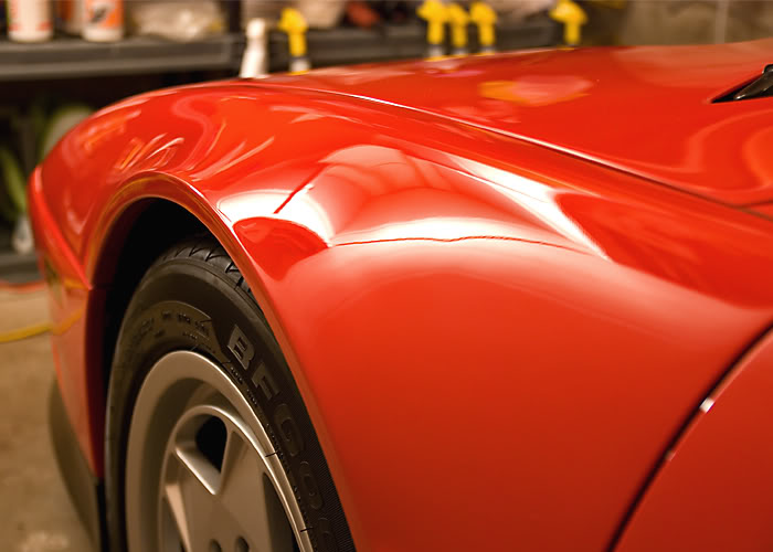

Unmasked the car
Perfect

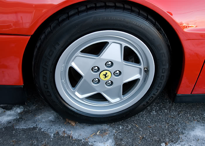

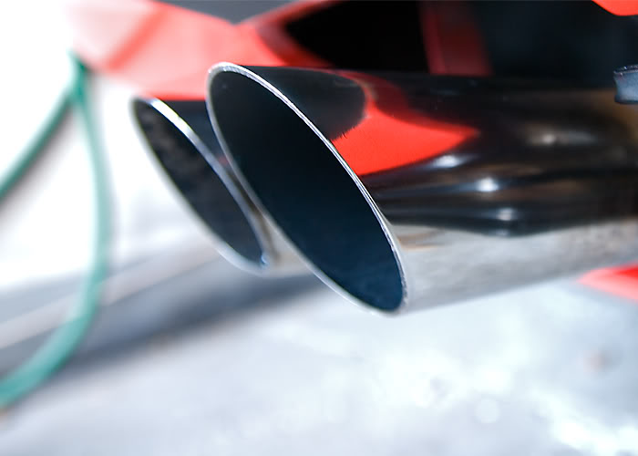

Before
After

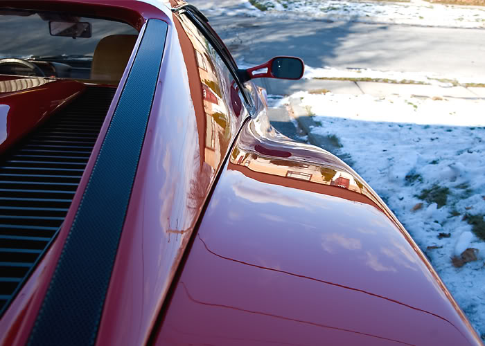

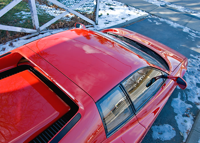

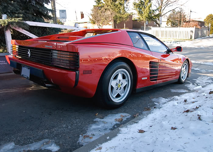

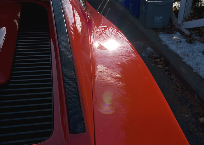

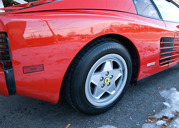

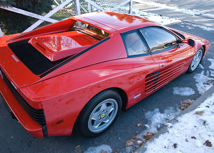

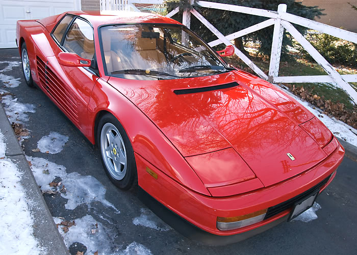

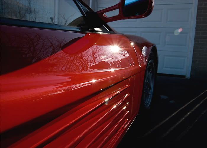

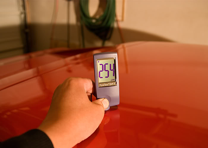

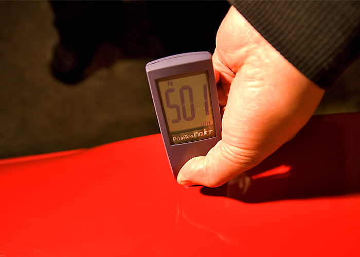

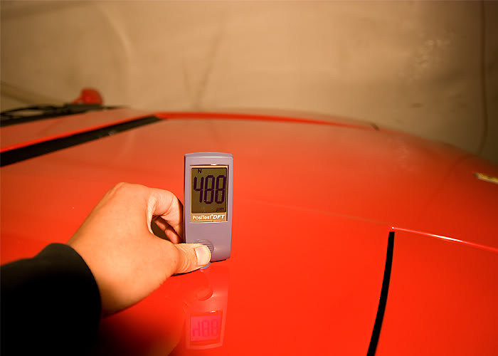

Thanks for posting.....your work is amazing!
1. but unfortunately my meter only measures over all thickness. so that includes primer, color, and then clearcoat
2. I like to stay above 100 microns and yes it would be the same for DA.
I appreciate the kind words!
