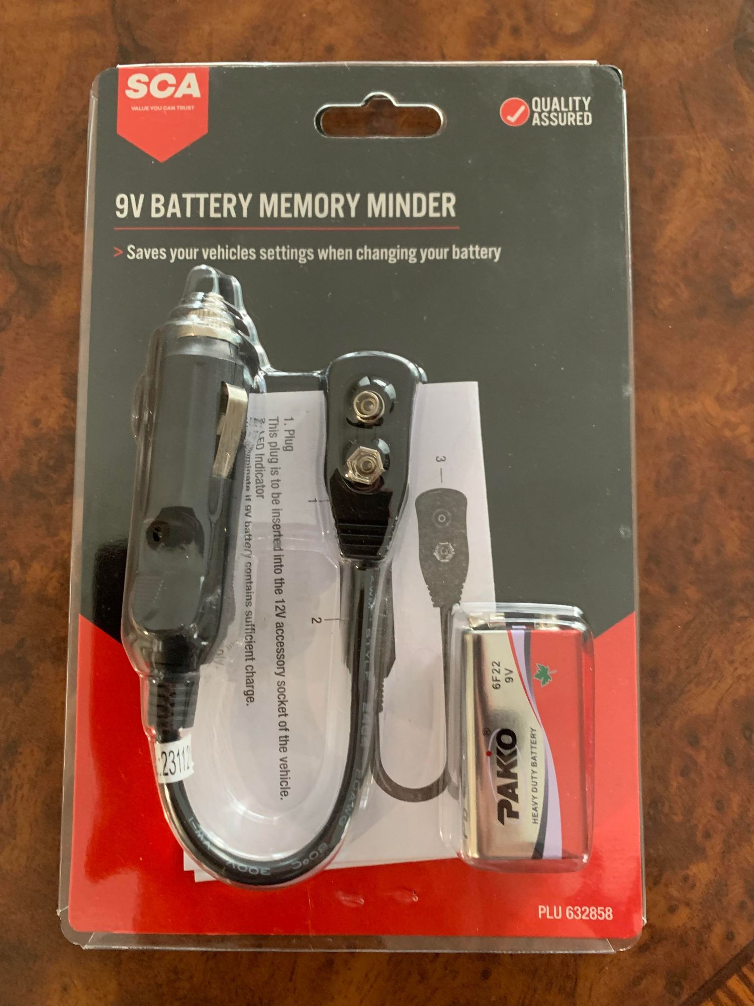

I am located n Australia and AC Delco isn't readily available here. I bought a comparable battery at a local auto parts store and installed it myself. I plugged a "Memory Minder" into one of my 12v sockets and nothing had to be reprogrammed. If I lived in the States and couldn't install a new battery myself, then I would go to someplace like Auto-Zone that has stores nationwide (to honor the warranty). They will use a memory minder to retain all of your settings. Sorry, but only somebody with more money than brains would take their car to a dealer for anything other than a warranty issue.
