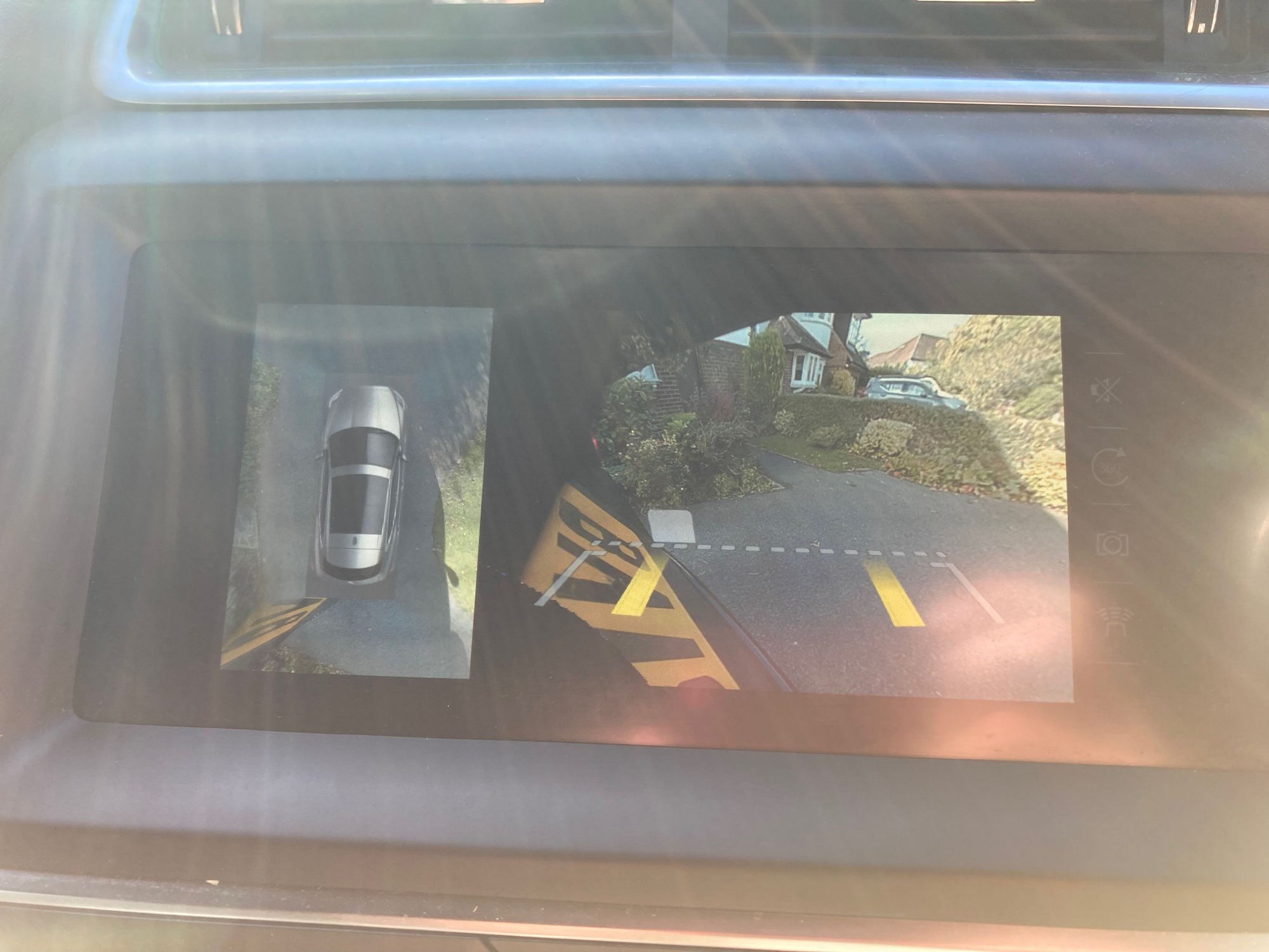

My rear camera on my 2018 e Pace is showing a wonky view as per the attached picture.
The camera is physically straight in the casing and I have removed it and put it back just to make sure, so I am guessing this may be a software issue or the internals of the camera have come loose.
The view is showing part of the number plate and the left hand side view (as you look through the rear window).
The yellow tyre markers are straight and move correctly when I turn the wheel.
Does anyone have any suggestions before I look into a new camera?

I've got a fiver on internals coming loose.. Remove it again, shake the s**t out of it, and see if the angle changes 😂

I believe the rear camera is mis-aligned.

Yes, it definitely is. Do you know how I can fix this?

Have it check to your nearest JLR. According to what I read online, the camera needs to be replaced. But first, check for corrosion in the wiring loom conncting the camera. maybe it's just the connection.

Will do. Thank you.
