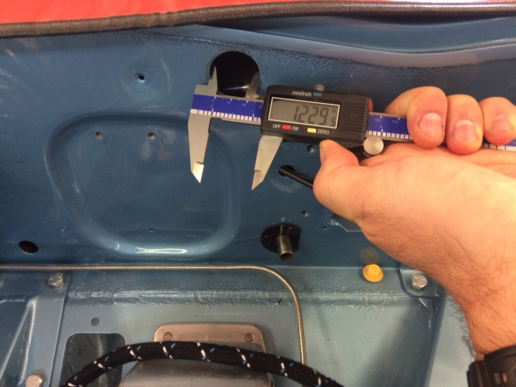

At the moment, I have no good photos or diagrams for the exact firewall grommet for the speedo cable to pass through. I believe the inner diameter of the grommet should stretch to the diameter of the speedo cable.
The body hole is almost 1.25". If someone would be able to take 1 or 2 pictures of theirs, I would be grateful. Also if there are part supplier recommendations other than Welsh or XK Ltd., I would be happy to look at them too.

Hi Craig,
We have this grommet in stock in our USA branch (1800 452 4787), and a free parts booklet i'm sure you will find helpful.
Feel free to contact us and we can give you dimensions/pictures as required.
Part number C976

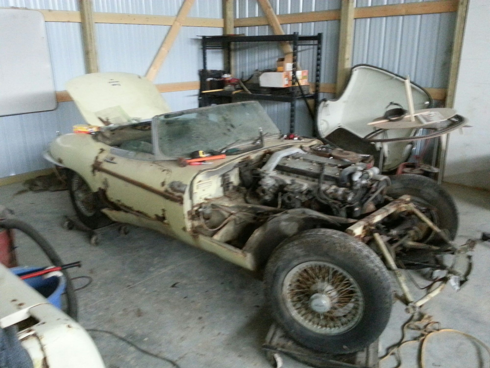

Hi Folks,
I'm the owner (sort of, I am actually the adopting father, banker, hopeful future caretaker) of this magnificent car that Craig and his shop of employ are working on.
Craig, SO GLAD you've posted on this remarkable site, great initiative on your behalf.
Let me just say, the car is gorgeous - even though still being assembled - and has been accepted into the Sante Fe Concours this September for it's national debut.
I am attempting to hunt down some of the other bits for the car (hardtop, OH PLEASE find me a hard top! wheels, other stuff) but am really trying to stay out of the way of their work.
So, just wanted to jump in here and issue support and thanks.
Very exciting stuff. The car is actually a very late Series 1, with toggles, 3 carbs, covered lights, 3.23 rear (originally Canadian we believe). Opalescent Silver blue/navy, complete body off/monocoque stripped rebuild over the last 2 years and counting.
