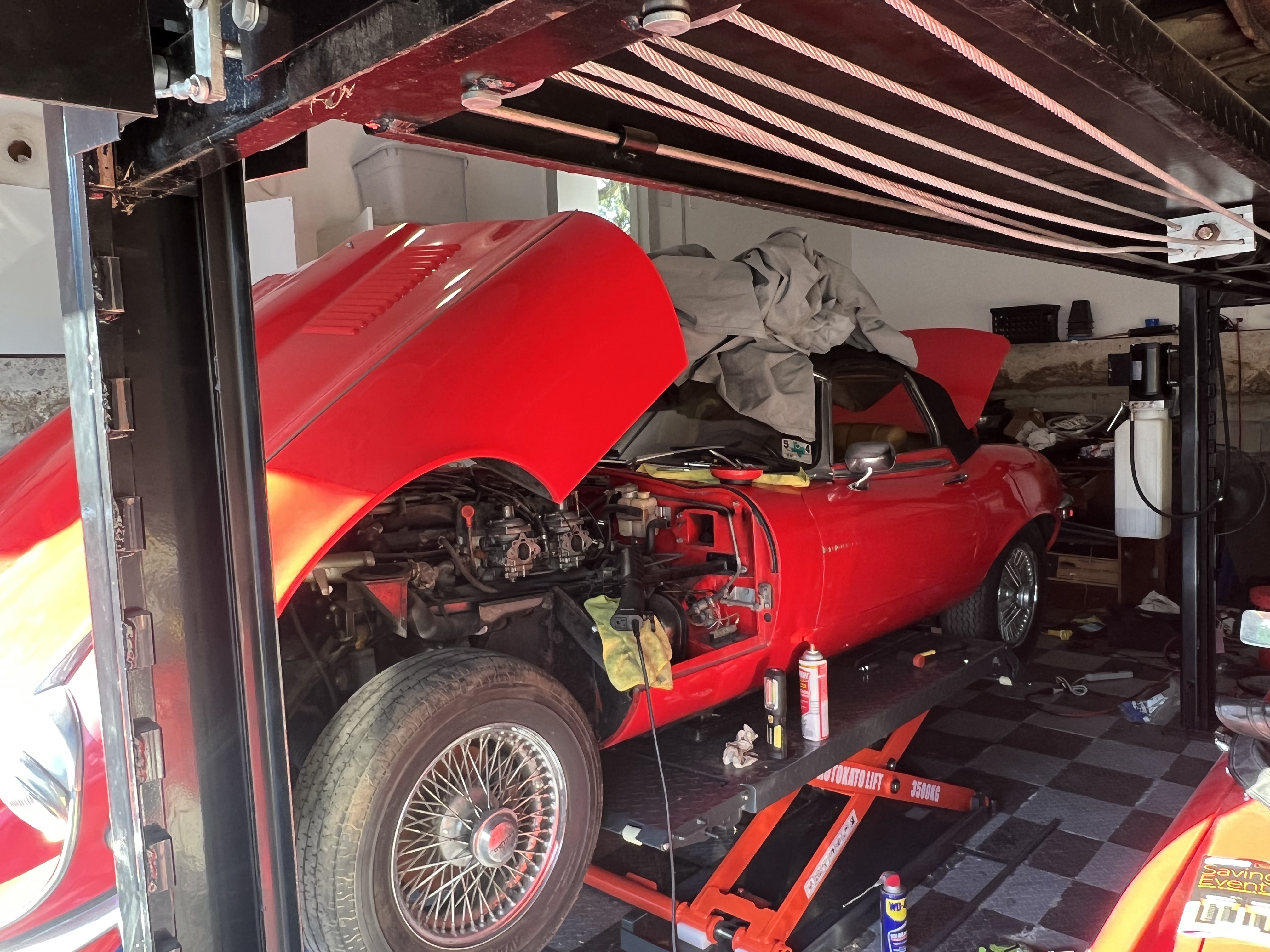

I too had a xke that had not been run in 25 years, The seller said the engine turns over ( with a wrench) I listened to all the advice, use this oil, replace fluids and belts, remove and clean carbs, and on and on................. All BAD ADVICE ! This is what I did, I took a bore scope (a skinny camera on a tube) and removed all the spark plugs first, by sticking the tube camera down the plug holes I could see that one of the exhaust valves was broken off and laying on top of the piston !! The person that turned-over the engine to make sure it wasn't seized had broken off that stuck valve without knowing it ! By taking the time to check the engine condition first, I avoided a MAJOR rebuild !!
Well i just did this exact job except min e has 29k miles now. It has taken me six months. Call Matt Meisner at Terry's jaguar. Tell him Edgar sent you.
1. take out the spark plugs and fill cylinders with Marvel mystery oil. Let sit for a week.
2. take out fuel tank and replace or have it restored.
3. replace fuel sender unit.
4. replace all filters and hoses and belts
5. Take out radiator and have it cleaned and rodded out or if necessary recored. Cheap aluminum units will not last.
6. replace brake and clutch master cylinders
7. Inspect pedal box most likely needs new return springs
8. rebuild carburetors. The rubber o rings and bypass valve gasket and in the starter box and the temperature compensator will leak and the car will not run correctly.
9.. Replace steel pipe portion of radiator piping they rusted from the inside and will leak soon after the car is running.
10. Remove and rebuild steering rack. It will be leaking. ADCO in Houston will do a great job for less.
11. Install SNG Barrett ignition conversion with new plug wires.
12.Probably will need to replace clutch slave cylinder.
13. Replace front and rear brake hoses and pray your calipers are not frozen. Probably will need to be repaired or replaced for safety reasons.
14.Check rear end. It leaks slowly and after 20 ears is probably empty.
15. Clean PCV screen and make sure vacuum hoses are property connected to carbs.
16. replace battery
17. Replace tires and tubes.
18 Highly likely you will need to replace front and rear shocks
19. Probably have to replace thermostats. It is likely the antifreeze turned to jello. You have to flush this out of the engine.
20. Spend two weeks finding all of the vacuum leaks.
21. replace carpet
22 Put on European bumpers.
