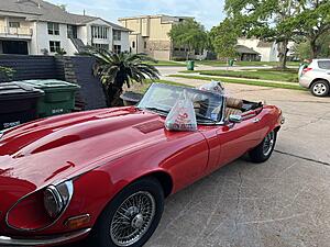

Well the inevitable has happened. I have revived my OTS after 20 years in storage. The rear calipers are now sticking. I assume it is the calipers. I have replaced the master cylinder. Is there any way to replace the calipers without removing the rear end? After everything else I have had to do on this car I am gaining courage on this major endeavor. They say do not be afraid to do the job, but there is a lot that can go wrong and if there is another fix i am open to that. PS I have a lift and am by myself.
