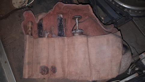

I've attached a copy of the tool set found in the trunk. It looks as though many of the tools match the original, but am unsure as to if it is indeed the tool kit that came with the vehicle. (A quick google search has led me to many different early Jag tool kits, so I am unsure.)
Thanks again and I'll keep you posted. 64 xk-e can't sit in storage forever!-reduced-photo.jpg

Robert,
It's true that several different tool rolls came with the E-Type. But given that this was in your family from new, there is a fair chance that this is the original. Good find. When you advertise this for sale, be sure and mention this as it is important to collectors.

I don't think that is an E-Type tool kit.
Here's the tool roll that my 1966 OTS left the factory with in 12/1965. The black surface of the roll has become brittle and cracked with age:
And here is my fully populated tool kit in a repro tool roll:
In addition, the remainder of the tool ensemble consists of a lube gun (which looks to be in your tool set), a Thor knock-off hammer, a jack bag, and the jack.
Many of the items can still be found, but at a price (don't ask how I know).
