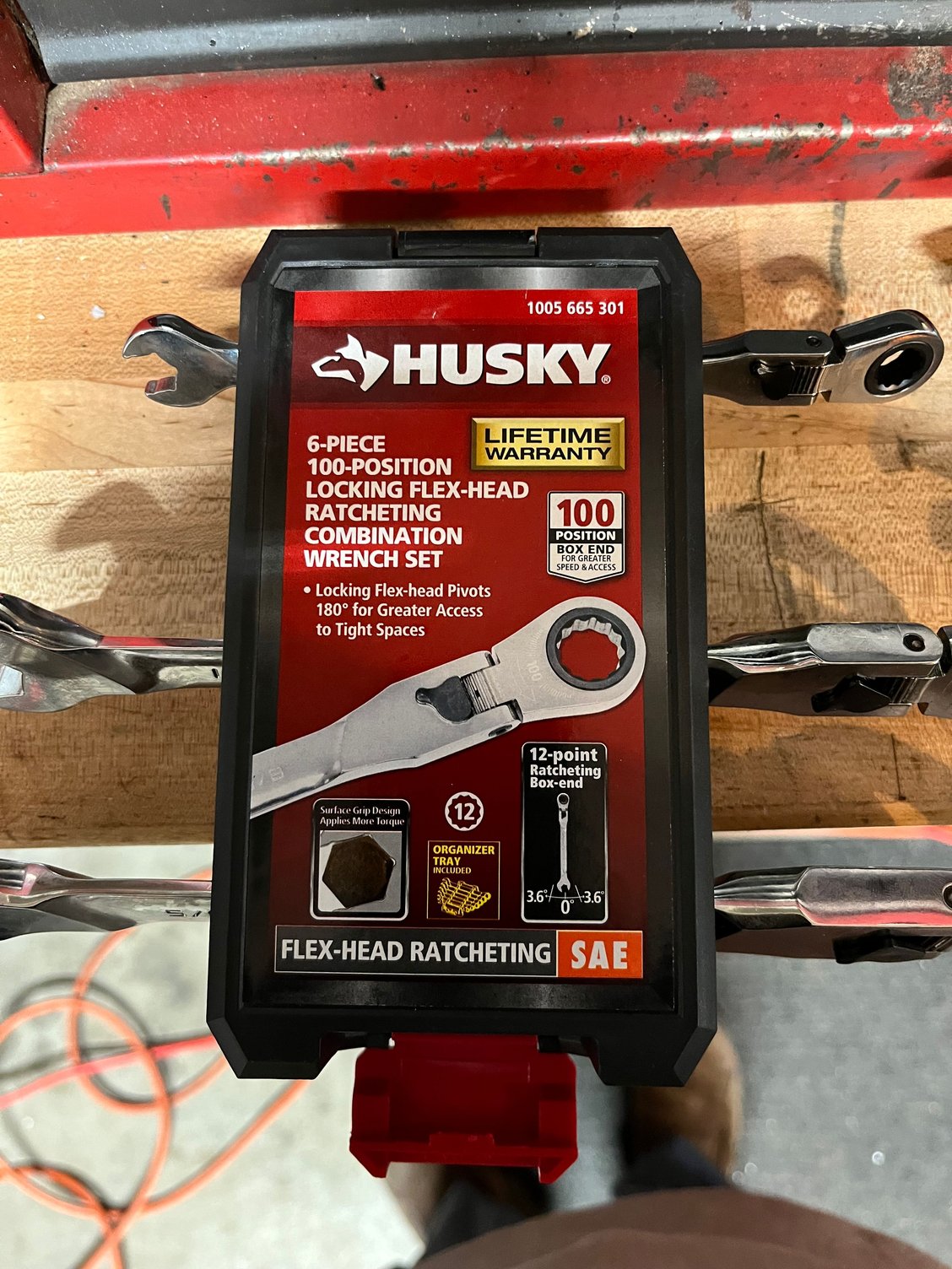

Default Bleeding rear brakes made easier
I found the best tool to get at the rear brake bleed fittings, with this tool you still need to remove the wheels but not the front shock! For purists, this means a big timesaver without altering the system. This tool will loosen or flip to tighten. It will fit easily like an upside down L then use a small adjustable wrench to turn the tool handle. Wow,
why didn't I think of this tool?? I would have earned enough money to hire a full time mechanic to maintain my E.!!
