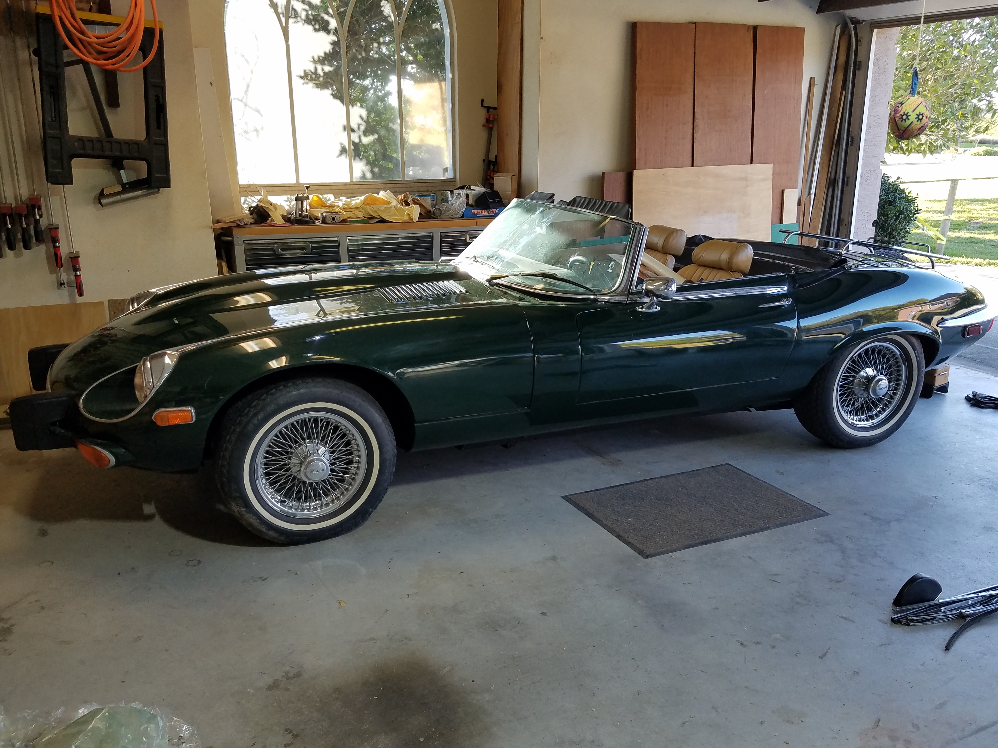

Old Mar 21, 2018 | 06:43 AM
1munro1's Avatar
Joined: Mar 2018
Posts: 8
From: New York
Default 1974 XKE Pic
Here is the car as it sits today. I am slowly inspecting and repairing the car. The fuel system is pretty bad after sitting for 20 years. Pulled the fuel tank to clean it and found a rust hole in one side. The sending unit is shot. Changed the fuel filter. Brake lines are good. I am about to test the pump. I rebuilt the brake master cylinder. Next I will pull the calipers and rebuild them. Then the servo. The heater box is in fair shape with one rust hole. Fan and motor are in surprisingly good shape. I want to document the process as it progresses. Hopefully others are interested even if it has a Chevy small block in it. The previous owner did a great job on the conversion but did not complete it. Thus the question on what is the best course of action. I don't know the condition of the engine. I have a Chevy expert taking a look at it in the next few weeks. I will post some interior pictures soon.
