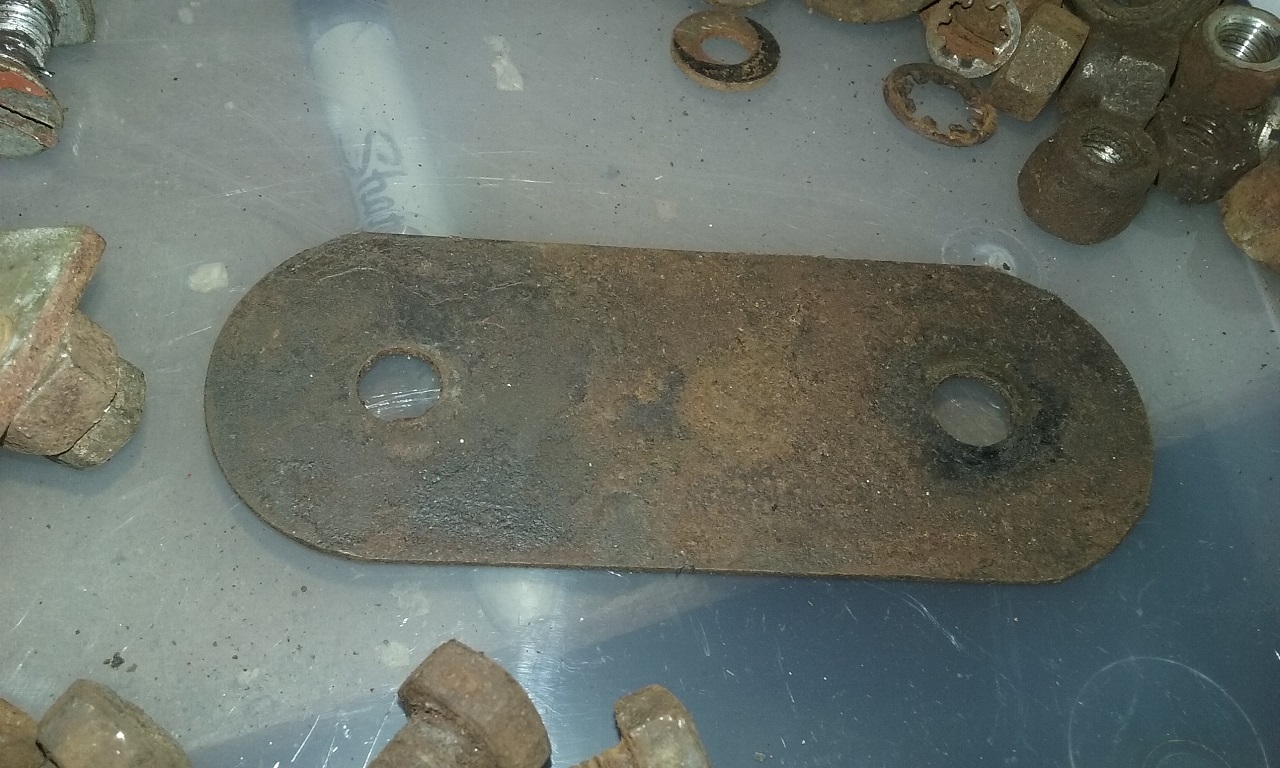

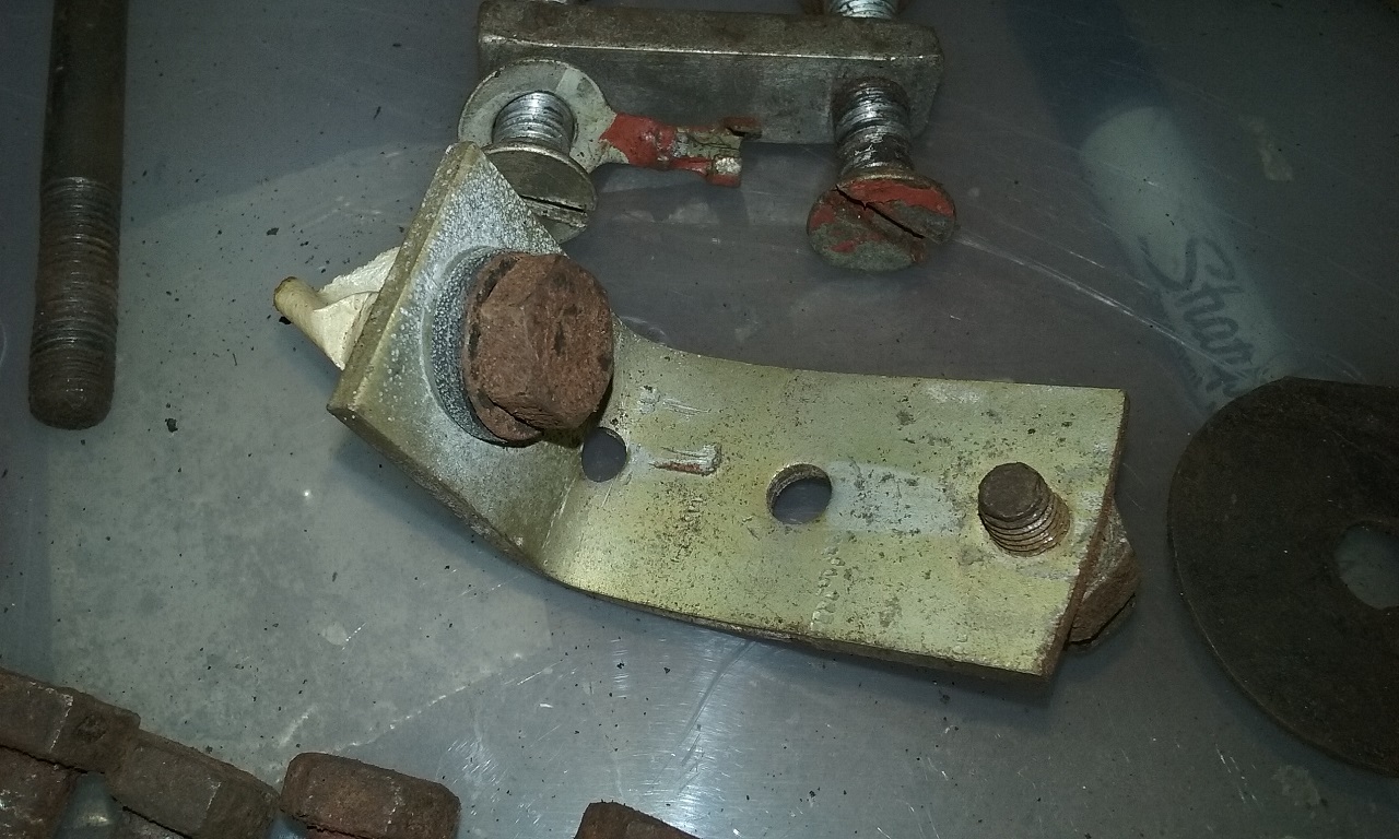

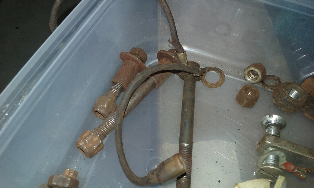

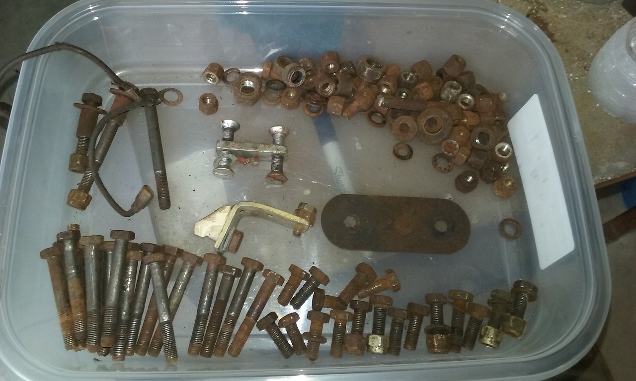

Default bolts n brackets and things ID help
this is the first large bag o bolts. After looking at the parts manual I think bolts are ID'd enough that I can pick the correct size bolt and nut from a pile. But the brackets I will have quite a search. It would be great if the members here could ID the subsystem each of these brackets belongs to so I can kit up the brackets and bolts for the next guy. thanx in advance.

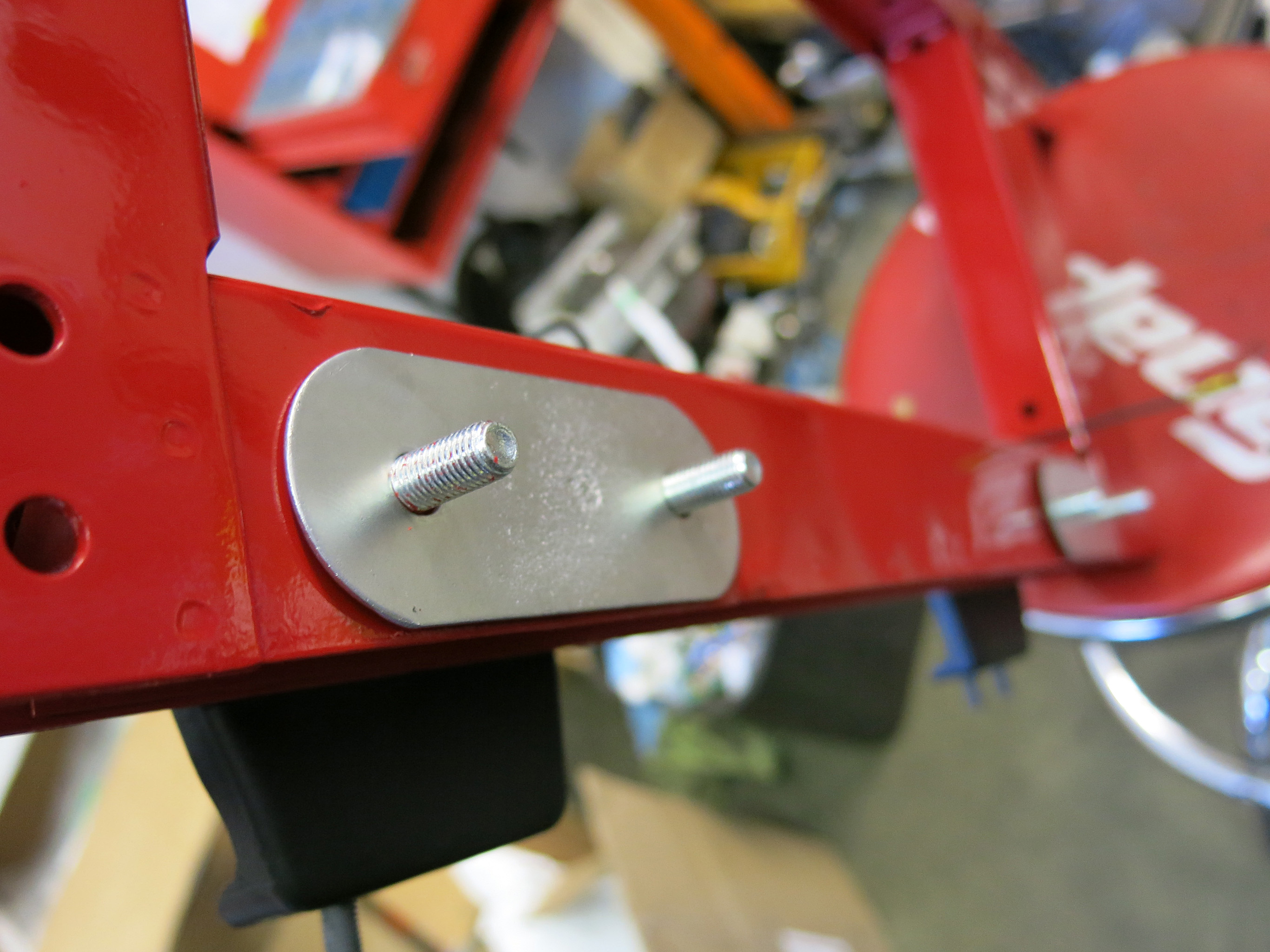

looks like this is the front subframe bolt set. the flat oval with 2 holes goes between the engine frame and the picture frame. I will need to find the second one in the pile. still dont know where the gold bracket goes. picture is from here
