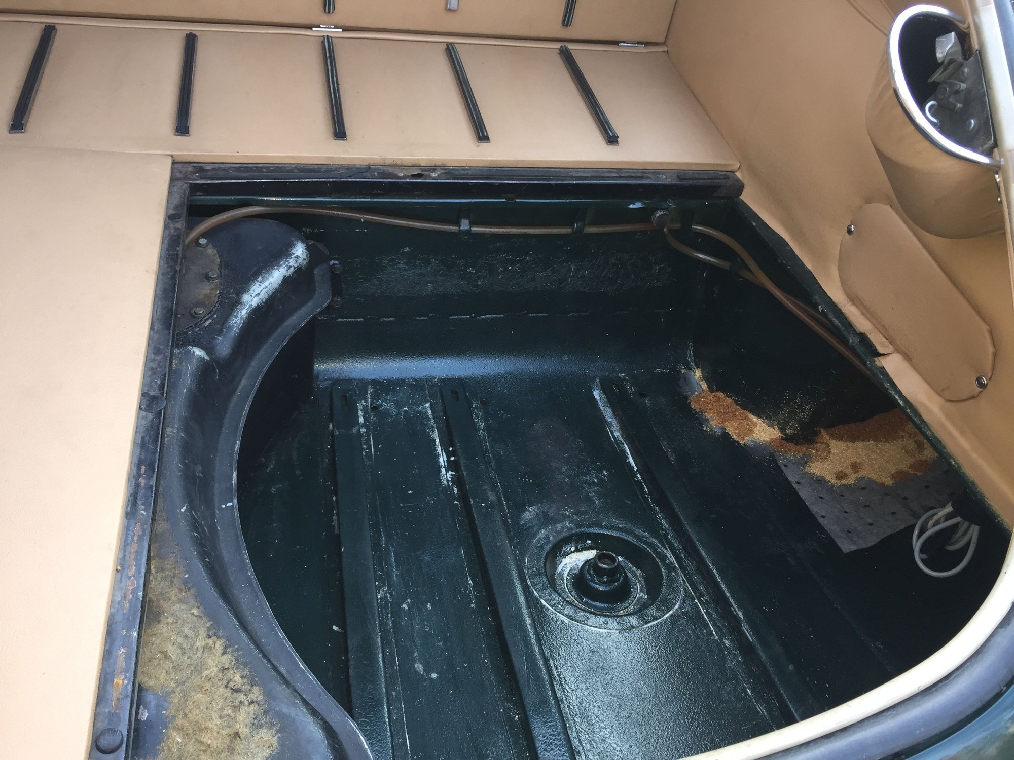

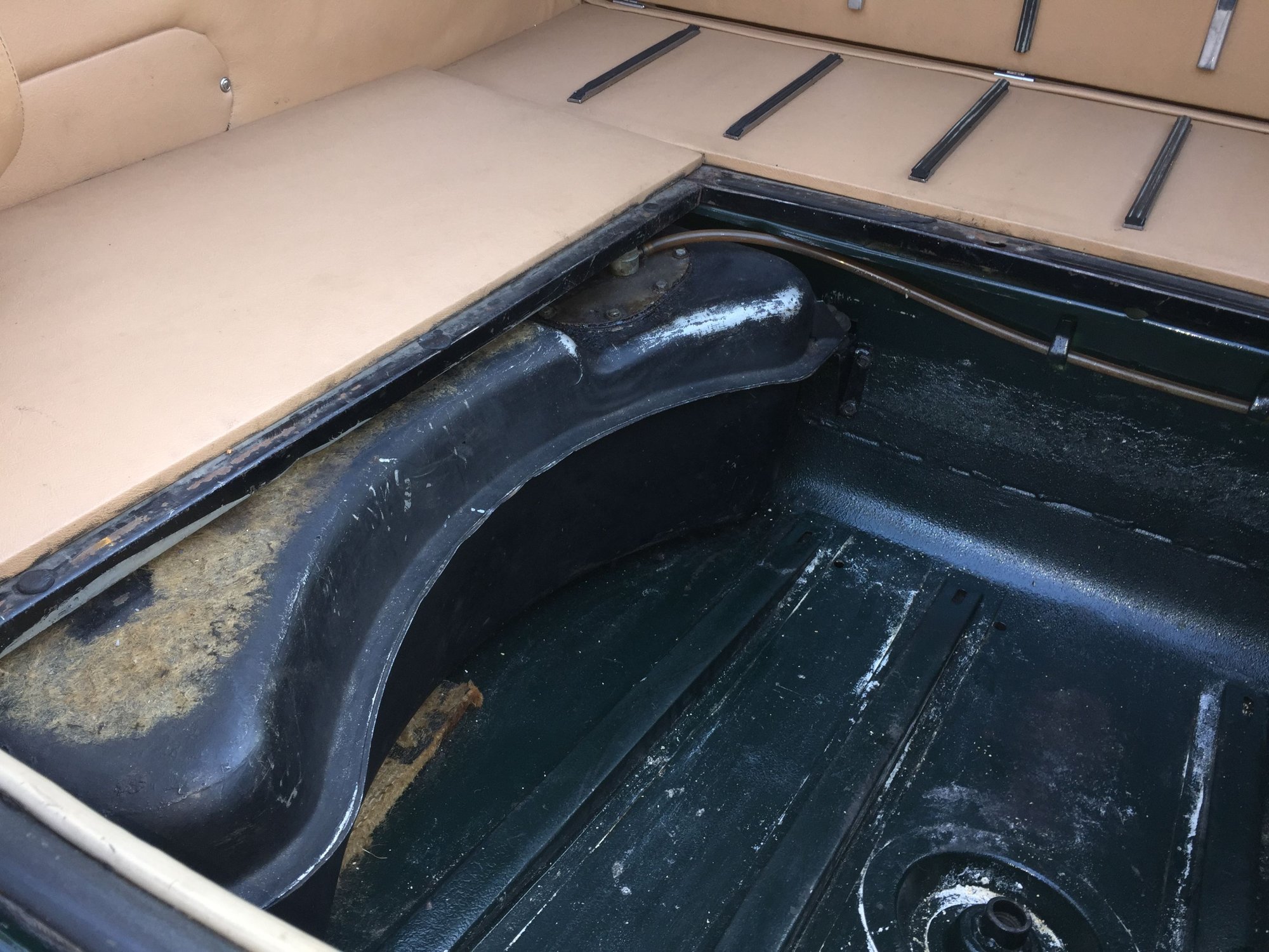

Thank you and apologies about not being clear. The car is a 69 SII FHC. Today I put absorbent powder along where I saw evidence of gas. The pics below are the result after taking the car for a brief drive. I didn’t and haven’t seen any evidence fuel near the gas tank on the opposite side. I also checked the fuel pump under that removable flap, it wasn’t wet, but I’m wondering if it’s the seal going out from the pump dripping slow along the length of the line until gravity takes over and it falls into the trunk pan?

Here's a suggestion. Remove the power lead from the coil and remove the 3 wire cable to the voltage regulator. Now if you turn the key to the on (not start) position the fuel pump should pressurize everything and perhaps you can see the drip, Good luck.

First off, stop driving the car. You can inspect the fuel pump by removing the oval panel. My bet is that one of those old fuel lines is ruptured, but you have to stop driving and use your eyes and hands to locate the leak.

My guess is that you have a slow leak at the pump to its connections, or there is a small crack or pin hole on one of the fuel lines.
Pressurize the system as described by billb44 and look for the source of the leak.
