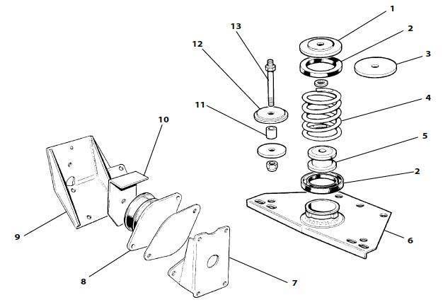

#2 ( 2ea), & #5 are usually eaten up by oil. The spring #4 is tired after 40-50 years.... all available. Support Transmission, then put bottle jack under # 6 and remove bolts. Put two long (temp) bolts with heads cut off to align #6 plate when you are going back together.

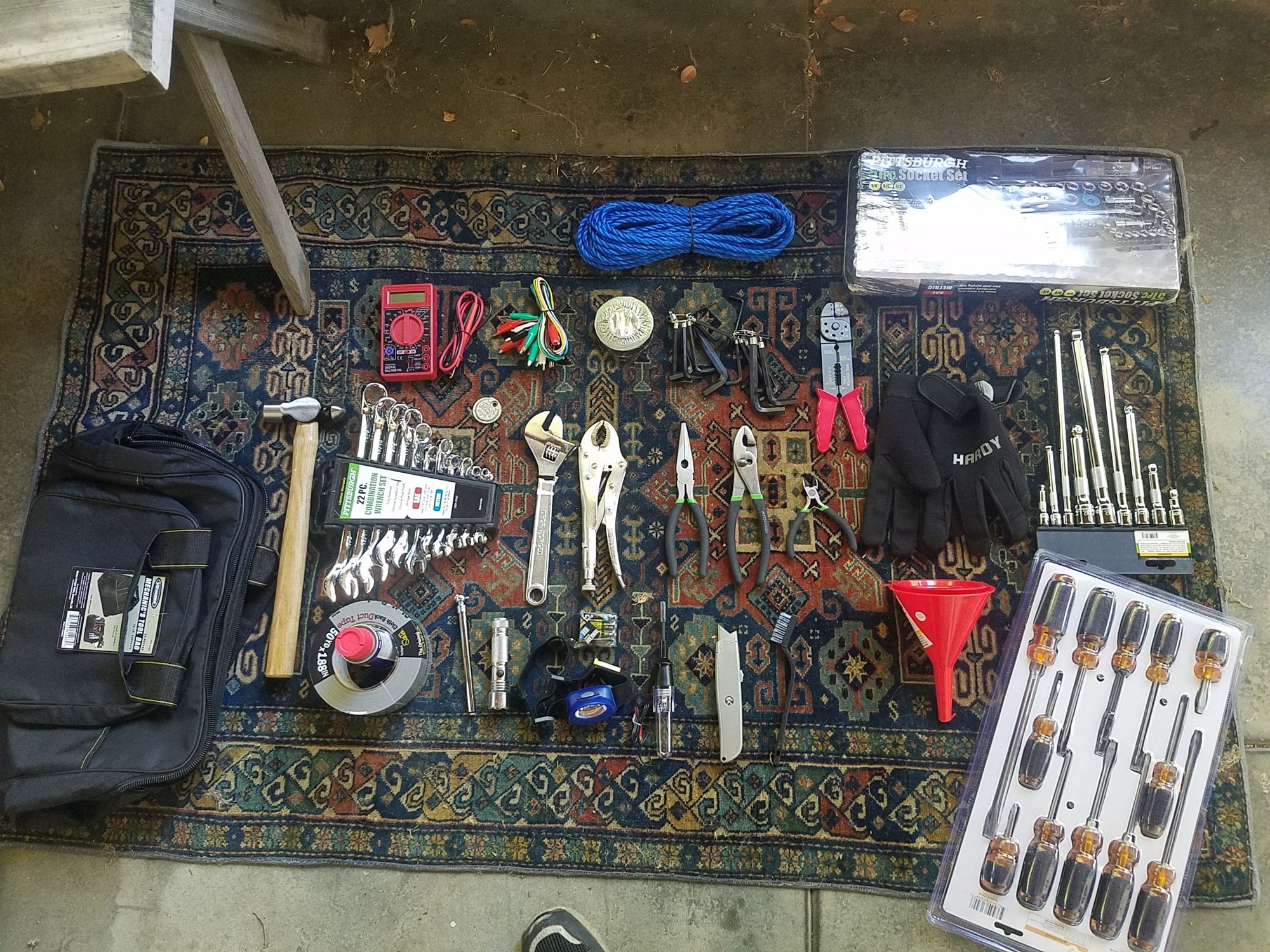

Also, I went on a shopping spree at Harbor Freight and put together a rather complete tool bag. It's probably Overkill but I don't care. 25 lb of tools in a car won't make much of a difference in performance.
