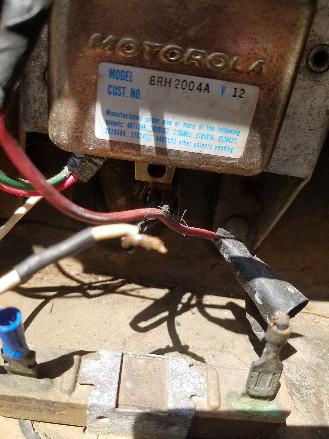

I unscrewed the Motorola voltage regulator from the car and saw that it is not adjustable from the outside. A check the voltage at the B+ terminal of the alternator and compared it to the battery and it's very close, only about a two or three tenths of a volt drop. It seems that the alternator is at about 11.7 volts at idle but just off idle it raises up to normal. What would cause the alternator to be low at idle?

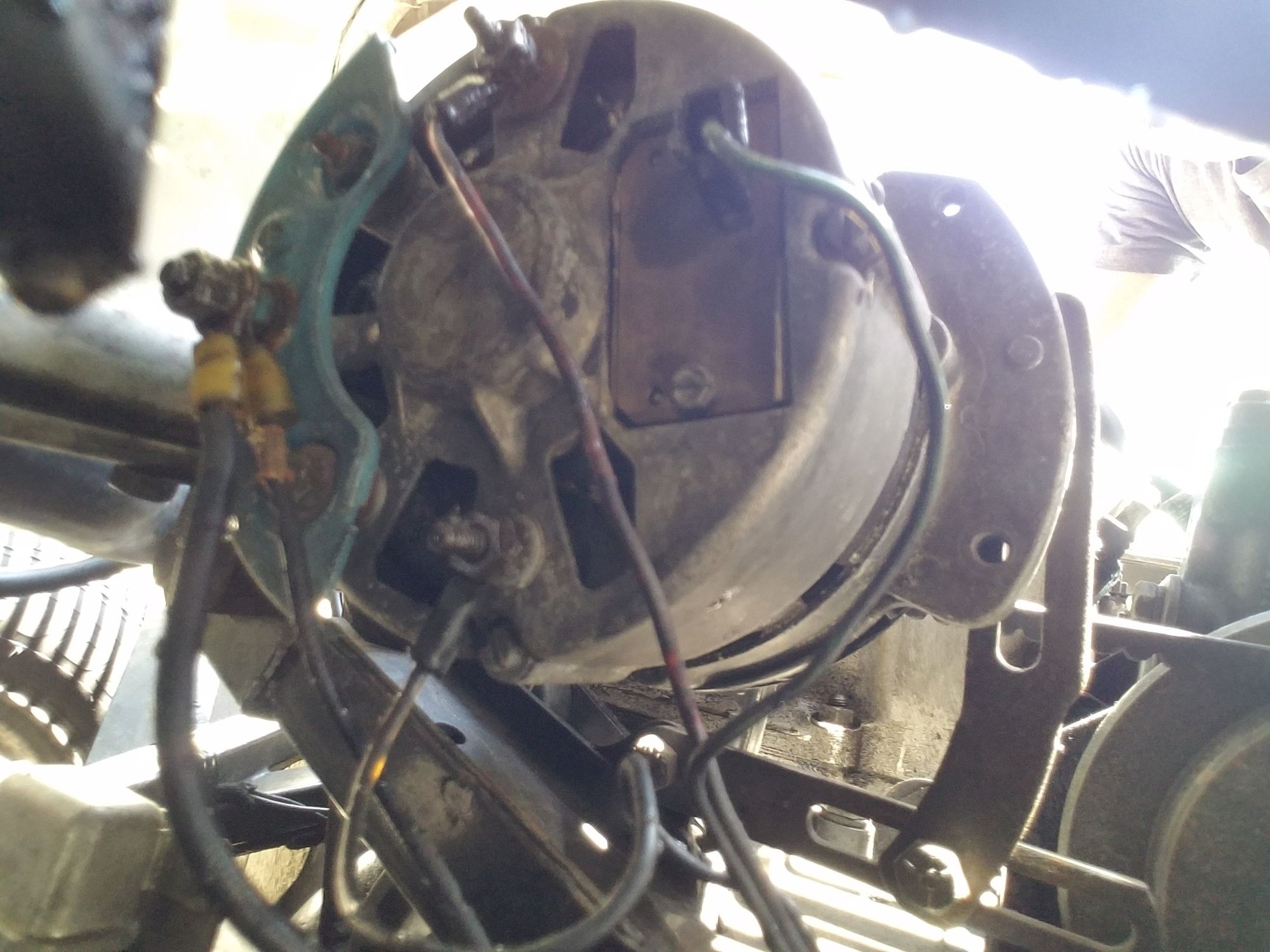

My father replaced the original alternator and voltage regulator sometime in the late sixties or early seventies. Can anyone identify the alternator?

It will be easier to identify if you show the back of the alternator where the leads connect
Ok. Ill get a picture when the rains quits.

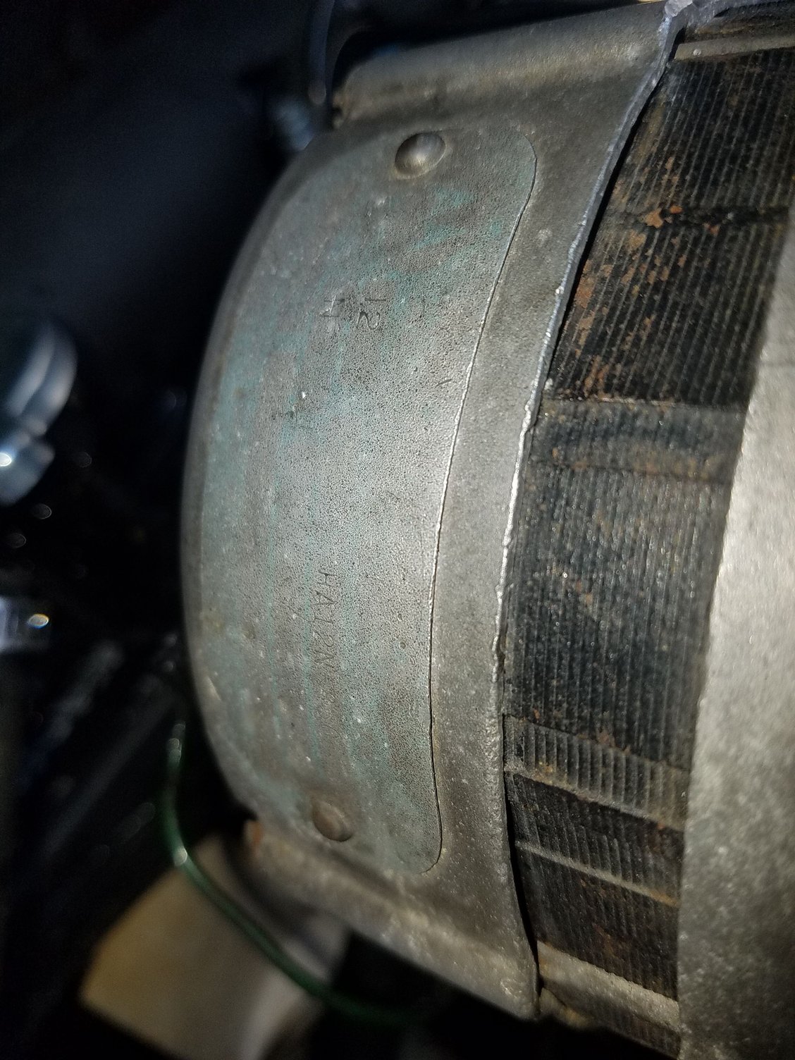

I did some research on some of the old receipts in my father's records and determined that the alternator is a Motorola alternator. If I can read the tag on the top, I should be able to determine the output of the alternator. I should have gotten pictures yesterday when the weather was nice but I was replacing the rear differential oil.

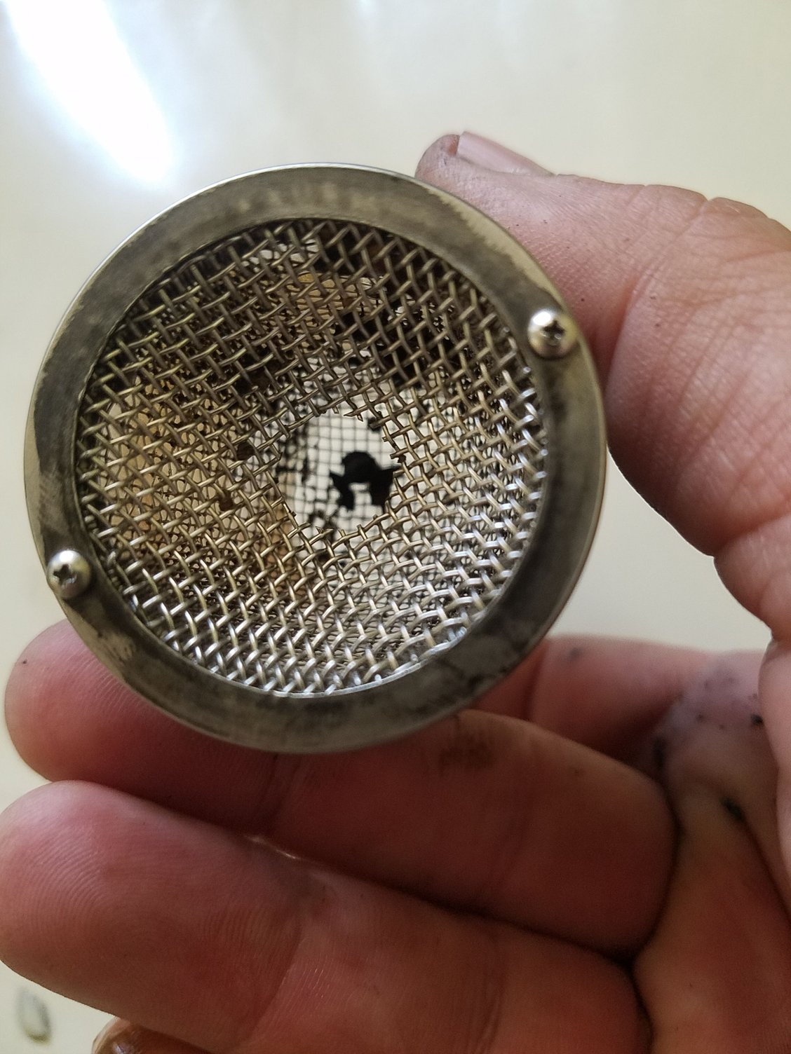

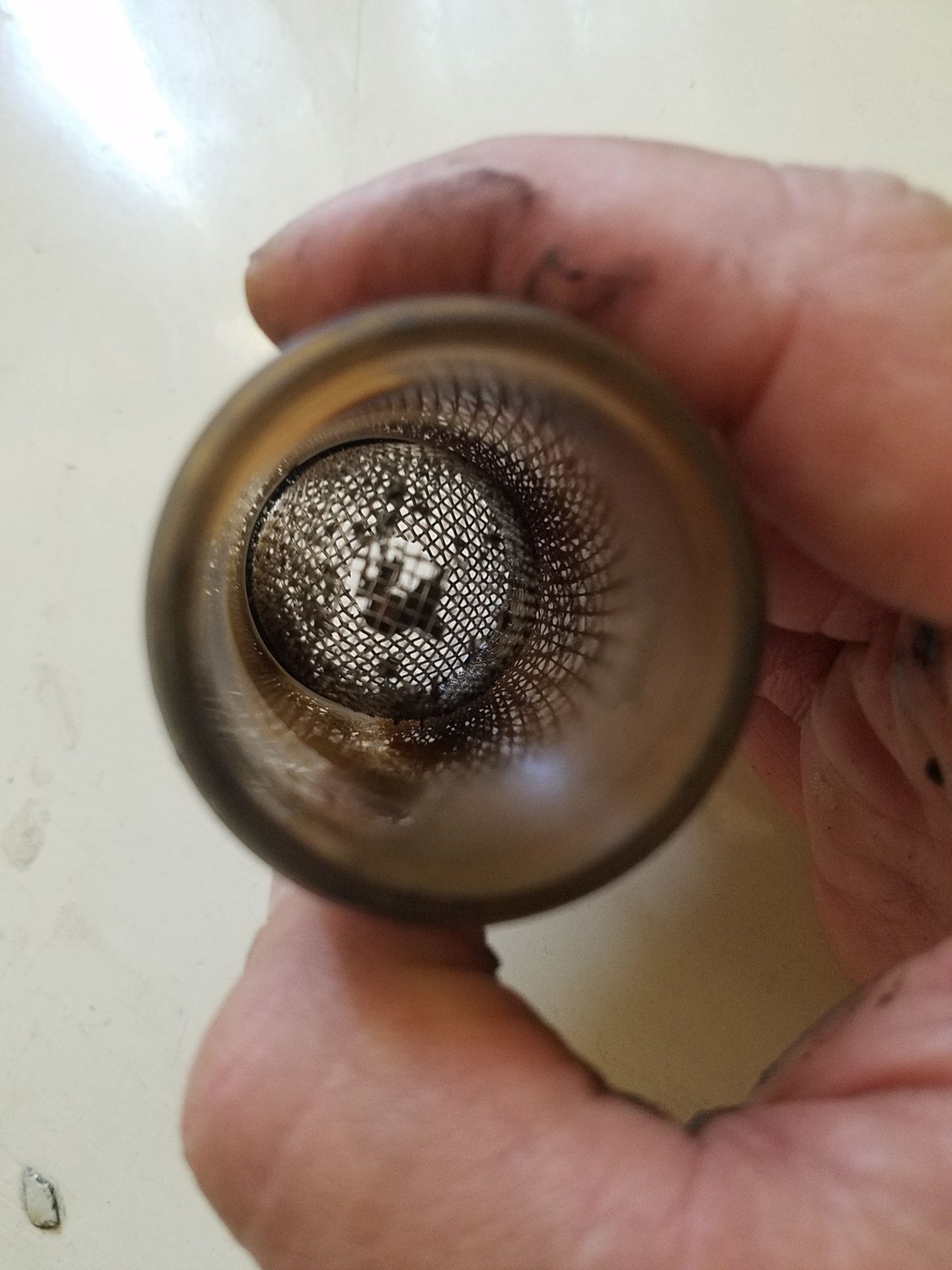

The beautiful weather here in Southern California allowed me to get some things done with the car. I drained the water and it actually looks pretty clear finally after the thermocure anti-rust treatment. I checked the clear Gano coolant filter that I installed in the upper radiator hose. It look kind of Cloudy so I remove the upper radiator hose and removed the coolant filter. It had a lot of dark bits in it and the sides were coated with rust.
It took a bit of work but I backflushed the filter to get all the bits out and I cleaned the rust coating on the inside of the filter so I could see through it. I use the Q-tip too try to clean down next to the filter but it would only go so far. I'm so pleased that I discovered this filter and used it because it clearly works. I think anyone with an older car that has ever had and unmaintained cooling system should have one of these in the system. It's cheap insurance.
The pictures below show some of the bits but it doesn't do it justice because there were a lot more bits in the filter but couldn't be seen in a picture. I would say I've driven the car somewhere around 200 miles since I installed the filter. I'll be curious to see if any more bits get knocked loose after another few hundred miles.

The alternator is a Motorola HA12N-850.

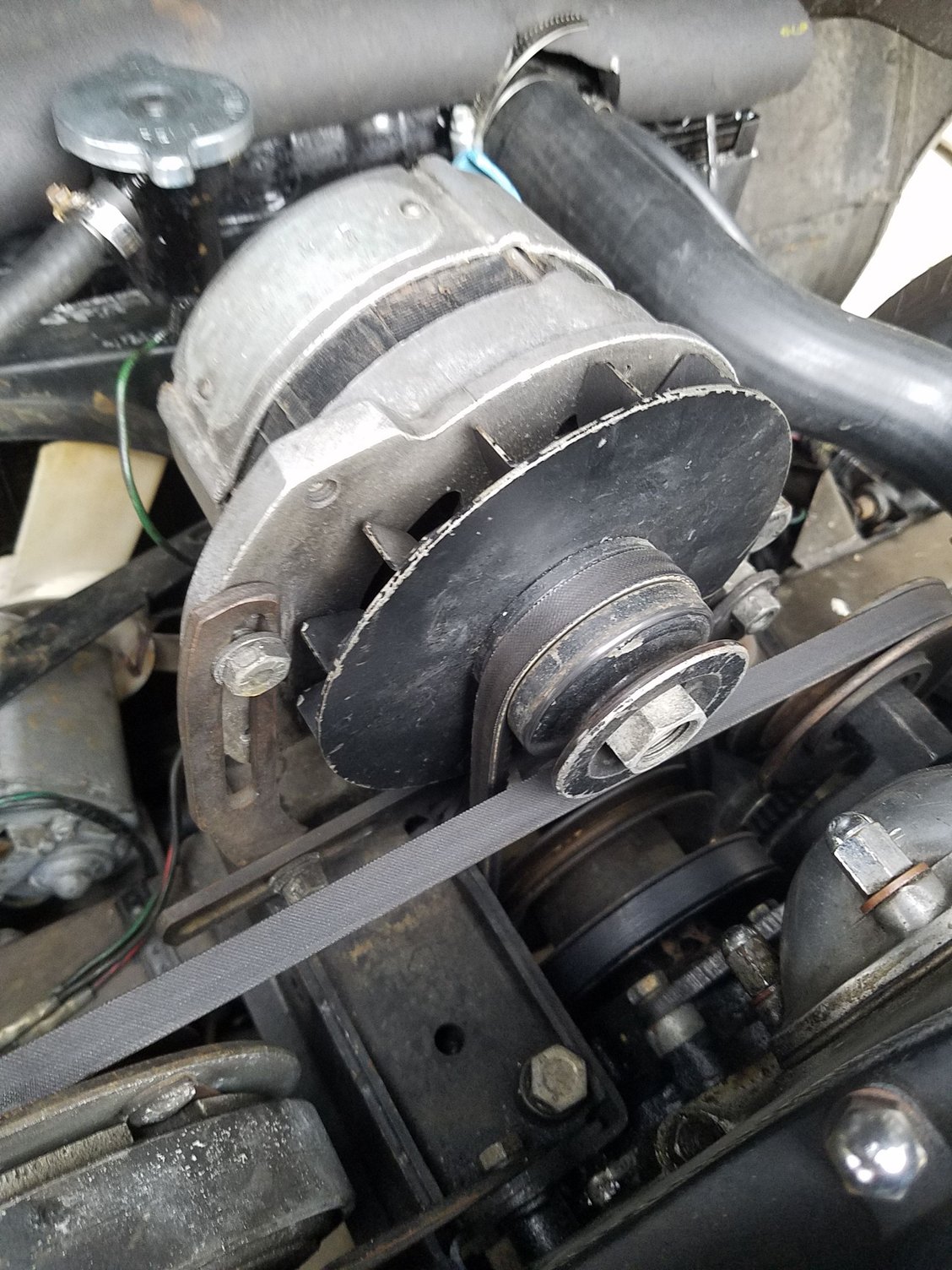

I was trying to accept that the charging system on the car was fine when driving but unacceptable at idle, but overall, barely acceptable. But after reading about alternator upgrades, I decided to pull the trigger and go with a more modern integrated system. There is a local alternator shop and I brought them my Motorola alternator. They found a Delco alternator that was similar in mounting and did a bit of customization so that the mounting would be exactly like the Motorola one that I have. It is 80 amps which seems pretty good for our cars. Anything more is just a waste for a factory E-Type. In retrospect I could probably have gone for a 60 or 65 amp alternator but I wanted a bit of cushion. The wire from my alternator to the battery looks like about 8 or 10 gauge which should be adequate.
I installed the alternator and got a slightly longer belt. After running the car, I was disappointed because it's still doing the same thing as the old alternator. At idle the charging system drops very low and then it goes High when the RPMs are above 2500. I did notice that it seems to be more solid when driving than the old system. In other words that seems just a little bit higher.
One possible answer is that the water pump belt is slipping causing the alternator belt to slip on the water pump pulley itself. I can rotate the water pump pulley by hand without the water pump to crankshaft pulley belt turning. There is a belt tensioner that holds the water pump to crankshaft pulley belt on. I believe this is different than the series 1 System. I suspect either the tensioner is bad or oil is getting on the belt and the pulleys from a leak in either the valve cover gasket or the timing chain cover gasket. Does anyone have any thoughts on this?

Sounds like you've found the problem. It should not be easy to turn any of the pulley wheels driven by the belt. Has the belt been replaced ? Has the tensioner been checked ? How does the belt "feel" when you give it a waggle, reasonably tight or seems loose ?
I replace the belt last year so it's fairly fresh. I have not checked the tensioner but I'm not sure what I would do to check it. Clearly it applies tension to the Belt but the question is how much tension is it supposed to apply? Would a slightly smaller belt put more tension on the tensioner? The belt actually seems fairly tight but I also notice oil on the crankshaft pulley and that's where it's slipping. My thoughts are to take the front part of the engine off, meaning the alternator, the belts, and the brackets, and then clean everything up and see if I can get the belt to stay on there nice and tight. Again, wondering if a smaller belt would the tighter than a larger belt? Does the tensioner have an adjustment? My guess is probably not because it's probably just a spring.

I don't think the tensioner is adjustable, but the installation process may involve setting the belt to a specifed tightness with the tensioner "locked" in some way, then when its all set up, the tensioner is released. However, my Jaguar Mark 2 s never had a belt tensioner. Might be worth having a look here: -
