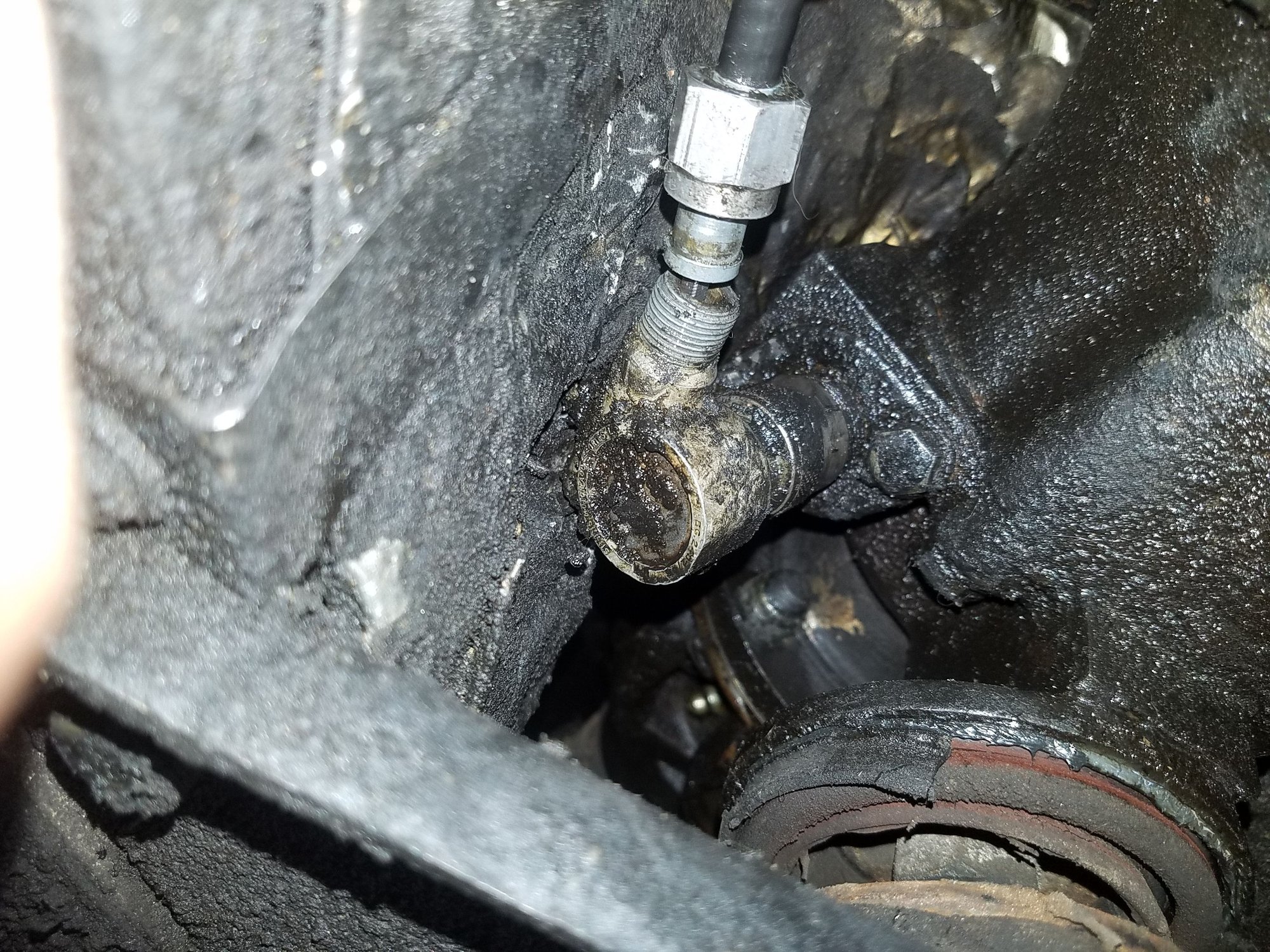

Thank you for the information. I tried to center the inner cable but to no avail. I tried using the new inner cable and the original inner cable and got the same result. I will climb under the car and take a look and see how hard it will be to get to the angle Drive.

The speedometer cable was pretty easy to get off the angle drive and the angle drive also wasn't too difficult to remove. Nothing was in the way. Check out the picture. In the automatic it is located on the right side of the car.
I think it was bad but Im not certain. Anyway, even though it is expensive, I'm going to replace it. Hopefully the speedometer should provide many more miles without a problem.

I had an interesting turn of events. I went to my local Jaguar parts place to buy an angle drive but he didn't have it in stock and had to order it. I figured I would put my old angle drive back in, and just for the heck of it, I hooked up my old speedometer cable. Then I backed the car up the speedometer cable was turning perfectly fine. When I went forward the speedometer cable was also working fine. On a hunch, I installed the speedometer and hooked up the cable ( easier said than done). When I drove the car, the speedometer and odometer worked perfectly smoothly. I have driven it about 60 Mi and the speedometer works perfectly. Here is what I think happened. In order to remove the speedometer angle drive from the transmission, after you disconnect the cable, there is a collar that moves up and down as you loosen it from the transmission. In retrospect, when I was removing it from the car, it seemed that the caller had backed out over the many years and was barely screwed onto the transmission but was pretty much held there by all the gunk that built up. I didn't have to turn the color much in order to remove it from the transmission. But when I reinstalled it on the transmission, I was turning it and turning it and turning it until it tightened. So the angle Drive was good, but it just wasn't screwed all the way into the transmission. Now what I'm curious about is if there is supposed to be a little bit of slippage on the angle drive because I could make it slip when I had it out of the car and I inserted a screwdriver to where the cable would normally go and held on to the other end. I could make it slip but it took quite a bit of effort. Anyway if it fails in the future, then I will know to replace the angle drive and I will know how to do it.
