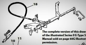

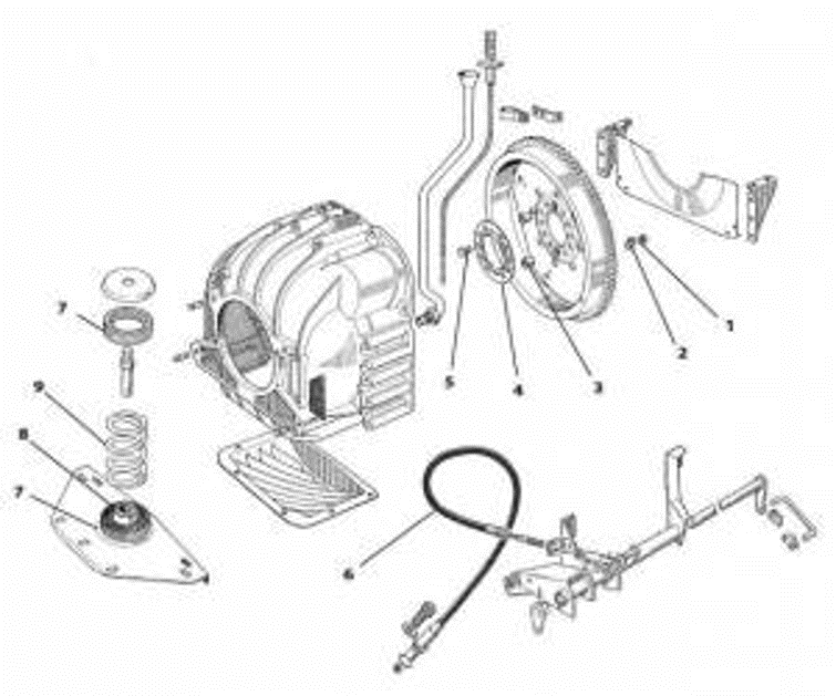

Borg-Warner Automatic Transmission Kick Down Cable C26756/3 Borg-Warner 8 Transmission. $76.99 ( #6 )
The adjustment for the cable is where it attaches to the throttle brackets behind carbs. To Remove: With all linkage to carb throttle levers hooked up, measure the exposed cable between end fitting and cable housing ( I just cut length of 1/8"vacuum tubing to exact length, then slit length-wise and slip on the new cable). Remove clevis pin, remove nut holding cable housing to bracket and pull cable out. From the side of transmission un-screw cable assembly pull cable end out ... install new cable into transmission, route new cable up to throttle brackets insert cable housing into bracket and install nut. With all linkage to carb throttle levers hooked up, adjust nut and housing to get a slip fit with the clevis pin thru the cable end fitting and the linkage lever (then remove rubber tubing from cable), Carbs should be on idle stops.
This should give you 3 gear... There is a road test in the Maintenance Manual to see at what speed first to second and second to third shifts occur with light throttle... if these are off, then they tell you to adjust the cable in or out to get the shift points correct.
If you are still getting stiff throttle with the new cable, then problem could be in transmission....at this point, I would just add custom return springs to the throttle linkage to over come stiffness.

This picture is ~~ clearer:
The cable assy housing grove for mounting in the small bracket that fits to bigger bracket. Once you have cable measurement you can remove clevis pin, then unscrew end fitting, then unscrew jamb nut and pull cable out. I know there is not much room to work. I had the whole kick-down assy removed from cylinder head when I fiddled with this. Took me three road tests to get kick-down speeds correct, half turn at a time. Once you have new cable it will be easier to figure how best to work in the small area.

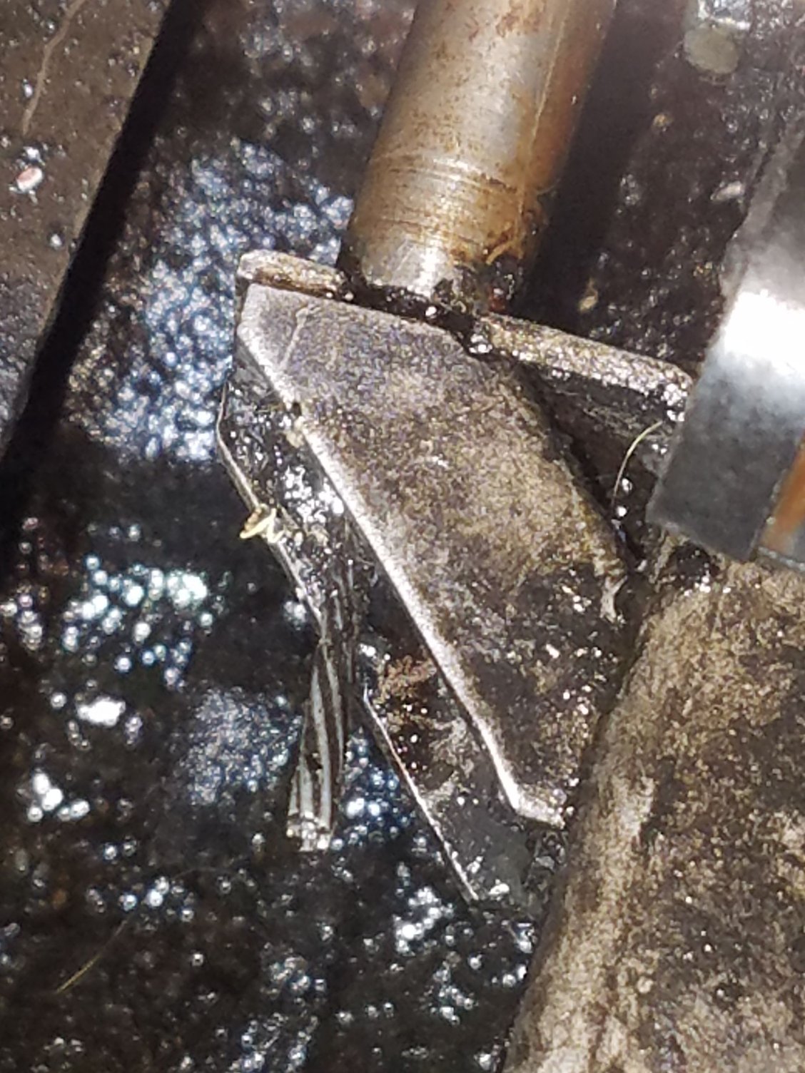

The cable broke at the carburetor end of the cable. The end piece of the cable is still attached but I'm trying to figure out how to remove the cable from the bracket which is attached to the Head. The cable looks like it has a Groove in it but it can't go up because of the shape of the bracket I don't know how to remove that cable housing from the bracket. Also at the other end of the cable, I removed the nut that holds down that part of the cable housing but does the cable housing just lift out of the transmission. There doesn't seem to be any clearer instructions. My brother is trying to help me also although he's not here. I take pictures and he used to work on the car so we are both familiar with it

Bill,
Yes the cable housing pulls out of transmission, seal may be holding it. Angle bracket needs to be loosened from larger bracket.... my assy was off as well as manifold off, so don't remember any issue. Since cable is broken, put cable in vice and count the number of turns the forked end fitting takes to be removed, use same number of turns when re-assembling to get good stating point for correct cable length.
