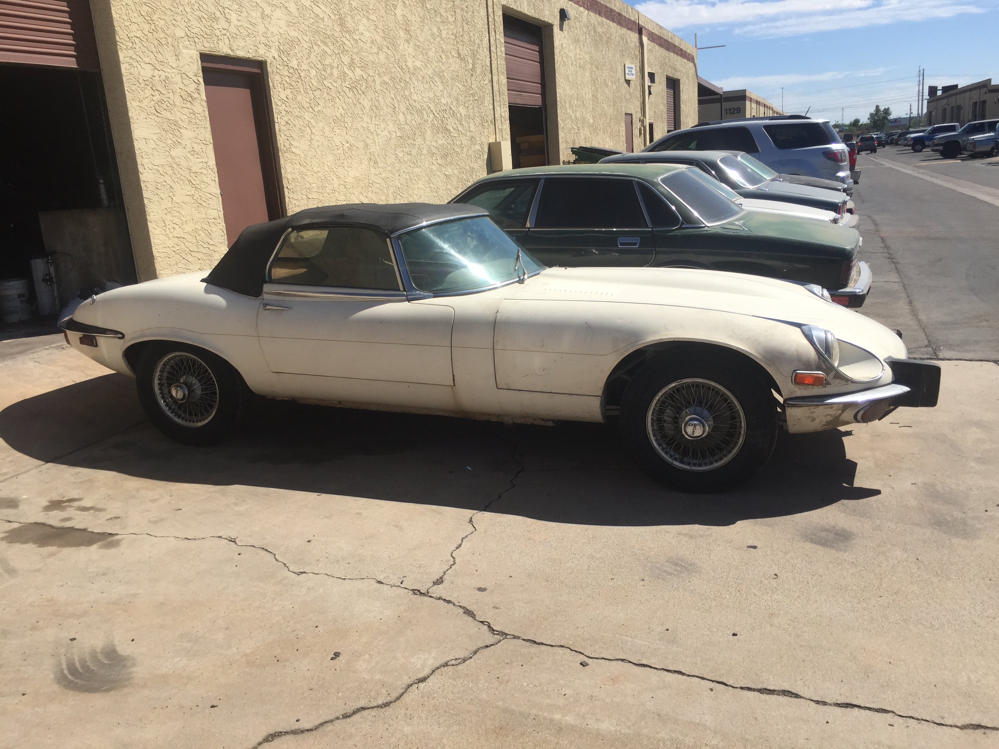

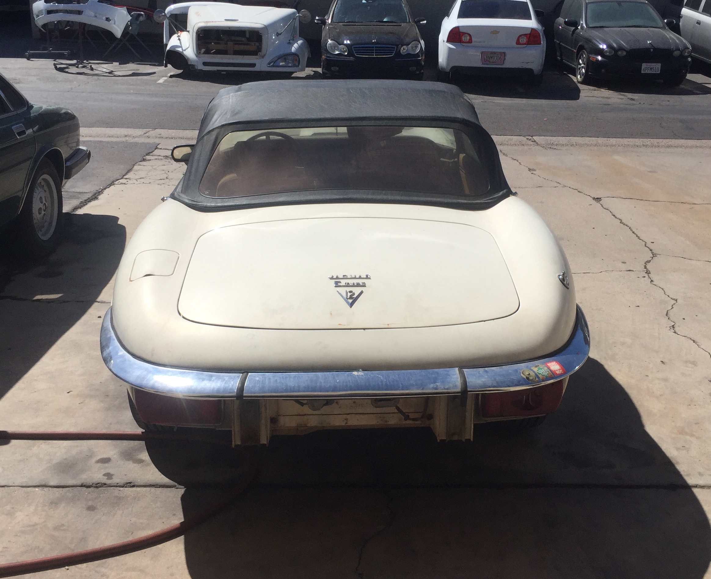

I bought this XKE in 1974. It was driven as one of my two primary car from 1975 until 1979. It has been in storage since 1979. Most of the storage time it was in a temperature controlled environment with a mechanic with many excuses. The motor was never properly drain nor was it properly covered. Two months ago I finally got the car moved to a different mechanic. Below are pictures of the car and some progress pictures on restoration project .I have a feeling this is going to be a long and expensive restoration. The body of the car has no rust and the interior is in good condition.

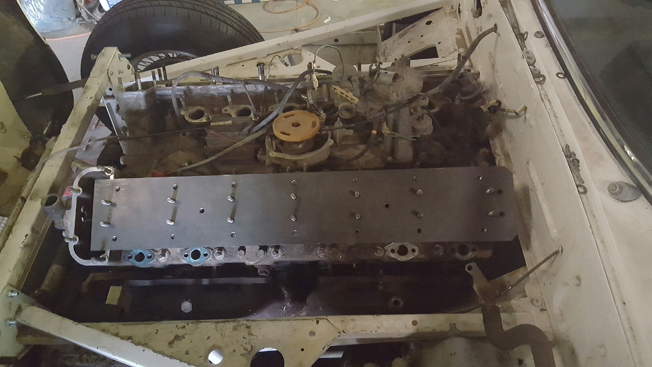

Well, the first of two heads ready to be removed.

The Merida Style plate that Dr Quail provided did its job. The first head is off without problems.

You may know this already, (apologies if you do !), but don't turn the engine over with the heads off unless you have installed the cylinder liner clamps. If you do this the liners may move up and the seal with the block broken. Also don't turn the engine over in the reverse direction as you will break the chain tensioner.

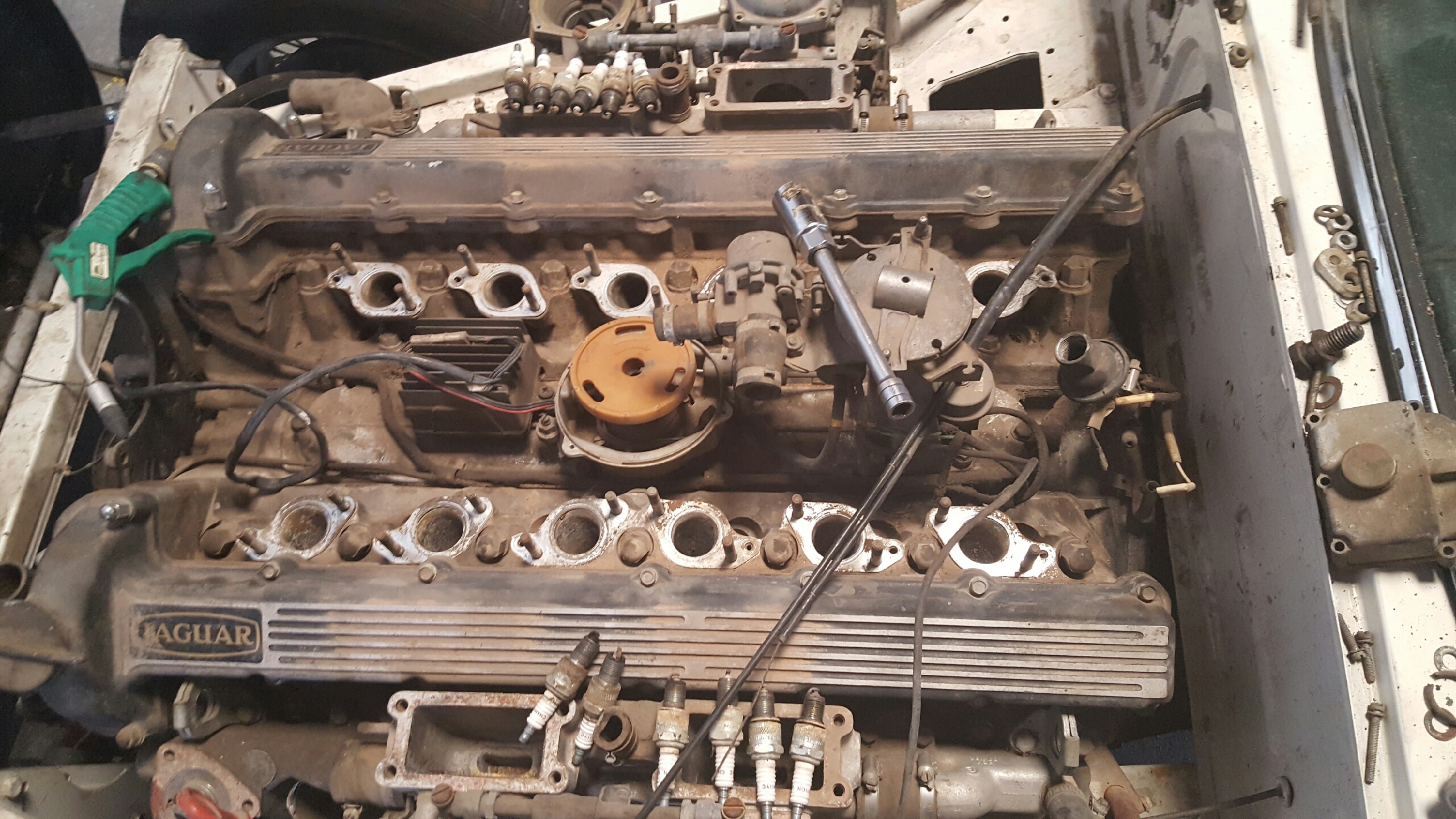

Thanks for the information Fraser. I sent a copy of your post to my mechanic. He has never worked on a Jaguar. Any information that anyone wants to share would be appreciated. He went to mechanical school and has only done 1940-1960s Ford and Chevrolet restorations in the past. He currently has the timing chains anchored. The second head has been removed and he is cleaning the cylinders. Six cylinder have significant rust.

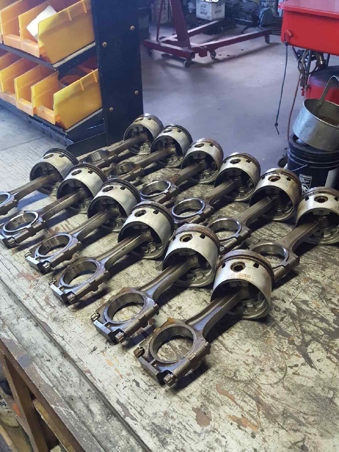

Disassembly is still in slow progress.

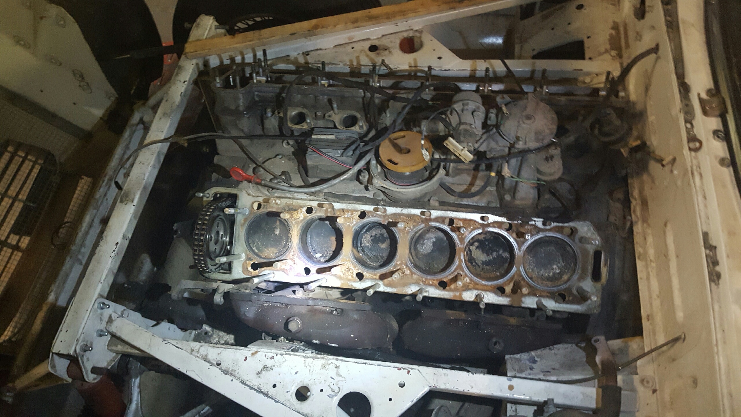

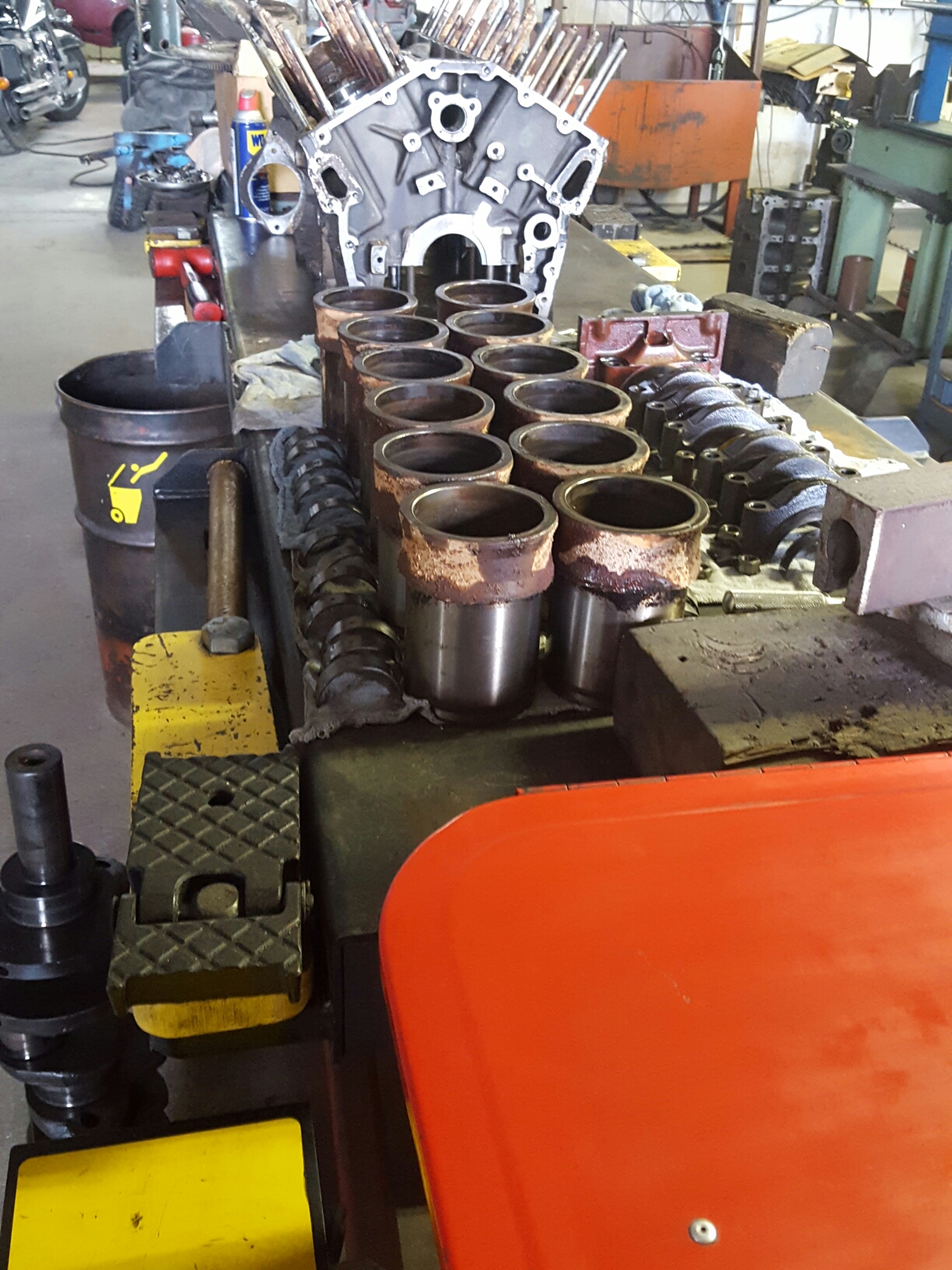

Starting to get to the end point of dissembling motor with cylinder liners out today. Hope to insert new cylinders liners and new 9:1 pistons this week or next.

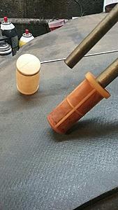

I believe that the mechanic started installing new brake pipe last week. Part of mine had been stolen. Received my 4 carburetors that were rebuilt by Joe C. Still several months before they go on. Here are two of them.

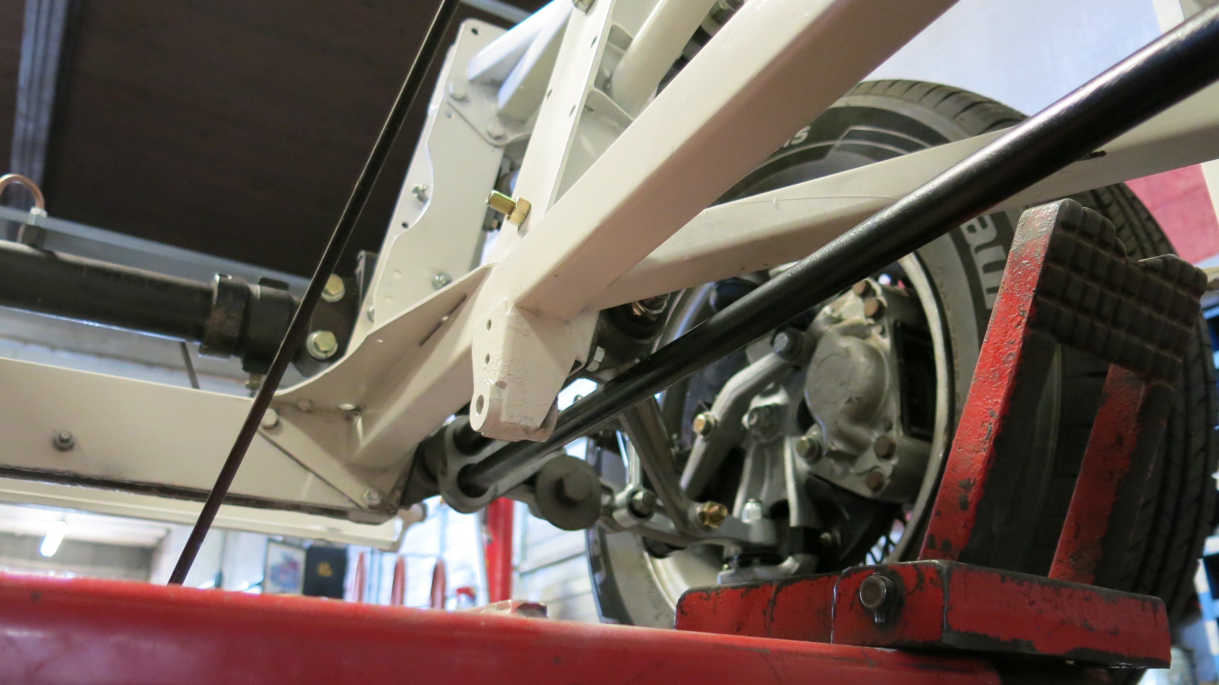

Thanks for the advice about the brake system. Most of the brake system will be have new parts. The brake pipes are almost installed. A rebuild of master cylinder is underway. The front calipers will be a rebuild purchased from Welch. A new brake-booster unit has been ordered.

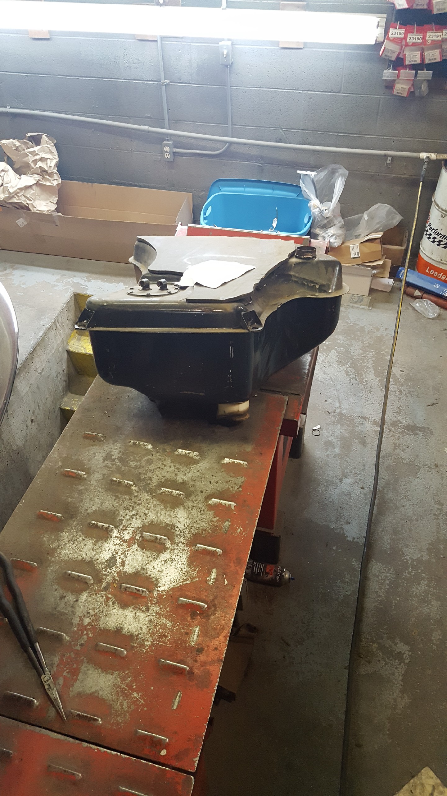

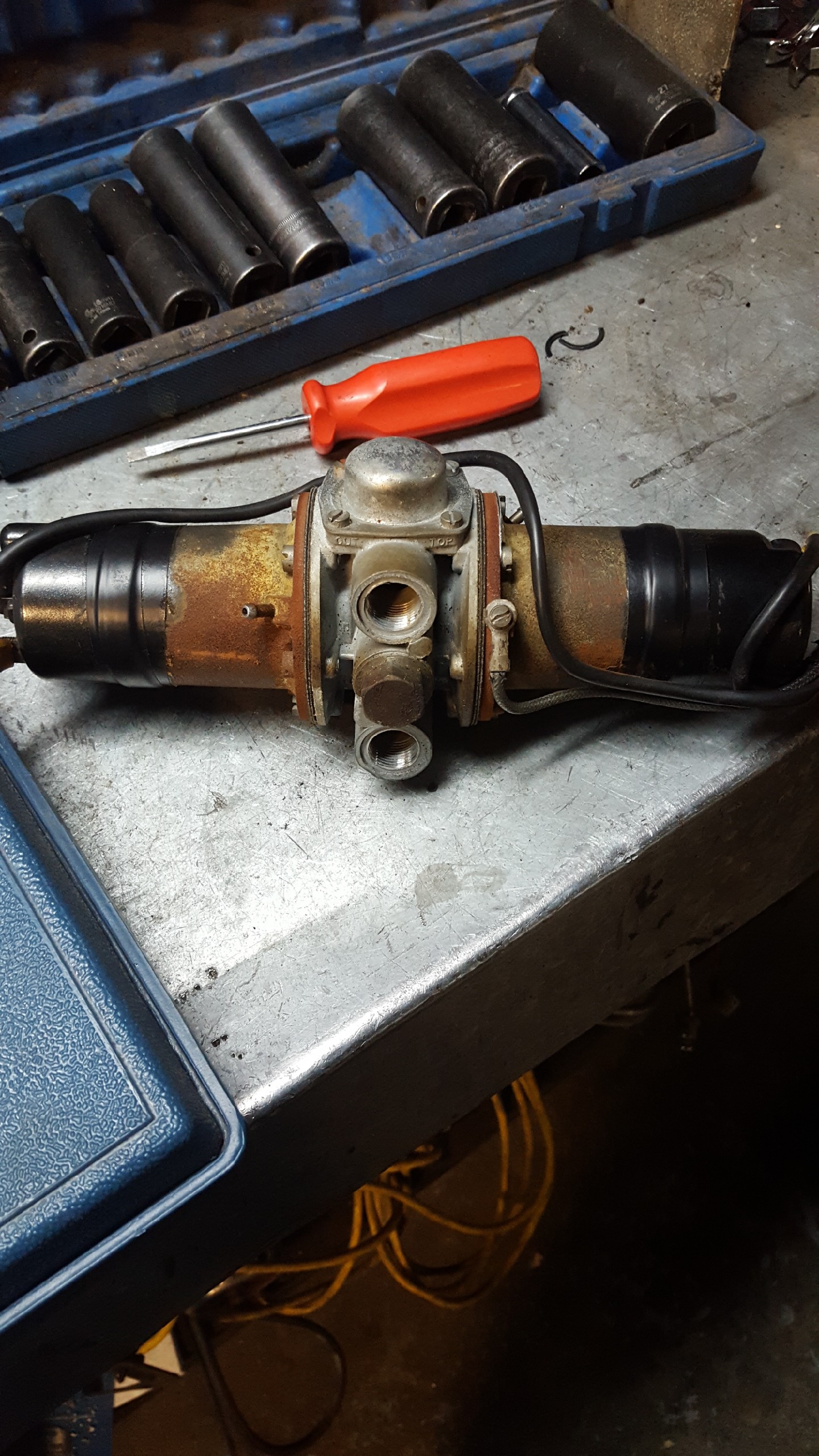

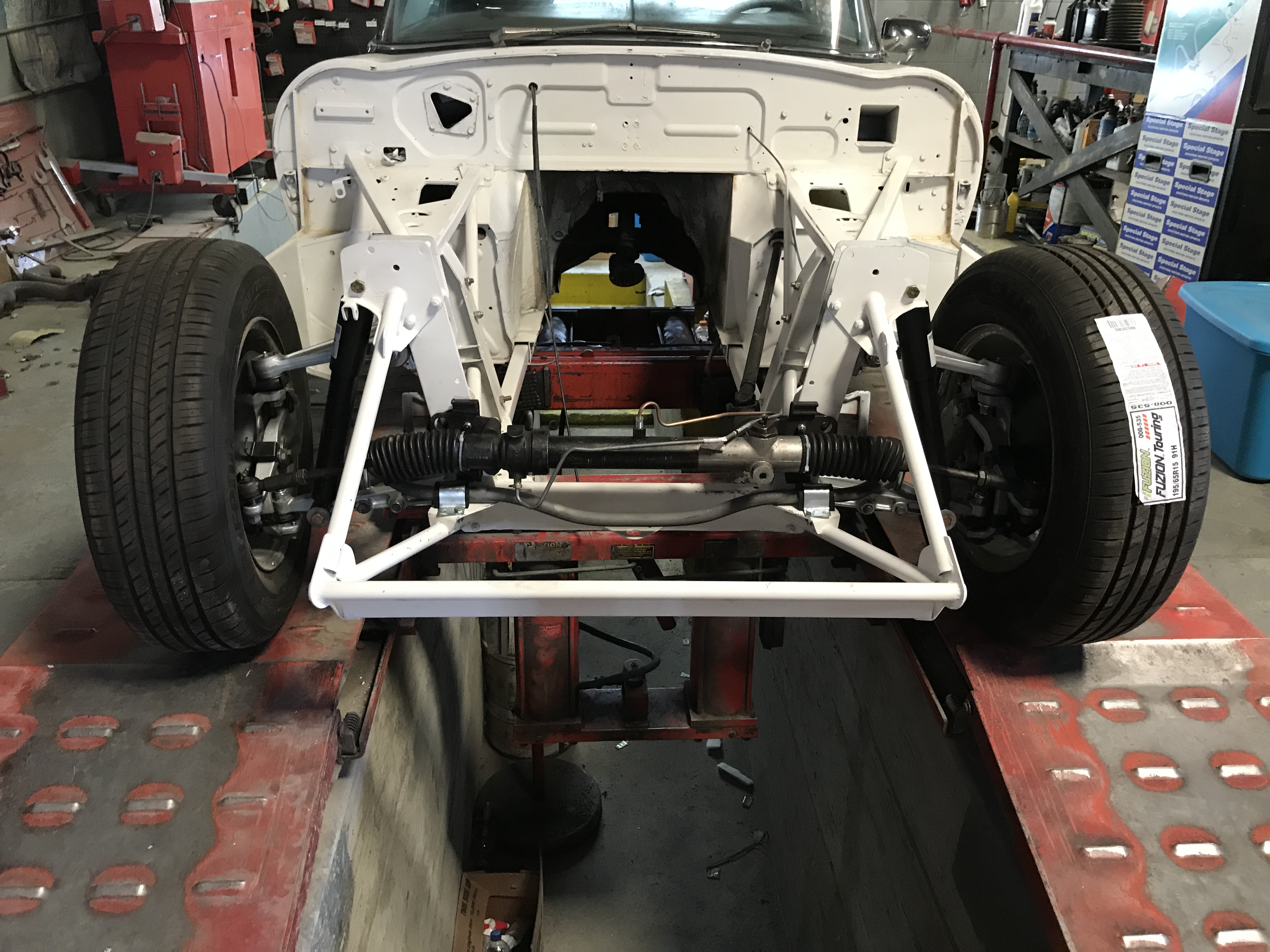

I am not sure if fuel line has been replaced. The gas tank has been removed and cleaned. No rust in trunk floor pan.The fuel uptake screen cleaned. The fuel pump tested. Fuel tank is ready to be installed. The brake pipes have been installed. Front end had rebuilt calipers bilateral. New master and booster cylinder installed. The front suspension is about ready to go. Working on rear suspension at present.
