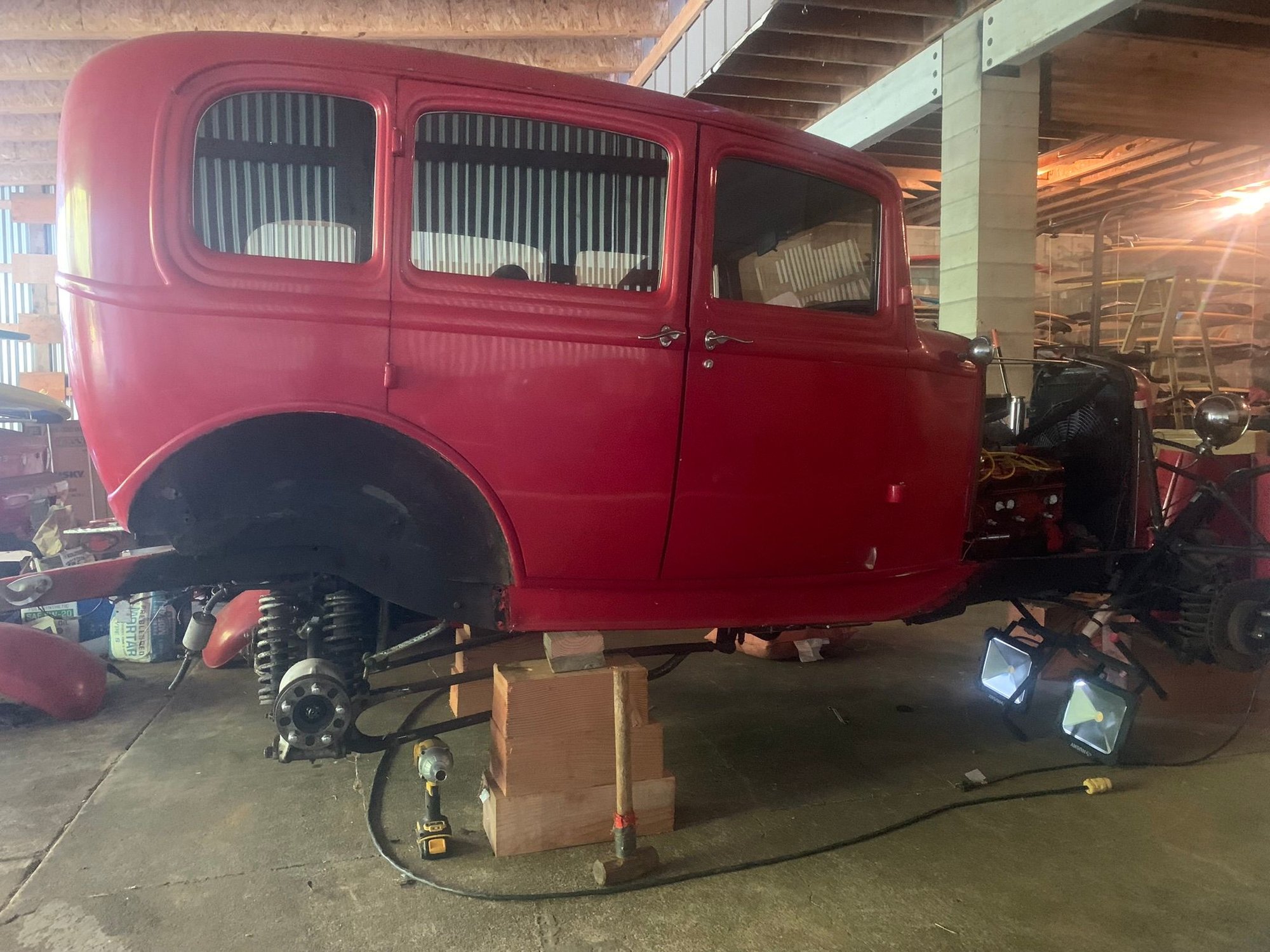

Thanks for your help, I finally filled out my info. It is in a 32 ford fordor built in the seventies. Aloha Doss

1932 ford fordor

i have the rear end out and on the ground. the parts we think are needed:
1. left and right rear hub seals inner and outer
2. left and right rear hub bearings inner and outer
3. two rear brake caliper rebuild kits (Dunlap)
4. rear caliper pads
5. two rear parking brake return springs
6. four coil over rear shocks (not too stiff)
7. lower control arm bushings
8. sway bar links
a list of possible sources would be of great help.
i will respond quickly to comments or questions
Aloha and Thanks, Doss
