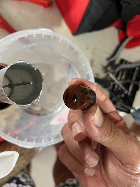

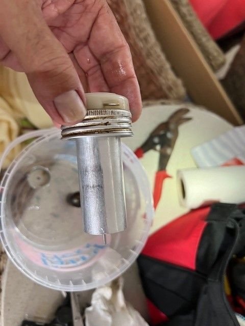

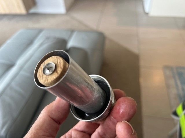

My repair was as follows:
  1. Cut out the bottom of the float unit (which alleviates the need to disassemble the top). I first used small wire cutters and then finally trimmed it off better with small scissors. The aluminium casing is very thin and can easily be trimmed and cleaned up with scissors. I cut around the line where the two holes are already in the side of the unit to allow a good starting point
  2. I gently pried open the claws on the bottom tab of the old float to allow it to slide off the shaft and removed the old float and replaced with a new float from a wine bottle. I trimmed the new cork down to the same length as the old float and reinstalled and it all works well. I considered using something other than cork but did not know if this would react with the brake fluid and as the old cork lasted many years I decided to use cork again
  3. Below are some photos of this work and I hope this helps
