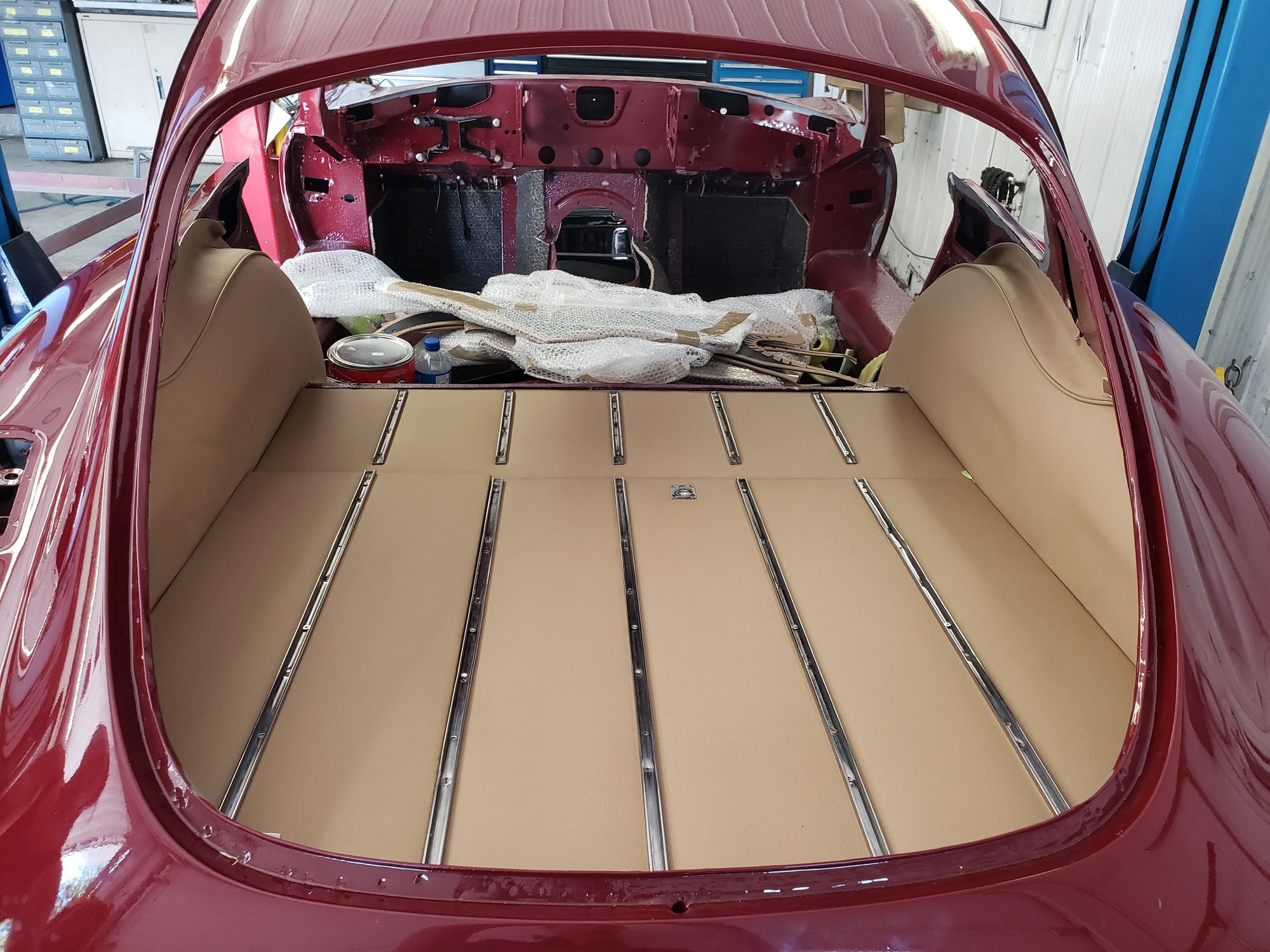

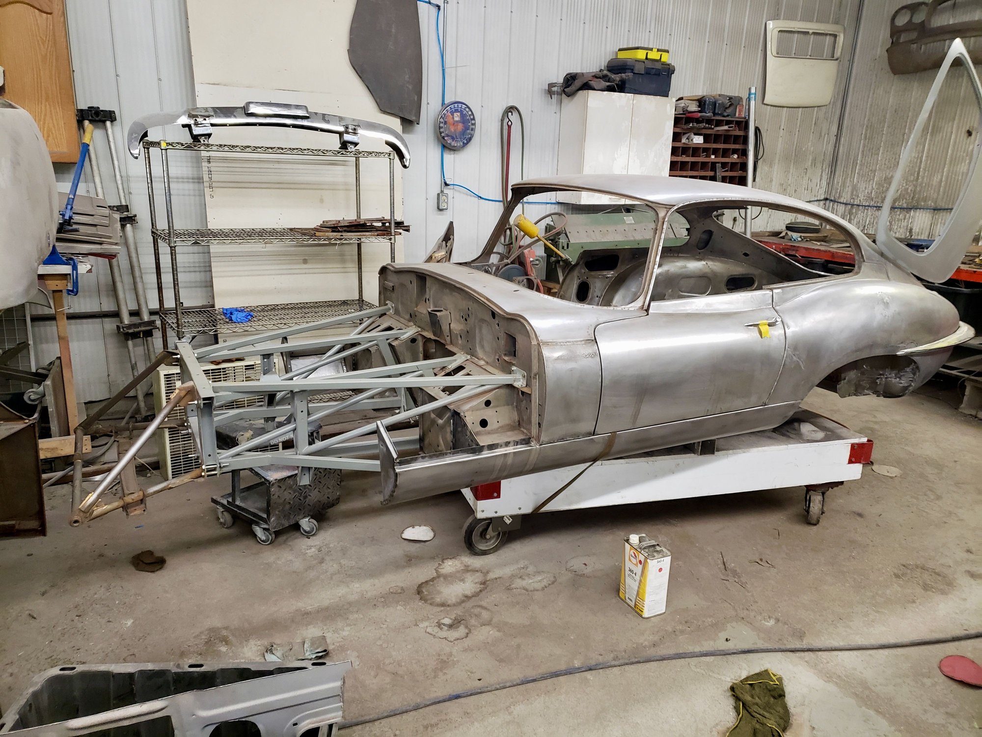

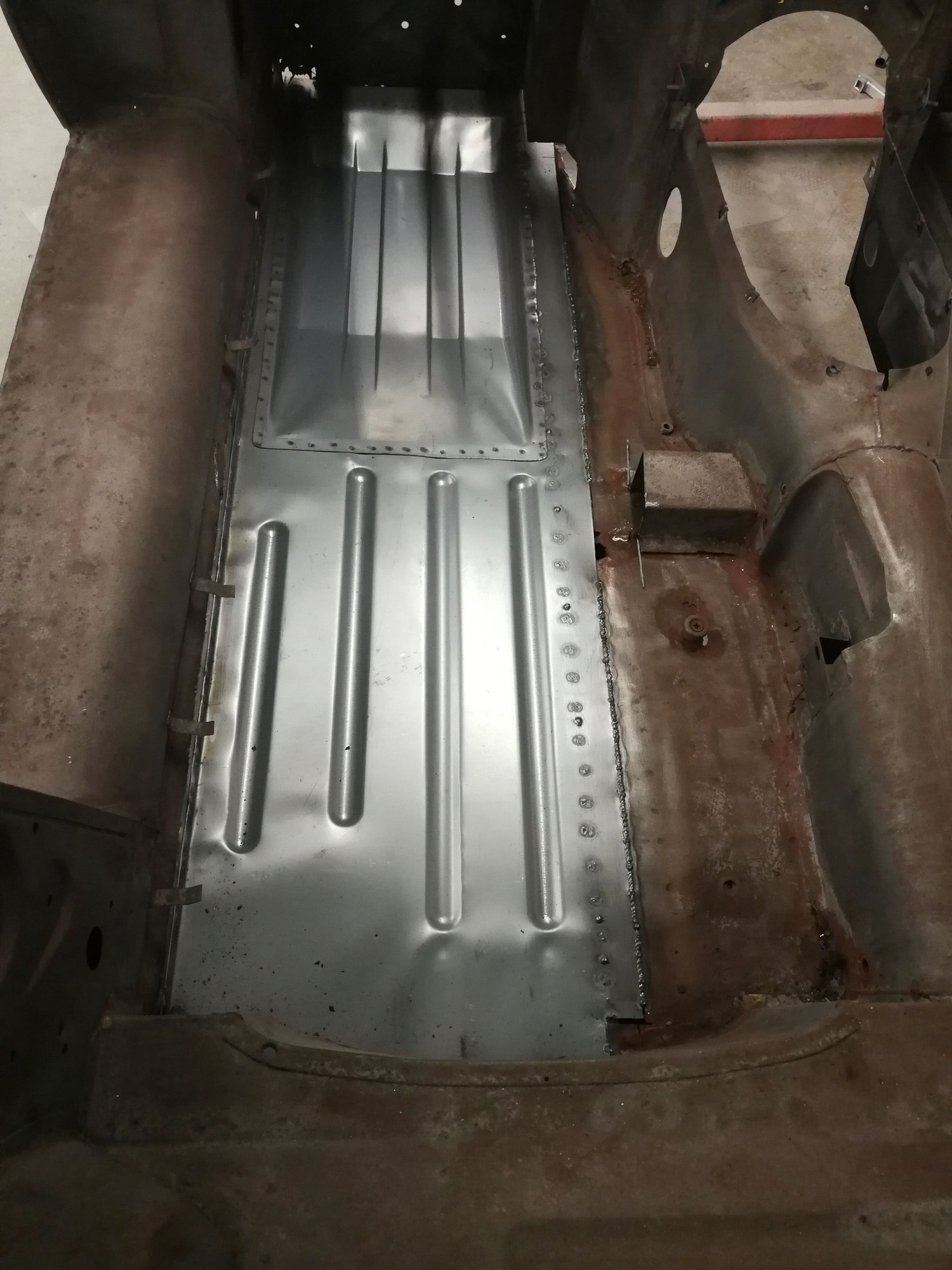

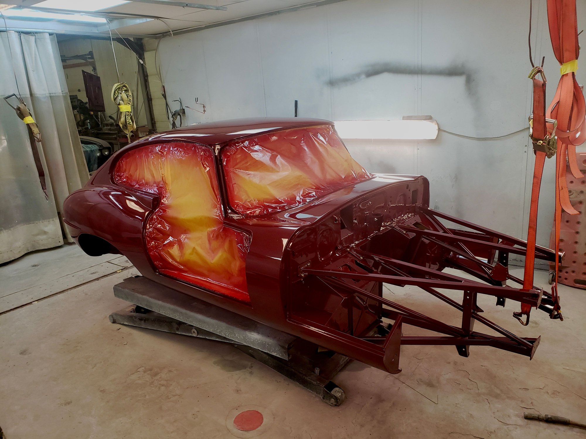

That depends. Below is most of a complete 'repair'. It is nearing the finish line and will be something over 200K in total, but it IS a total restoration.
Prior to restoration
Ready for dipping
New floor in
All the metalwork complete, ready for body work
Completed bodywork, primers, base coats and clearcoats
Suffolk and Turley interior going in
Engine, AC, suspension electrical complete
